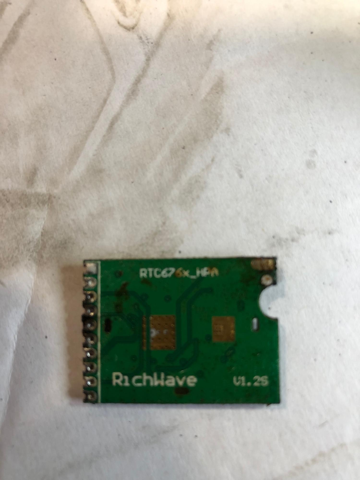

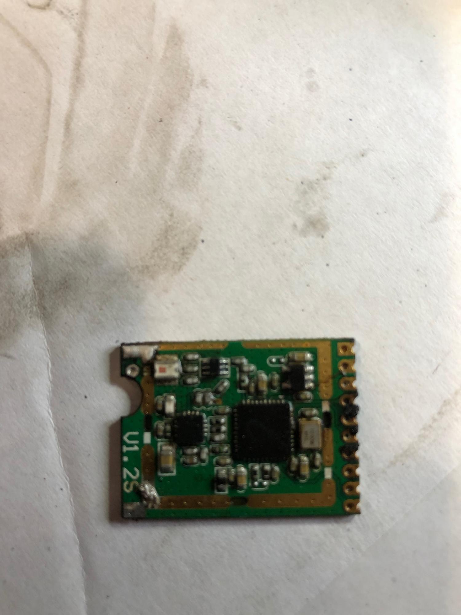

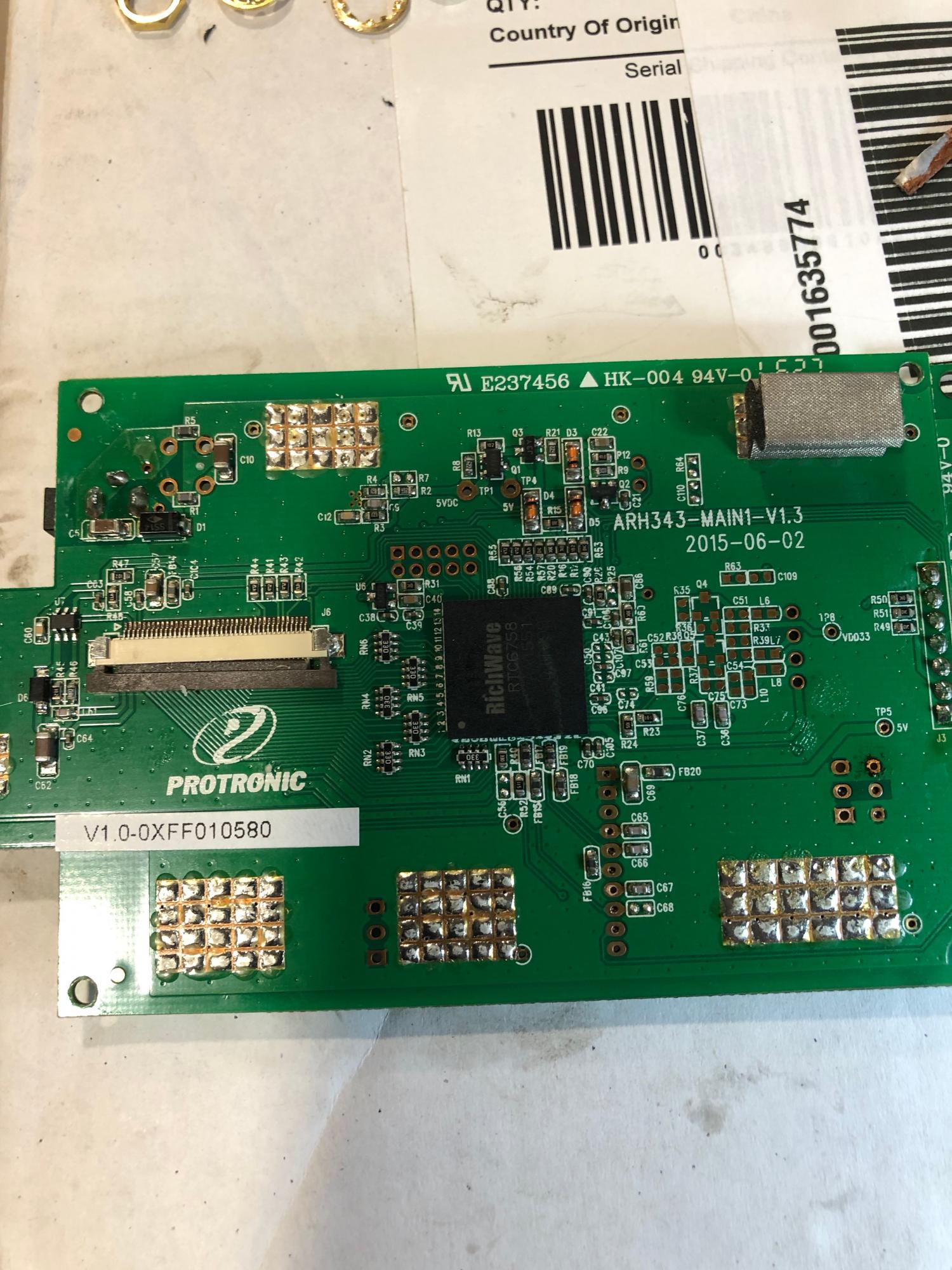

    hello - first post here so sorry if it is in the wrong section.
    im having trouble with a furrion back up camera. i think the Richwave chip is gone because there is no video reception unless the camera and wire are close to each other. when i tested it with the multimeter, both antenna wires seem to be grounding each other out leading me to beleive that is the issue. i pulled the chip from the main board and it seems to be shorting between the two connection points of teh RF antenna wire.
    any idea where i can get a new 2.4GHz ISM Band FH Transceiver chip? here are a couple pics...THANKS!

    Would you be able to post a close up of the chip, including all of its markings? The chip numbers and such are pretty unreadable in the photo's.

      Is it a RTC6763S ?
