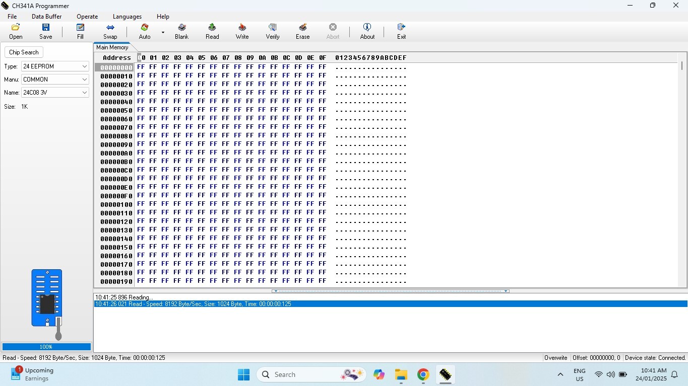

bin file details: prints are already at 8500+. has a ink absorber full error at first bootup but it can be cancelled by long pressing the color or black button and printing can still be done. I am using a refilled ink cartridges.

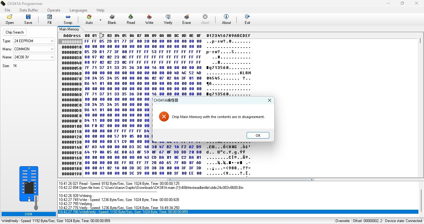

bin file was read using CH341A black. and I was able to successfully re-write on the same IC(because the replacement IC I purchased suddenly did not work).Attached Filesif you find these attachements useful please consider making a small donation to the site
Update: looks like these 408rt have a limit on read and write. backstory I had purchased a new 408rt ic last year. it worked in ch413a programmer a few times then suddenly it cannot be written anymore(it can READ "successfully" though the data field always says FF FF FF FF.... then last night my old working IC was already at 8600 prints so I decided to dismantle and read the IC again(backup the 8600prints bin file) then re-write using the same bin file above(around 8500 prints) so I can deduce from the data field what was the difference. temporarily I had to re assemble the printer using the bin file above. and it worked! unfortunately the black ink was empty at the same time. so I refilled it and test print. it showed 8500 prints again. then after cleaning the black print head, then restarted the printer. it suddenly had the alternate blinking error(power(green) and error(orange) 7 times. google and youtube said it is full ink pad already. but I tried many google and YT videos on resetting this. it CAN be reset. but when it is ready, it cannot be detected by the PC(unknown device on the device and printers page in control panel). tried also reinstalling canon drivers but still same. so decided to dismantle again the main board/IC. and check on CH341A programmer. boom same issue with my other IC. it has no data anymore(broken). I also thought many times that it was my noob hot air soldering that was the issue but it was not. see attached read and write images.This is my bin file for mg2570s with main board QM7-4706.
