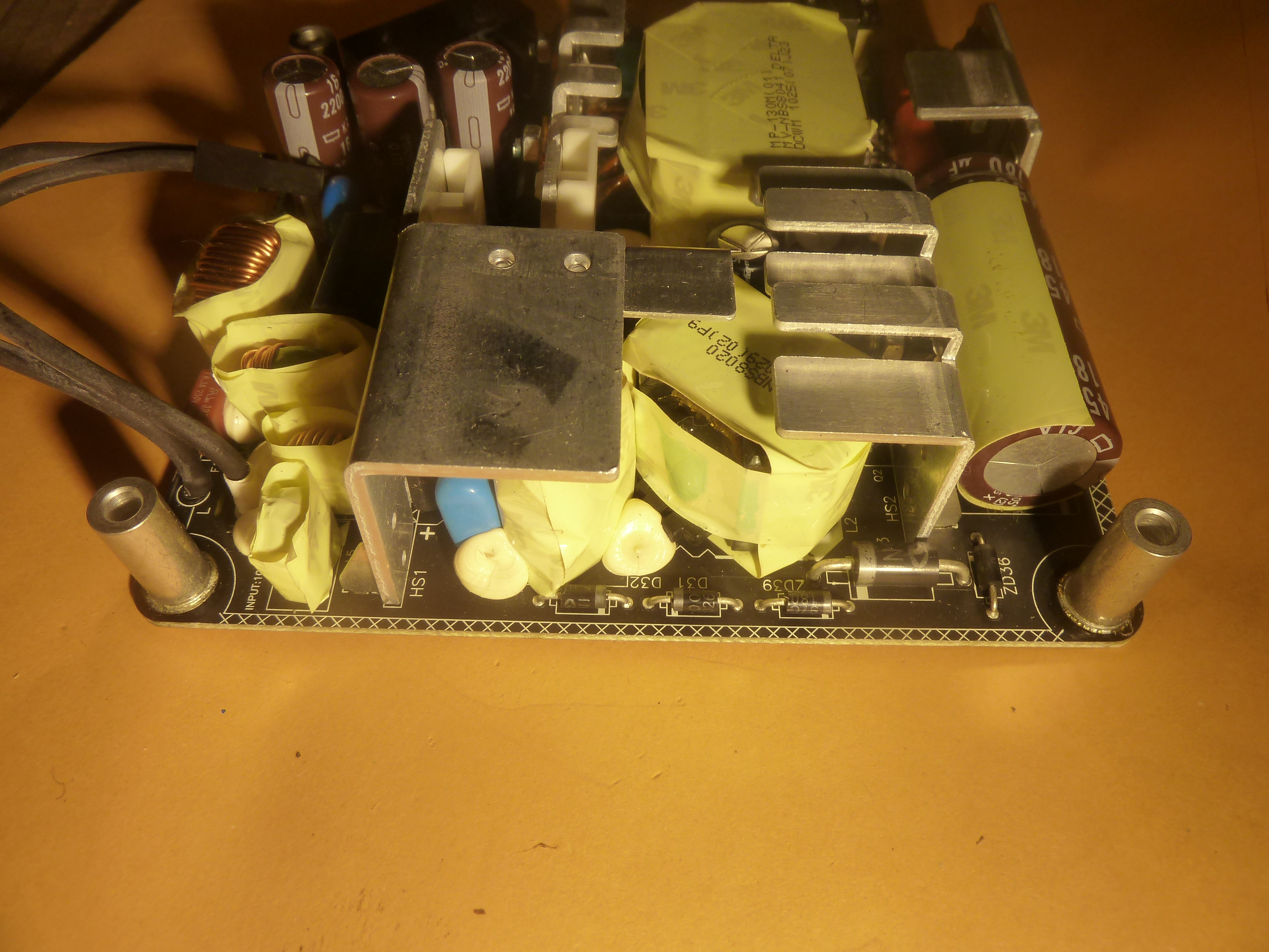

    Hi all.
    I have an ongoing issue with a 2010 A1311 21.5" iMac. It starts up, chimes, lights up and boots to the OS, however the screen starts to lightly flicker, steadily getting worse before switching off altogether. Measuring the voltages reveals that the 12v rail drops to around 10.5v once the Mac is switched on.
    Until yesterday, I wasn't sure if the problem lay with the PSU, the backlight inverter or the logic board.
    Yesterday, however, I borrowed a good PSU and the iMac works fine.
    Hence my opening a new thread within this troublshooting section.
    Searching online, I could find only one other person with this problem, on the iFixit site. He then managed to trace the fault back to a shorted Mosfet on the output of his PSU and resolved the problem.
    This is where I am looking for some advice.
    It seems reasonable to assume considering the identical symptoms and model iMacs that the problem should be similar, or at least related.
    It has become clear to me that I don't have particularly good diagnosis skils when it comes to good or bad mosfets. Mosfets are not something I've much experience with but this is how we learn.
    The fella in iFixit had an easily identifiable short. The PSU here doesn't.
    I have pulled three of the five fets on the board. All three read a mosfets with a Chinese T7 component tester. Two of them switch on and off fine, when using the DMM in diode mode. One doesn't (although it does show as N channel Fet with the T7).
    So my first question is, "which test is more reliable? Whether the Fet turns on and off with a DMM, or the Chinese tester?"
    The Fet in question is a P15N60C3 and Drain/Source either shows 'open circuit' or the reading steadily climbs from just above zero (maybe 20) rising up to the 'OL'
    Datasheet is here;
    https://pdf1.alldatasheet.com/datash...PI15N60C3.html

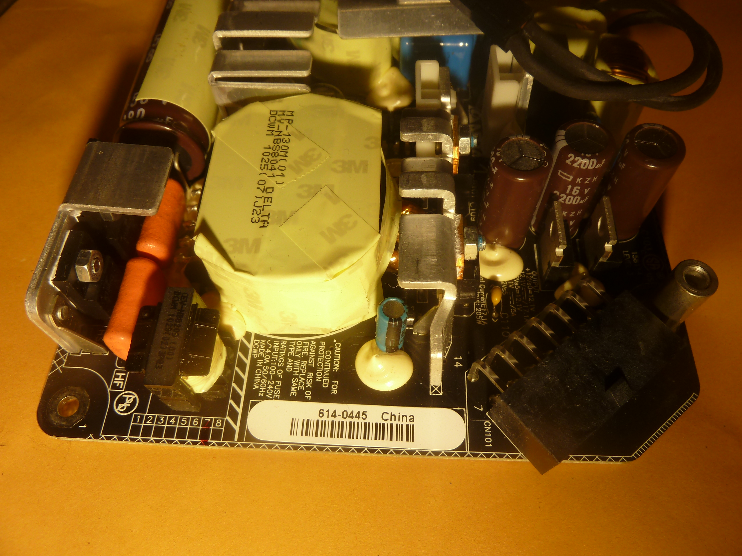

            Re: iMac A1311 PSU repair questions

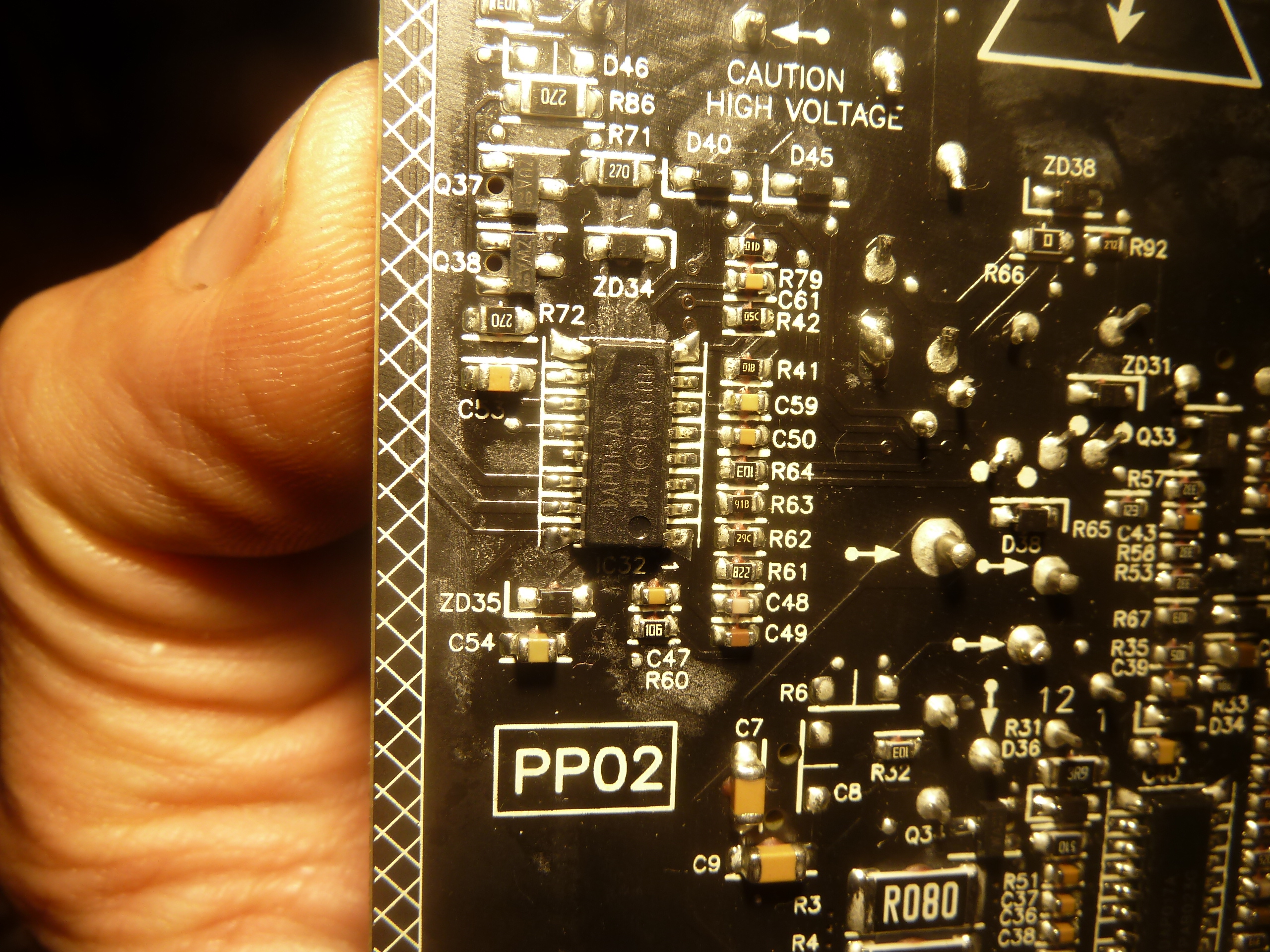

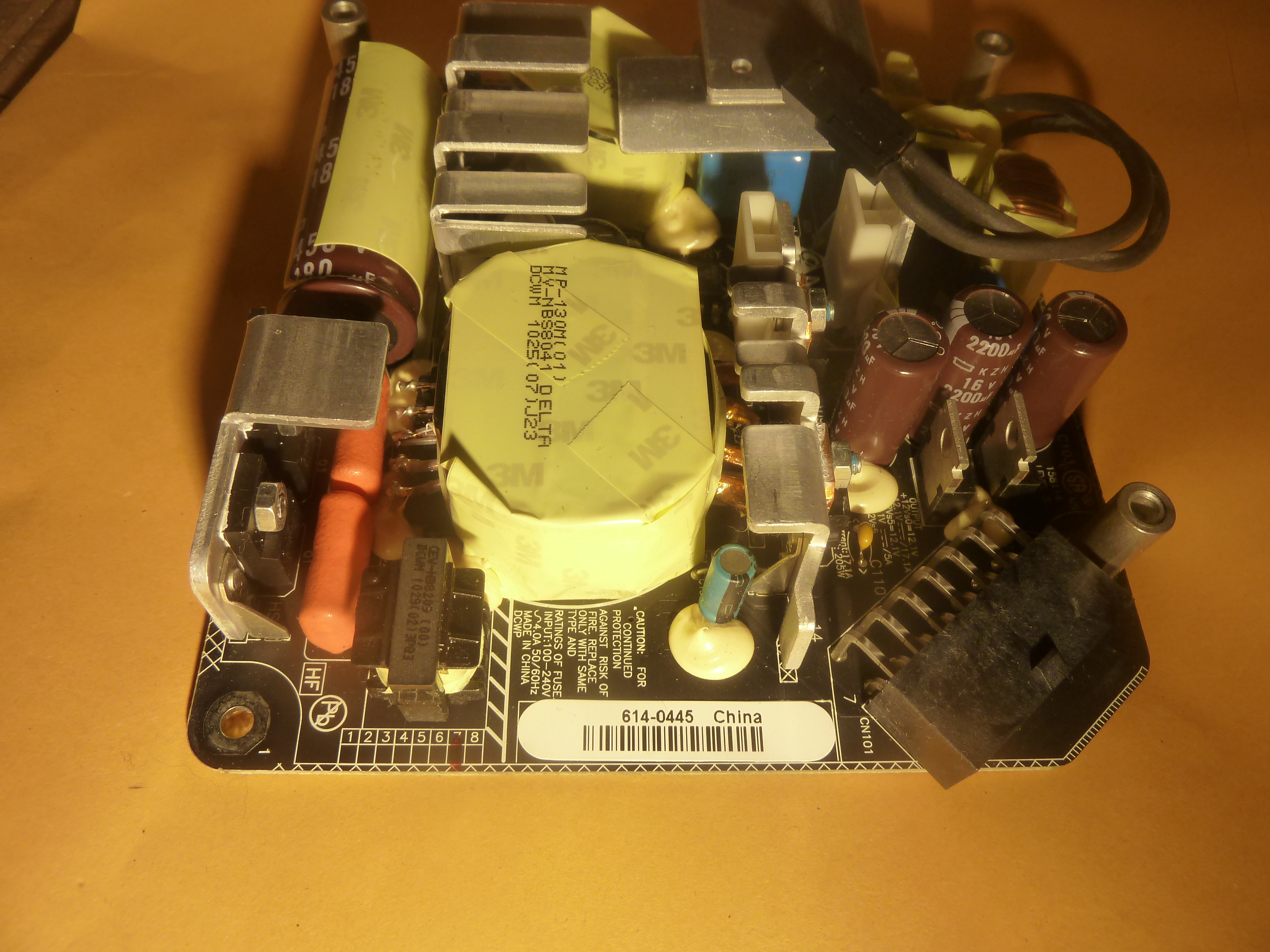

            Hi all.

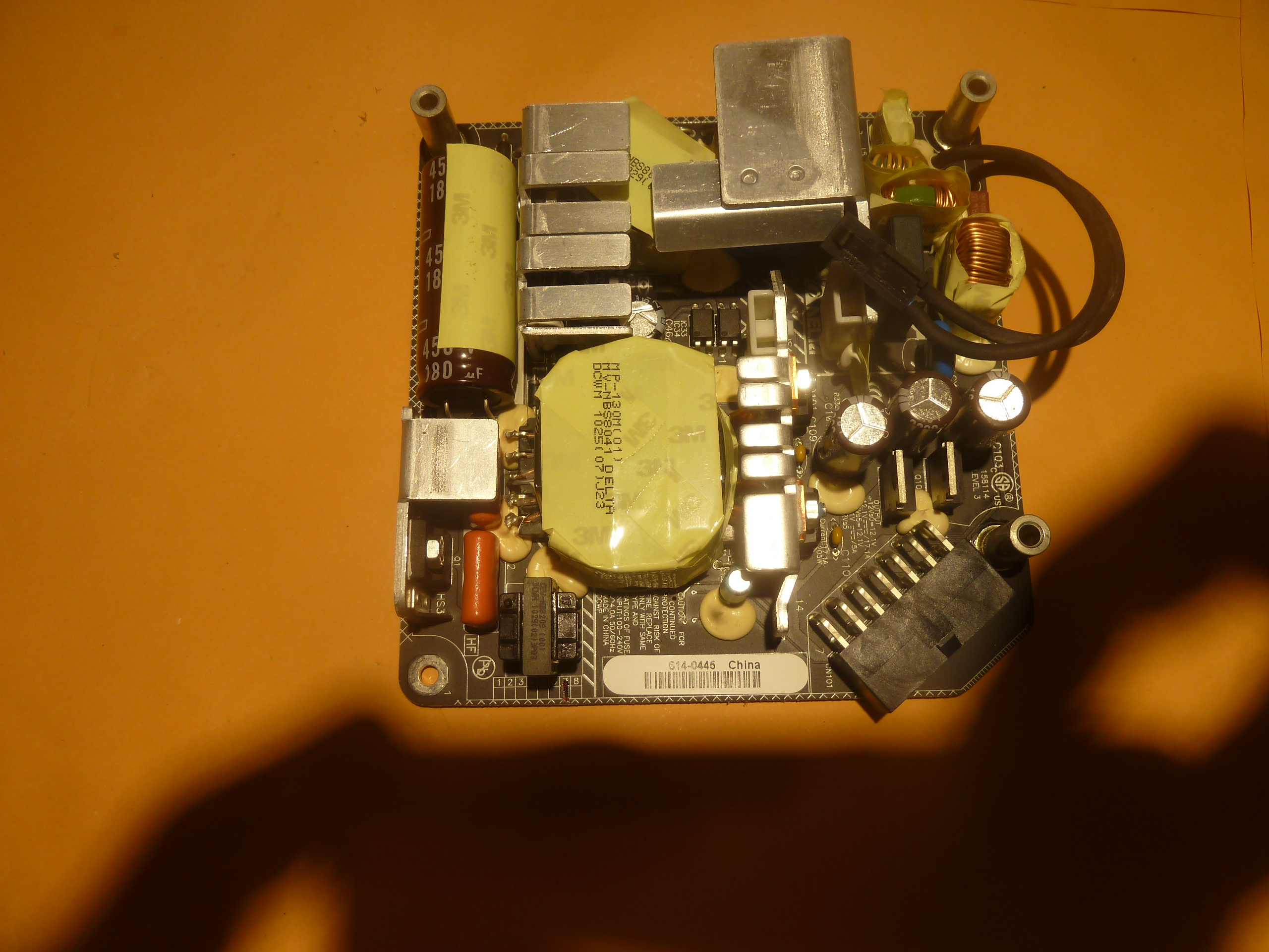

            Rather than start a new thread, I'm just gonna resurrect this one, as now that the iMac is working I was thinking of using the replacement, functioning PSU as a reference to discover which component on the original PSU had failed.
            To recap on the problem...
            The PSU cannot maintain the 12v supply once it is switched on. It remains at around 10.5v, which is insufficient for the backlight inverter board to remain stable, and ultimately to remain 'on'.
            As mentioned, there was one fella on a forum with identical symptoms who resolved the problem by replacing an output FET.
            Feel free to correct me if mistaken, however my understanding of SMPS design is that this kind of problem will be in the secondary side, and most likely in the feedback circuit, which would obviously include Mosfets.
            As it was a while ago now that I last touched this board, I don't recall everything, but I know that I pulled and tested the electrolytics, the two STPS 3045 Schottkys, the two 90T03P N-Channel mosfets on the secondary, and the 15N60C from the primary (just for luck)..
            Haven't touched anything on the SMD side, but can provide photos.
            So, does anyone have any suggestions as to where to look first?
            Edit:

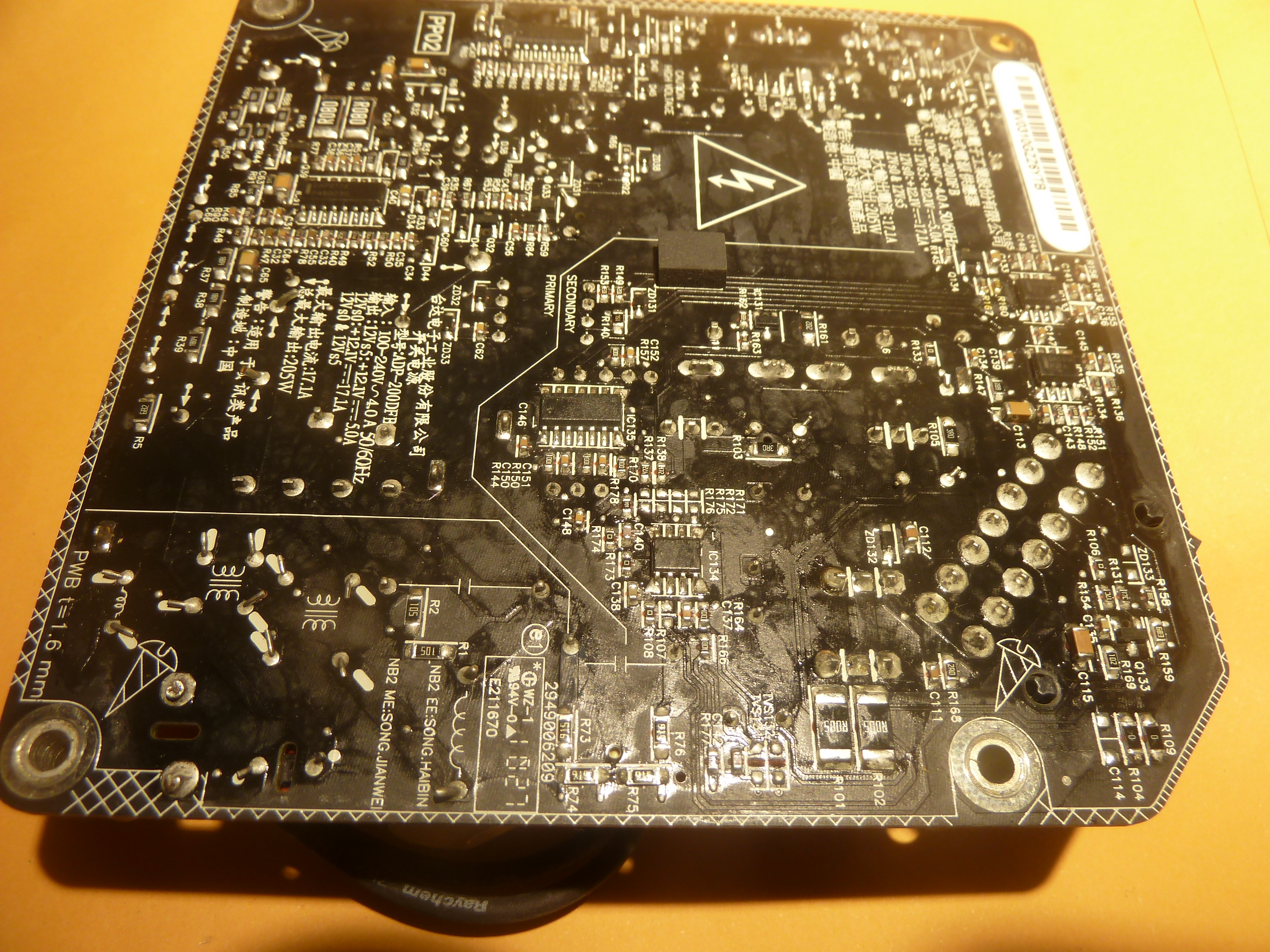

            Comparing the two boards visually, the only clear difference on the top side is that the lettering of one of the 90T30P's is noticeably more faint than the other three (on the two boards), yet without pulling it again, it seems to test the same as the others. I wonder if it only fails under load?
            Looking on the SMD side, it is clear that the 'new' board has also been repaired at some point.

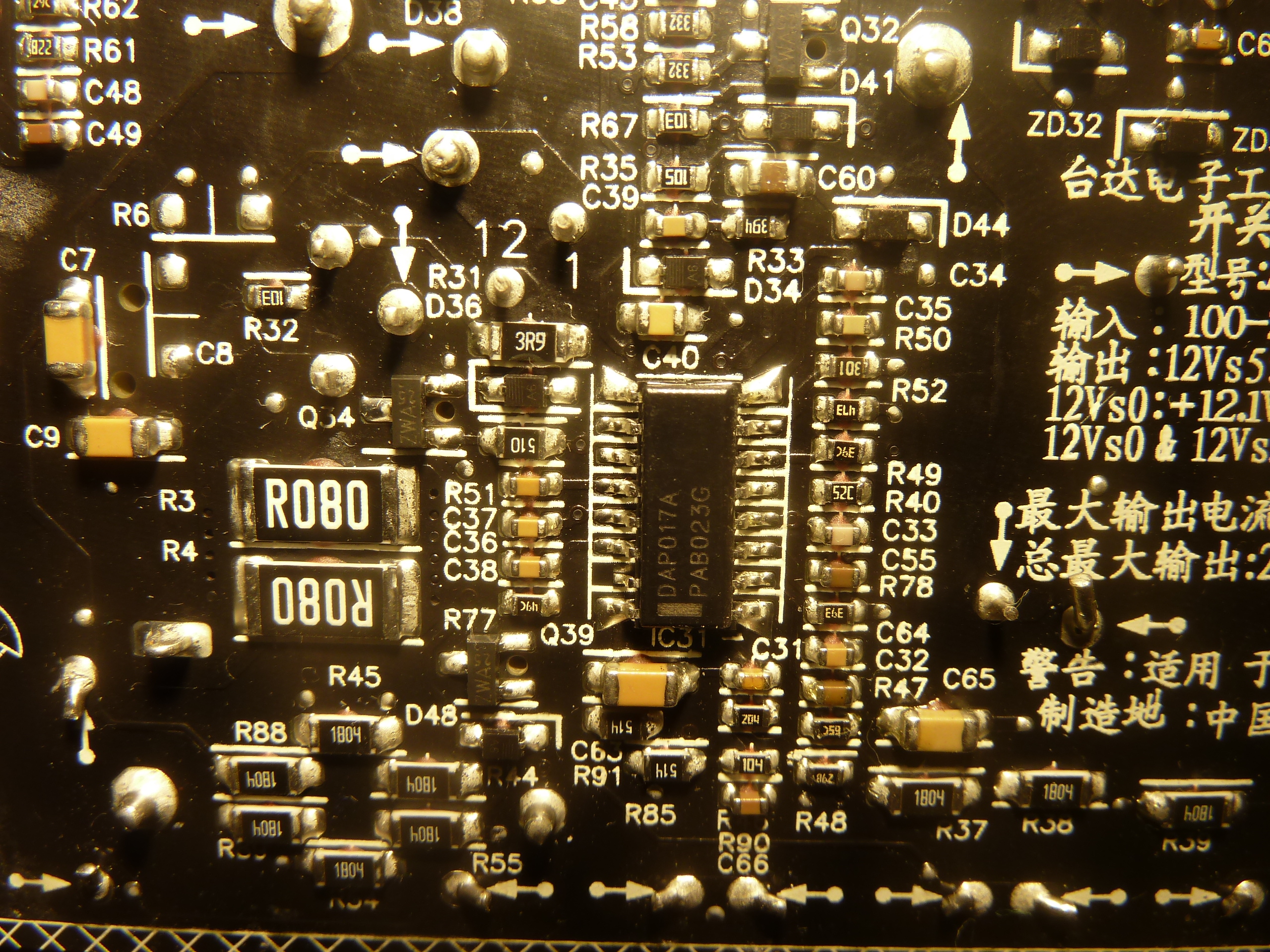

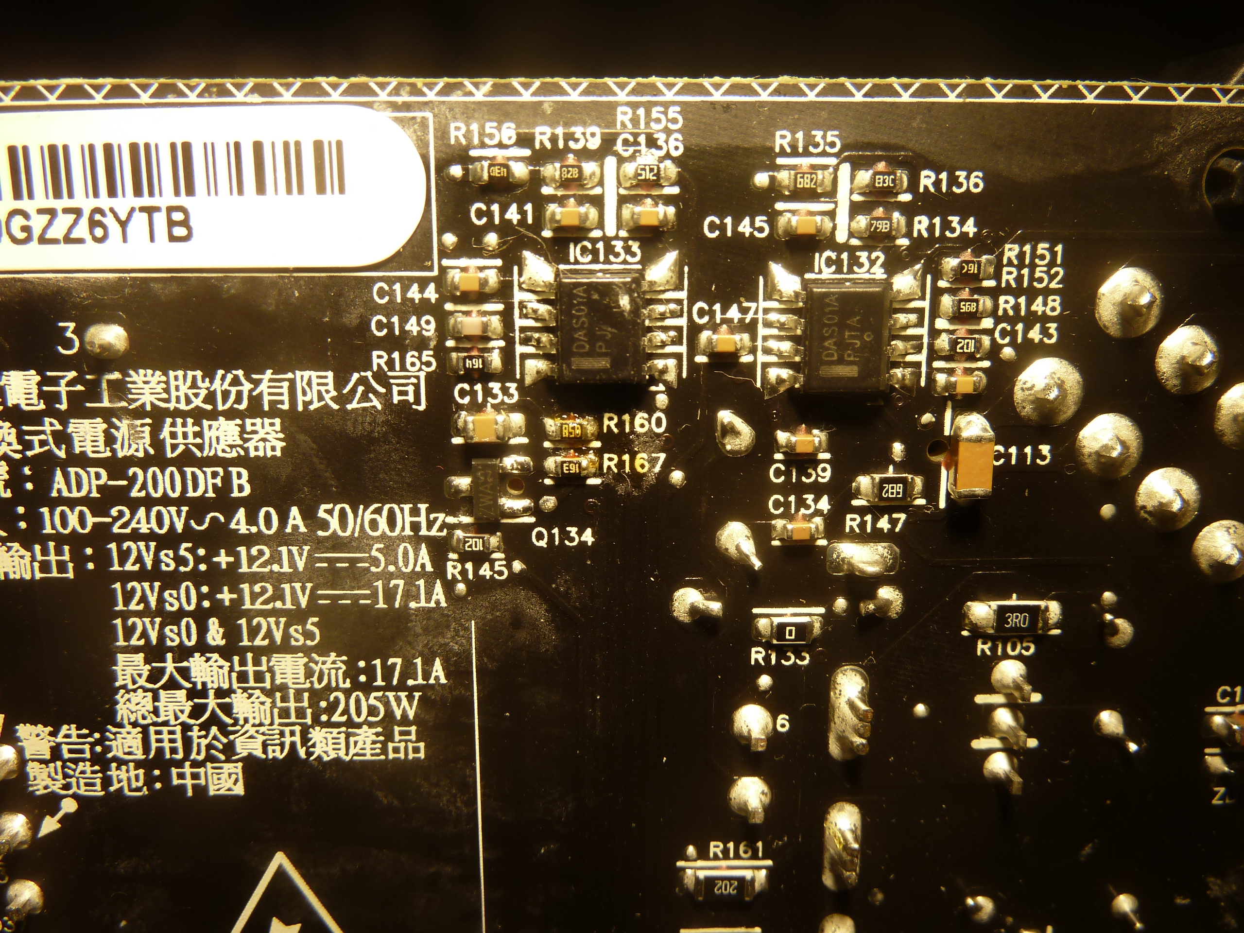

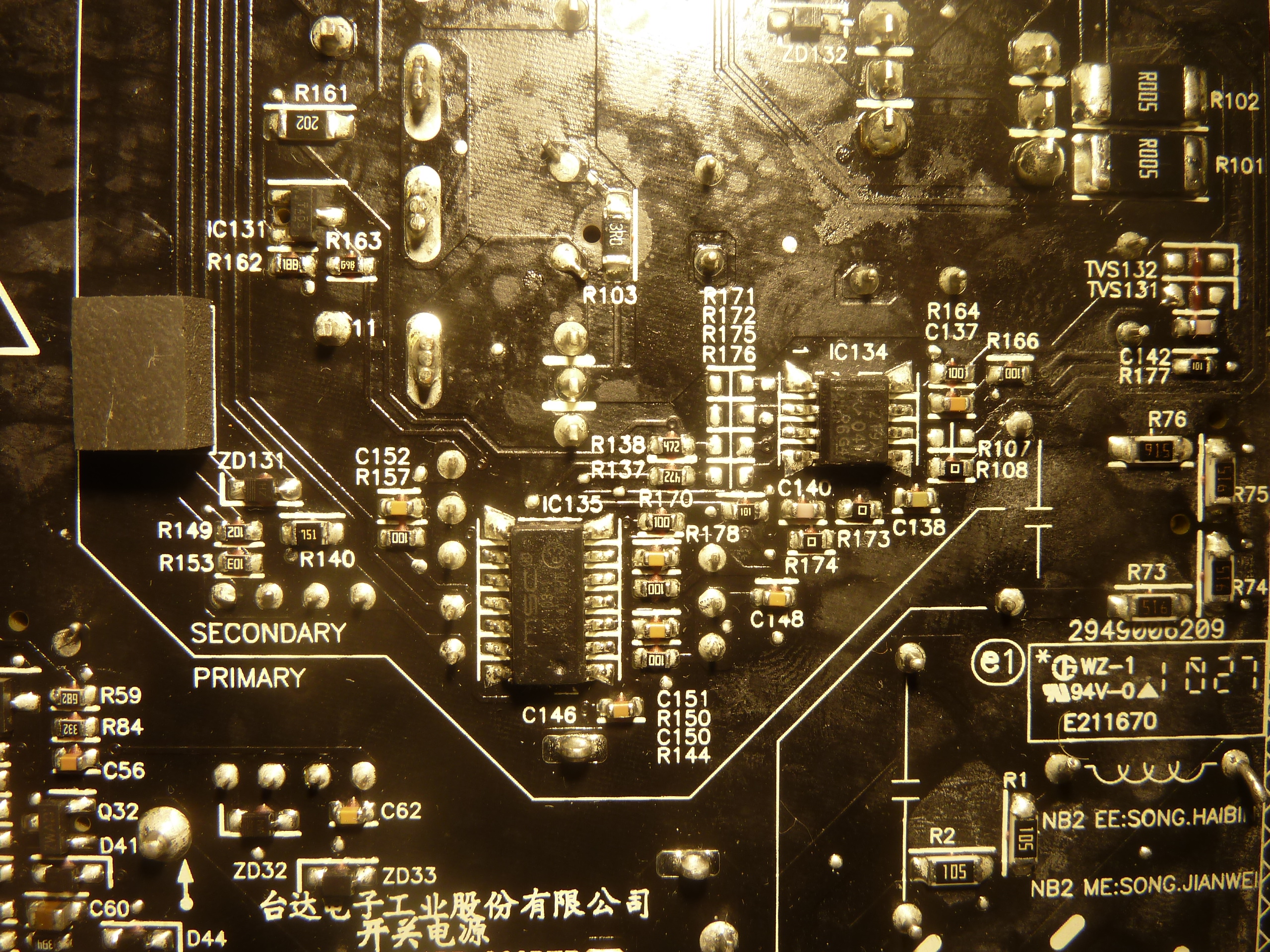

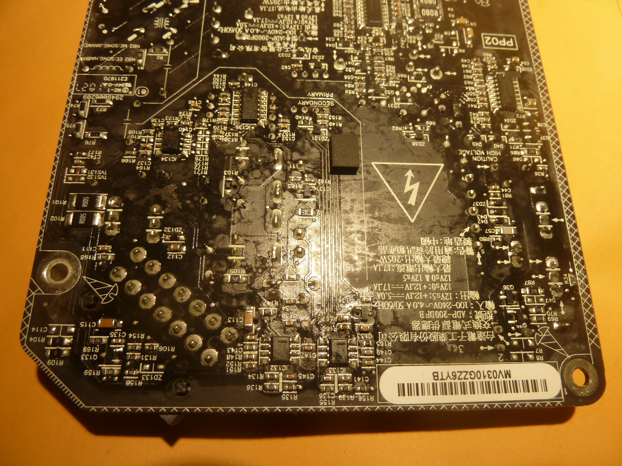

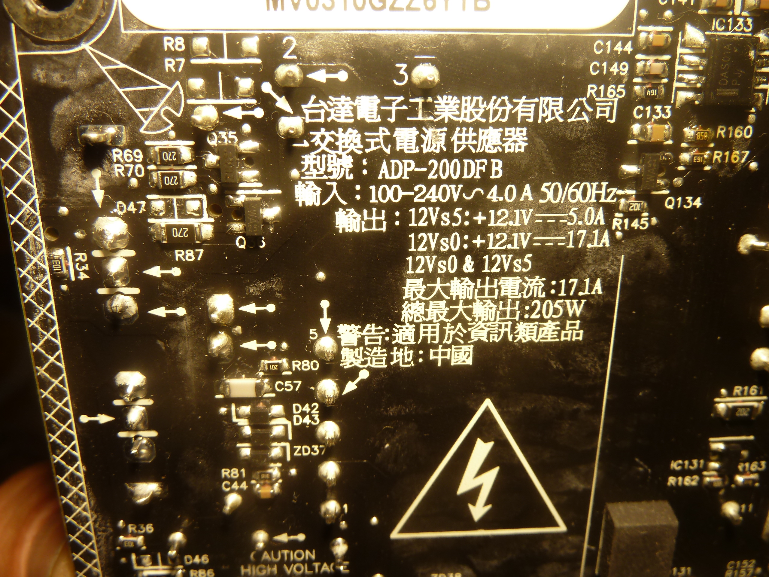

              Here is the SMD side detail

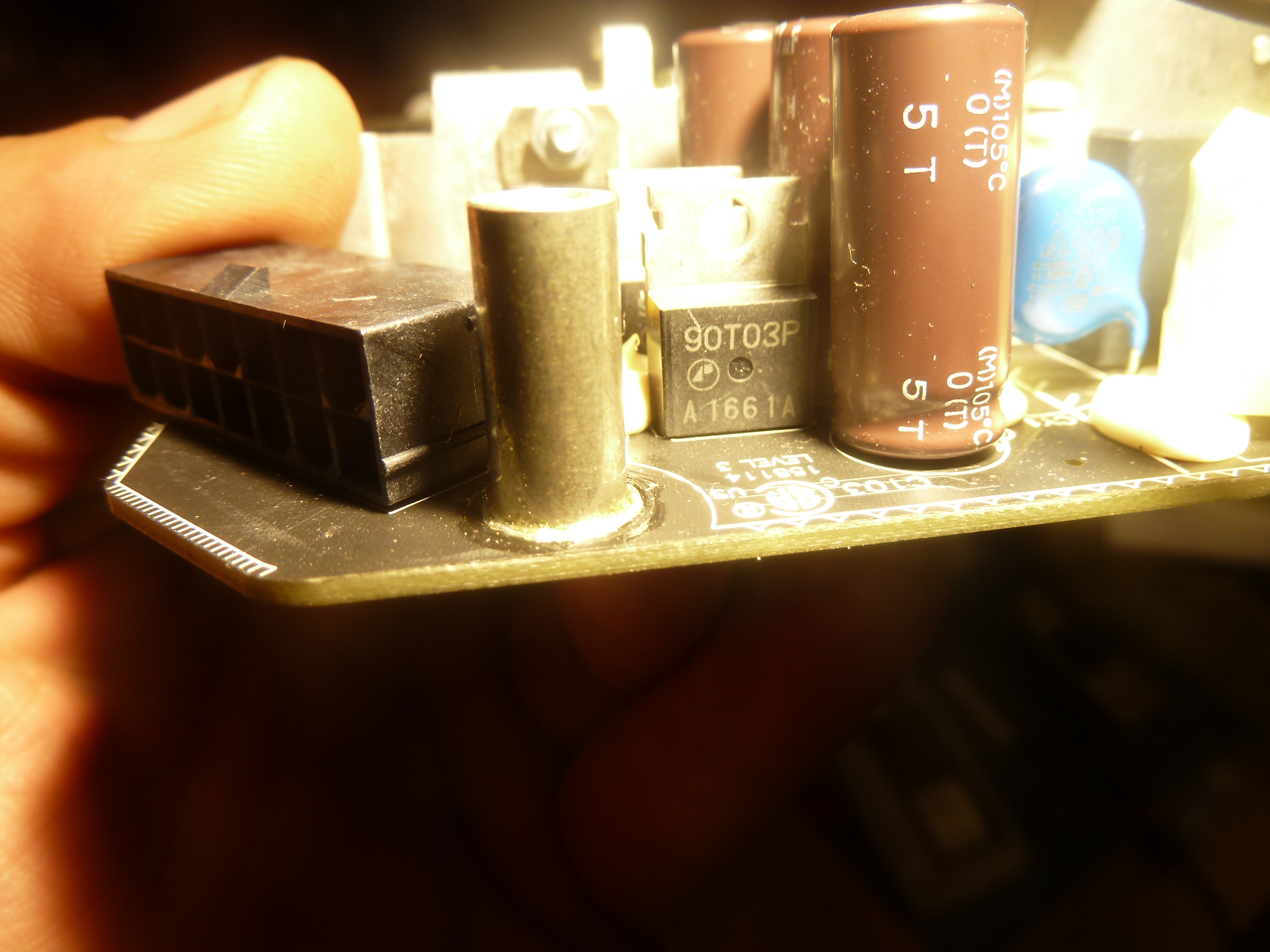

                Gonna swap the Mosfet over from the working supply and see what happens...
                • Crystaleyes
                  • Sep 2021
                  • 495
                  • Brazil

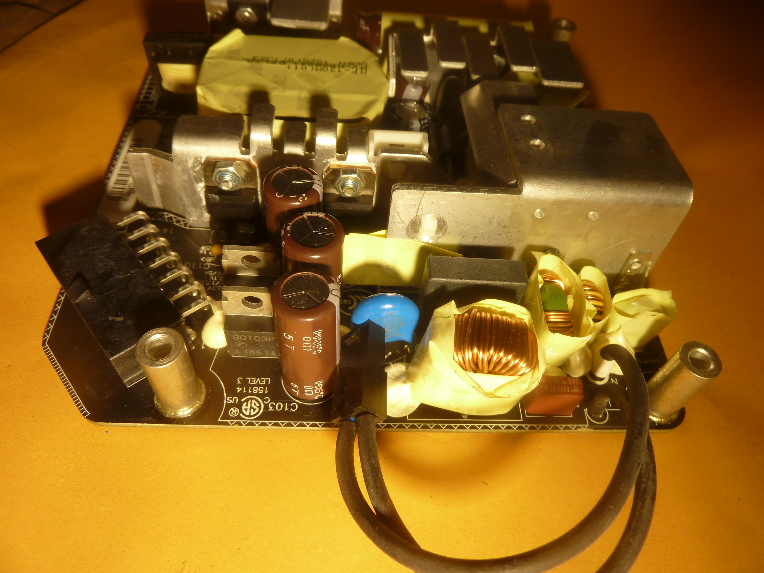

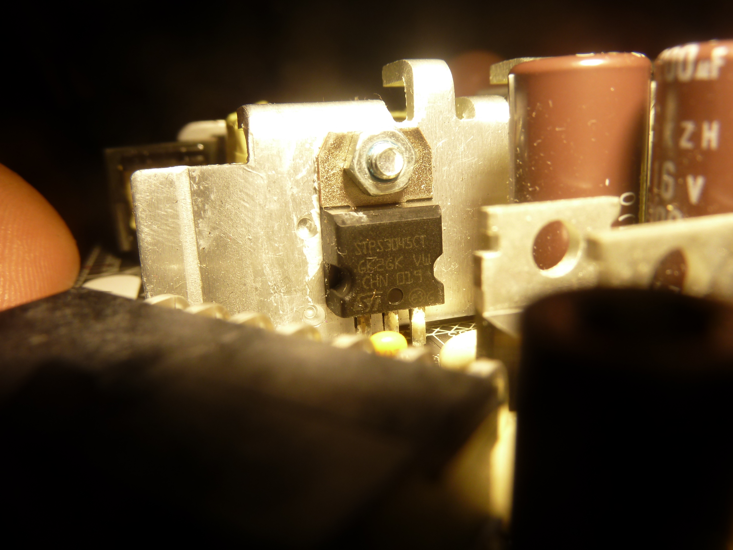

                  Considering the overwhelming interest in this thread (I've honestly done my best to read all the replies and suggestions) it's only right that I keep everyone updated in order that you can all get a good nights sleep....
                  Can't remember who it was who suggested swapping the components but that was that was pure genius. Thank you.
                  So...
                  ::: after swapping the 'forward-most' 90T03P, the broken PSU now works!!
                  Whoopee-fuckin-doo!!
                  Just to fuck with my head however,..
                  The replacement 'good' PSU (from where I took the FET and inserted the 'broken' FET) now also fuckin works!!!!! WTF???!!!???!!!
