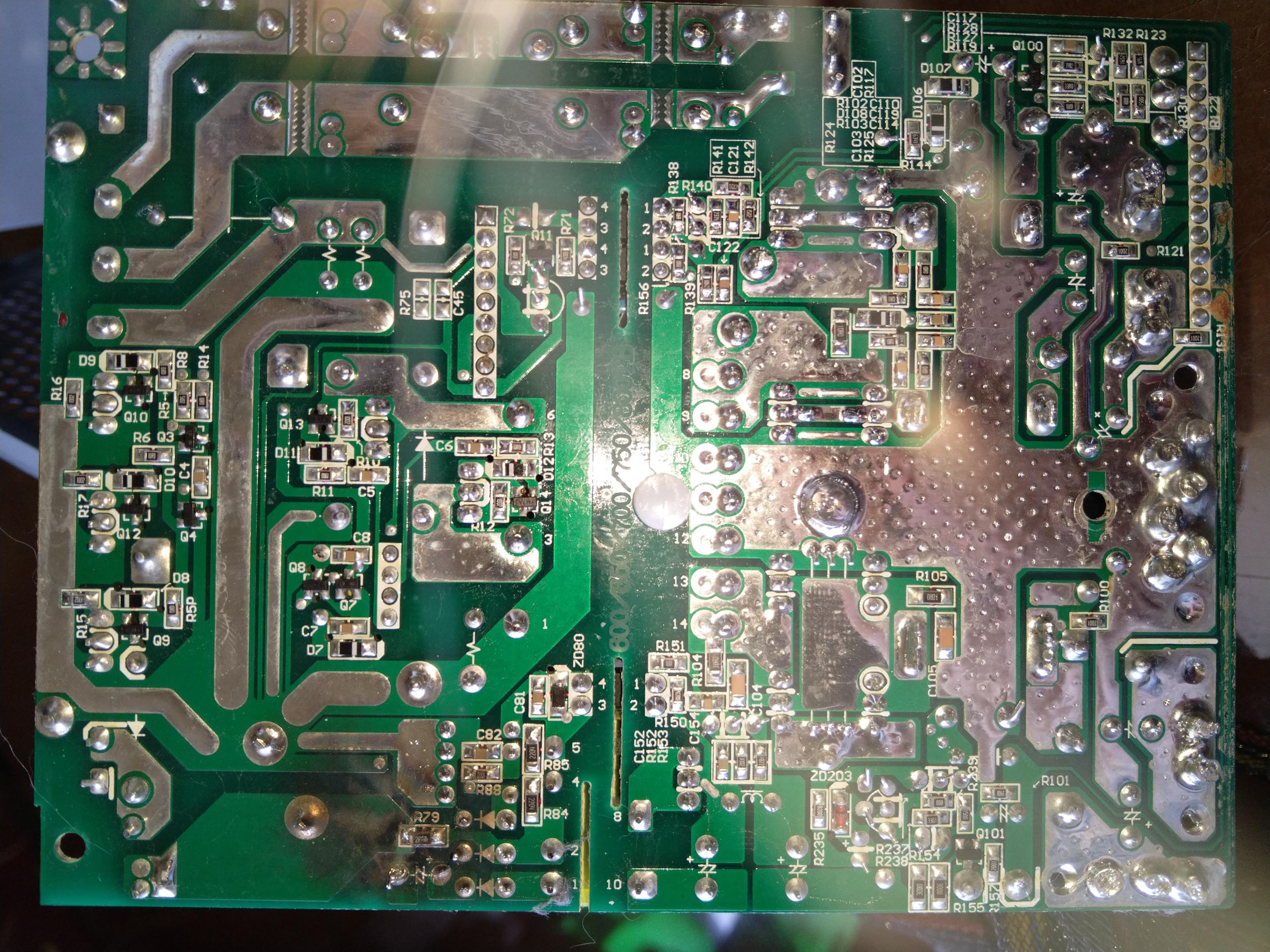

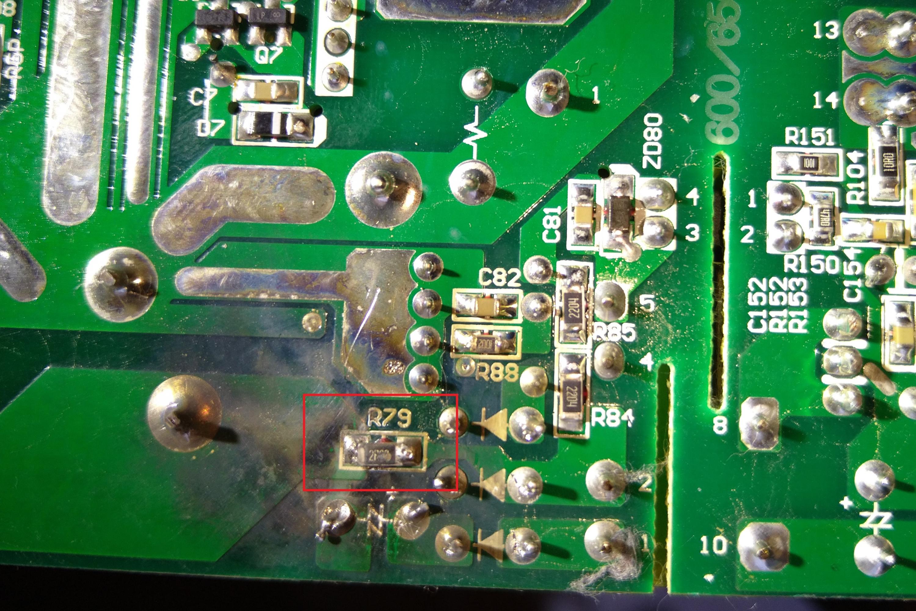

Hello, I have a Fractal Design fd-psu-in2b-750w PSU.
There is burned resistor. Unknown value.
Can you identify it?
CHIP IS TNY280

Looks like 2R00 to me. It can’t be a large value resistor with that large diode in front of it.

I tried 2Ohm resistor and PSU started, and all voltages are OK.

Sure, but why datasheet specifies 1K? 1K burns in flames like on other PSU with same chip.

I think they limit the current and at the same time it acts as a fuse.
