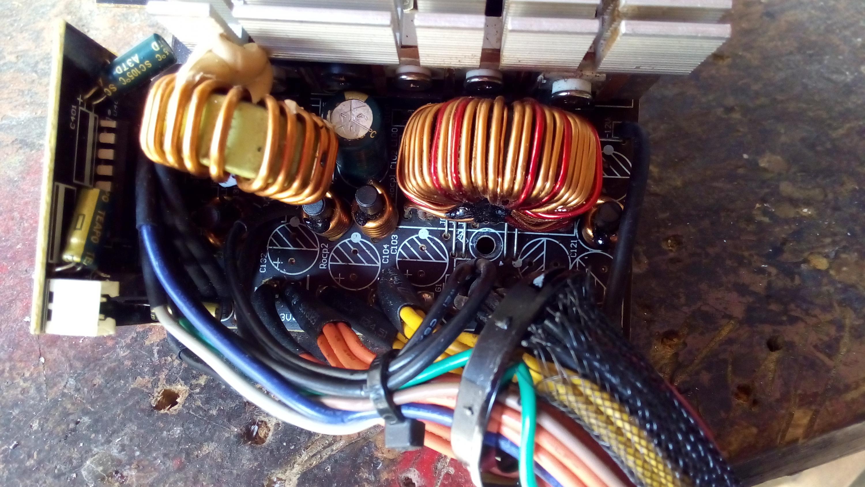

    Good day to all after 2 years this psu, died, i don`t think it´s worth fixing it , since i have lot´s of time to kill, i gave it a go,i`m just an amateur it turned out blown fuse, traced the reason bad mosfet not blowing fuses now, here´s my problem i removed the secondary capacitors, for testing, marked the position of each cap, on a piece of paper, lost the paper, can someone help me, where each cap goes, corsair vs500

    Orange and red wires are 3.3 and 5v, there you will use 6.3 or 10V caps. Yellow wires are 12v, and there you put 16V caps.
      so simple thanks
