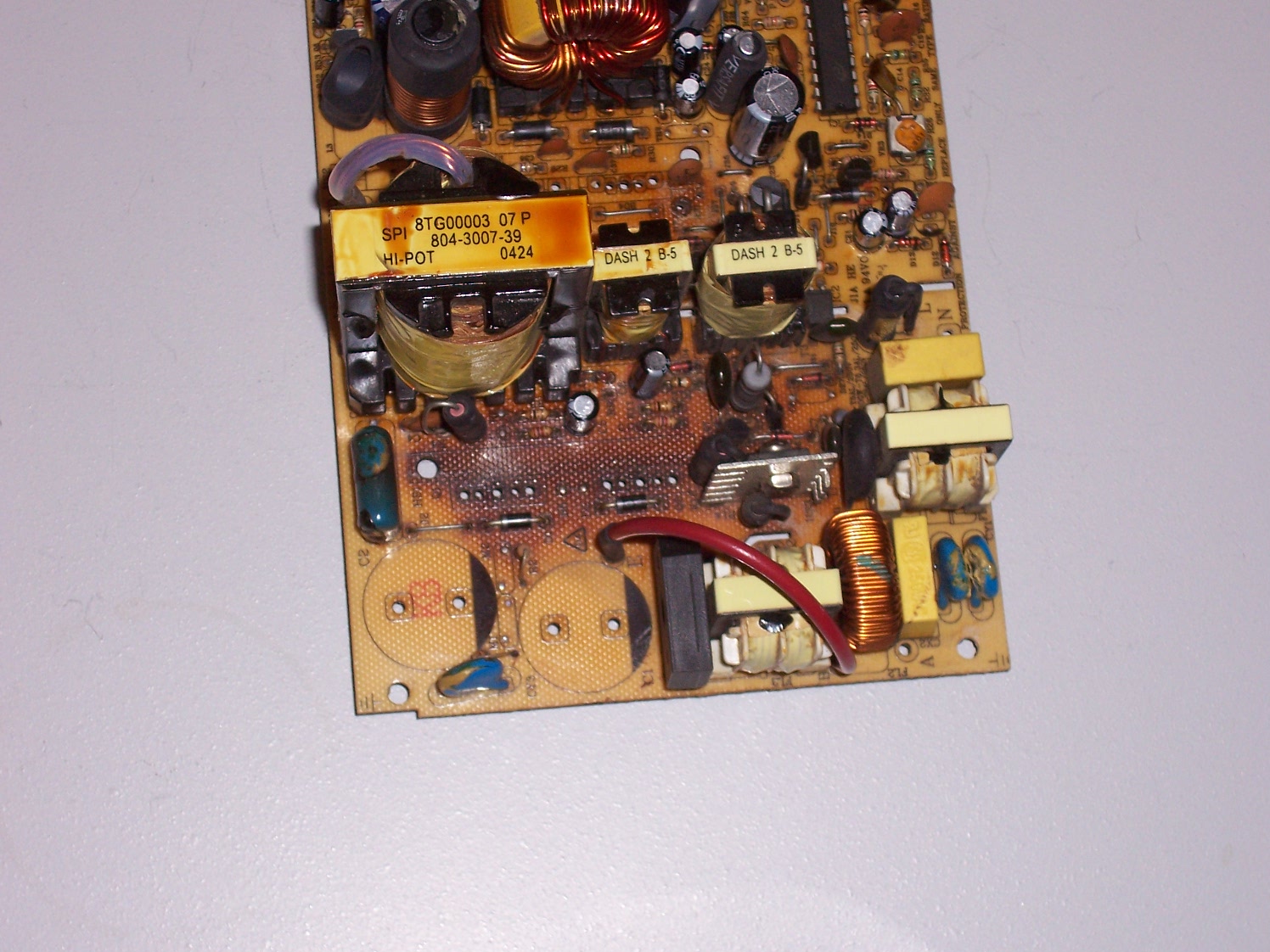

      R31 the larger resistor is 27 ohms (red,violet, black, gold)
      I could not locate R68. On my pc board your arrow points to R62 which is 51 ohms (green,brown,black,gold). Check again and see if the resistor is R68 or R62.

                I have FSP350-60PN which stopped working after long time of no using it at all.
                Several condensators were broken. One was totally dead even it wasn't pulled out at all.
                There was also one resistor which looked like it had been little too warm, but i think it was R32 not R31. It was 7,9 Ohms and what was left of the colors, we decided it was 15 ohm resistor.
                I decided to write this down here even its an old thread if someone someday needs the info

                        Just obtained a Power Q ATX-350GU. Looking inside, the pc board was identical to the Fortron FSP300-60ATV. Next, I determined that the fan was stuck.....totally stuck. Pictures show that there is some heat damage, A few bulging capacitors were changed before making the pictures. I decided it would be worthwhile to look at the esr of all of the capacitors to determine what damage a stuck fan does to all of the capacitors, including the ones that "looked" OK. So here is what I found.
                        C25 Teapo 3300uF/16V Bulging esr=17 12 volt output
                        C23 Teapo 1000uF/10V Bulging esr>99 5vsb pi input
                        C26 Teapo 1000uF/10V Bulging esr=4.5 5vsb pi output
                        C29 OST 3300uF/10V not bulging esr=.02 5 volt pi input
                        C28 OST 3300uF/10V not bulging esr=.02 5 volt pi output
                        C33 Teapo 1000uF/10V bulging esr=8.1 3.3 volt pi input
                        C34 Teapo 2200uF/10V bulging esr=5.6 3.3 volt pi output
                        C5 Teapo 1uF/50V not bulging esr>99 cap=500nF between driver and main switching transistor
                        C6 Teapo 1 uF/50V not bulging esr>99 cap=625nF between driver and other main switching transistor
                        C30 Jamicon 220uF/16V not bulging esr=4.6
                        C31 Jamicon 220uF/16V not bulging esr=.64
                        C21 Teapo 1uF/50V not bulging esr=6.1
                        C12 OST 4.7uF/50V not bulging esr=9.6
                        C20 Teapo 22uF/50V not bulging esr=6.7
                        C24 Teapo 10uF/50V not bulging esr=11
                        C22 Teapo 10uF/50V not bulging esr=18
                        C17 Teapo 2.2uF/50V not bulging esr=9.2
                        As a result of all these "non bulging" small capacitors with high esr, I decided to go ahead and replace ALL of the capacitors on this board. My conclusion: stuck fan plus some obvious heat damage on the pc board means all capacitors probably have high esr.....to high for comfort!
