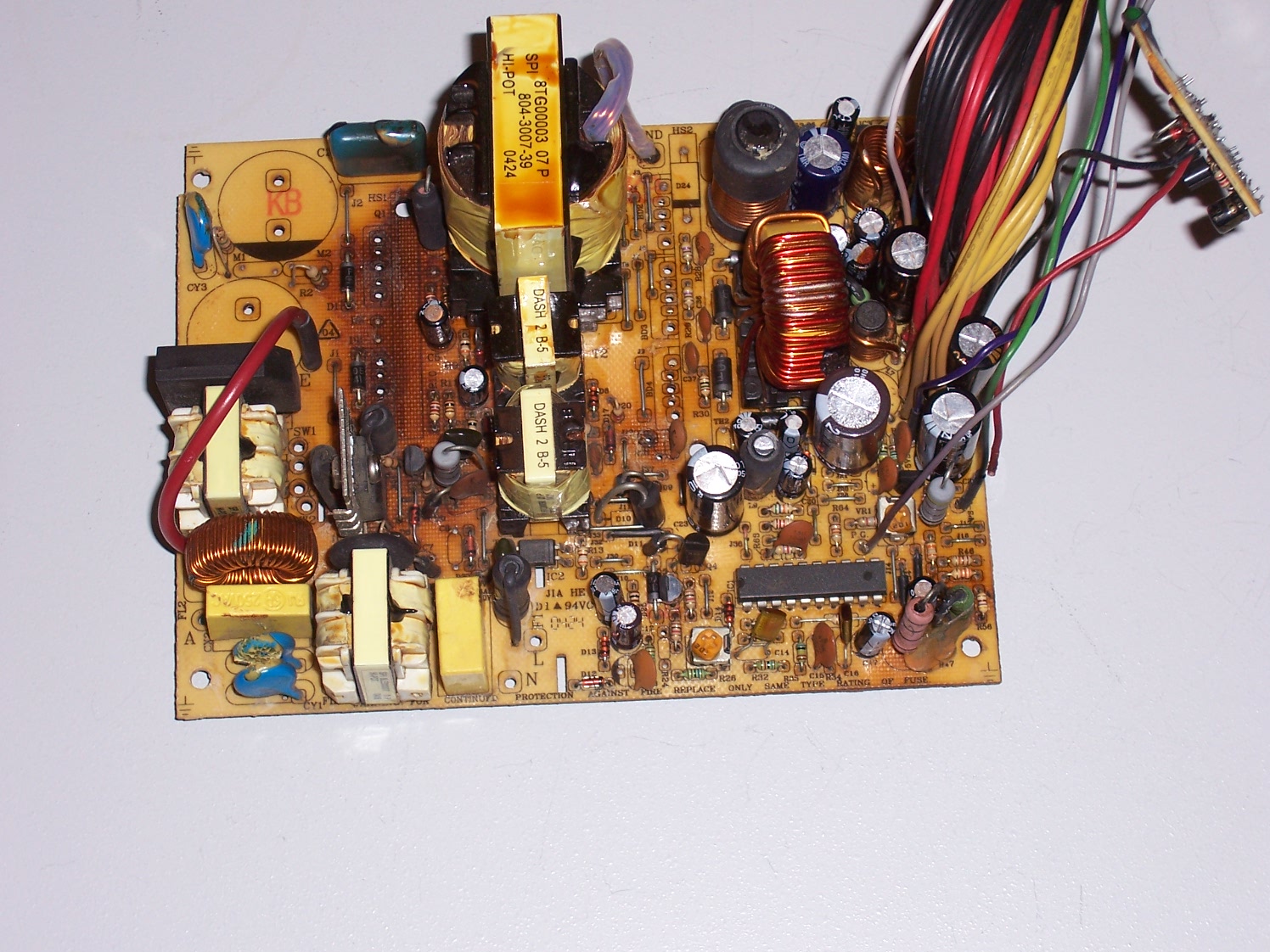

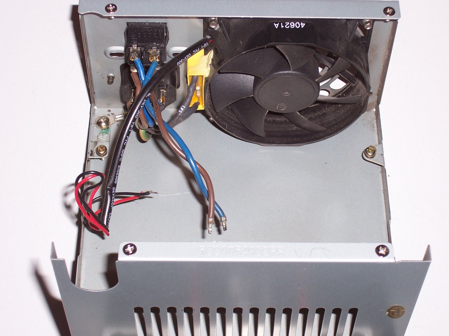

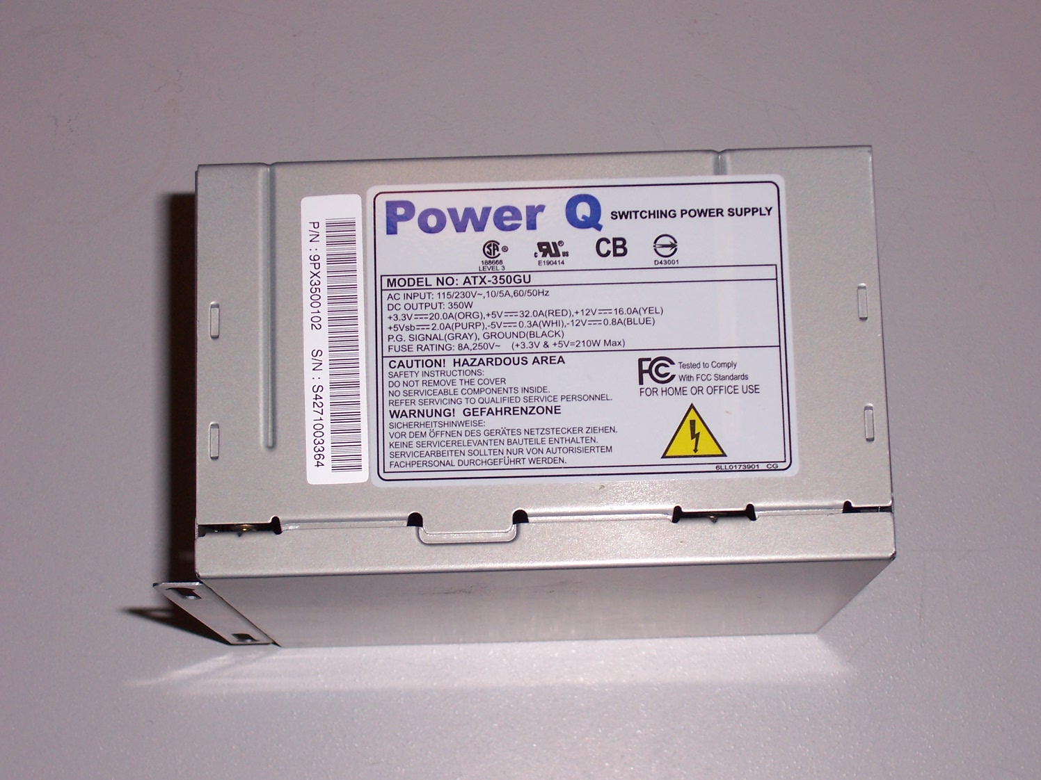

Just obtained a Power Q ATX-350GU. Looking inside, the pc board was identical to the Fortron FSP300-60ATV. Next, I determined that the fan was stuck.....totally stuck. Pictures show that there is some heat damage, A few bulging capacitors were changed before making the pictures. I decided it would be worthwhile to look at the esr of all of the capacitors to determine what damage a stuck fan does to all of the capacitors, including the ones that "looked" OK. So here is what I found.

As a result of all these "non bulging" small capacitors with high esr, I decided to go ahead and replace ALL of the capacitors on this board. My conclusion: stuck fan plus some obvious heat damage on the pc board means all capacitors probably have high esr.....to high for comfort!

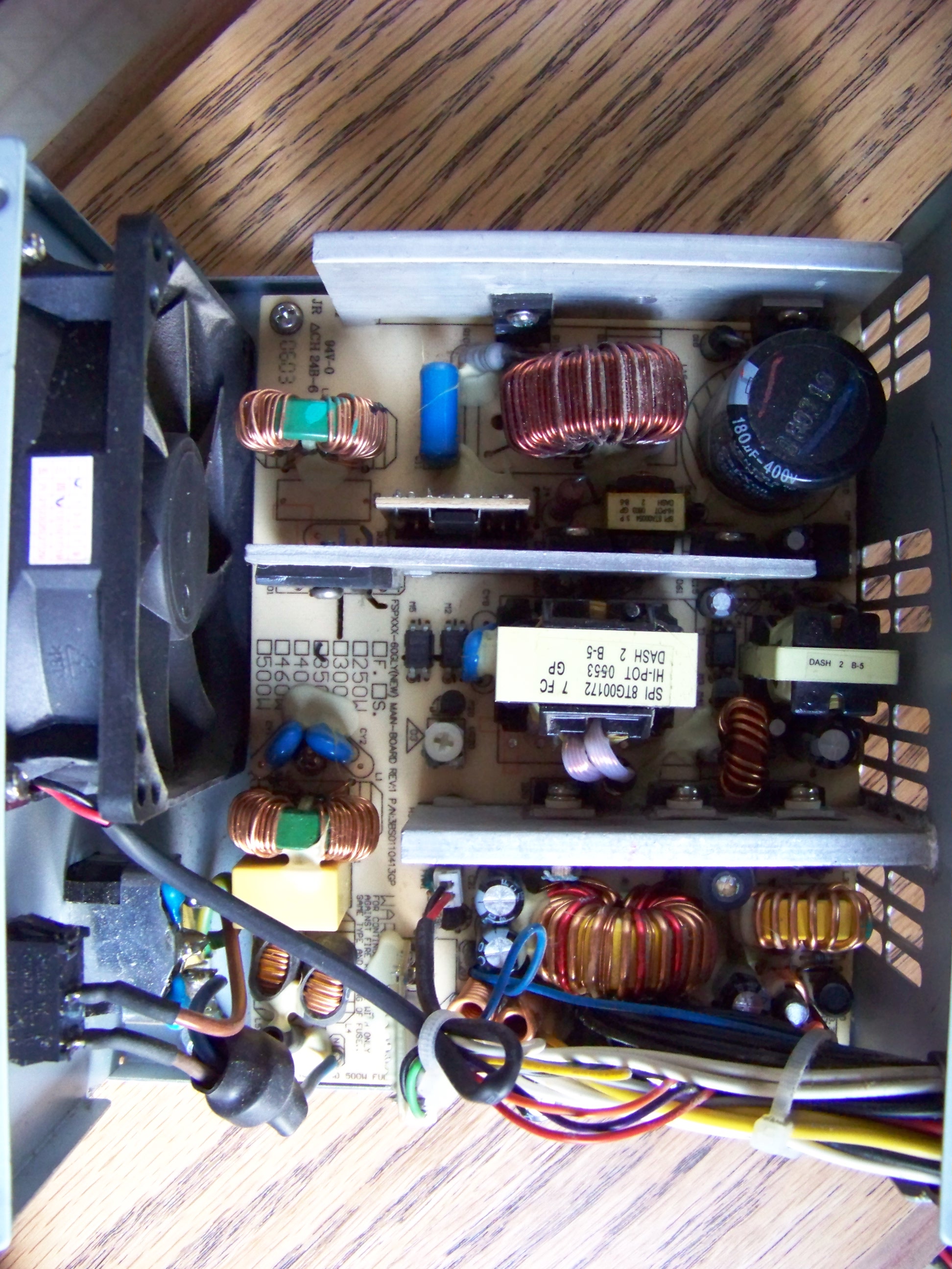

I have a Fortron FSP 350-60HLC that was working fine last week and now as members seem to like to say is dead! Came to me in a free PC which I was told occasionally blue screened.

So opened it up and sure enough the capxon 2200uf 6.3v caps were all crusty on top ( cant believe it ran at all!) Great - replaced them including the one in a jacket by the heatsink and a couple of 1000uf 16v ones that looked slightly domed.
No go !! at least I think not - jumped a green and black connected the fan and a hard drive for a bit of load and -Nothing! ( Might try on a motherboard)
Power is good up to the BIG cap and it has 5.12v on one of the 20pin p ins so I guess that is standby only as there is nothing on 5v or 12v output to hard drive socket. So my question is what can I test with a multimeter without having to remove the heatsinks and unsolder the major components.

It's of GLN origin or OEM design of Fortron Bluestorm II we are dealing with in next thread. Start with replacing ALL the caps in +5 V SB circuitry, incl. probably a 100 uF/16 (25 V) cap in the middle next to the heatsink (use the further position, not so much heat there - there are 2 positions in parallel) and some other small cap on the PWM IC. Also replace the 1N4007 diode on the primary side of the stand-by rail with some super/ultrafast diode as everell suggests.
As for the rest, I can supply you with NCC KZH 1000 uF/16 V D8x20 mm caps, best by far (and one of two) possible replacements for those D8 crapxons.
This thread has the schematics you will need for troubleshooting this power supply. Perhaps behemot and I can help both you and perhanson to get these power supplies running again.
Pay close attention to the two diodes I talked about in this thread. Both should be high speed switching diodes, but in my power supply of the same type, both were slow poke 1N4007 diodes.
