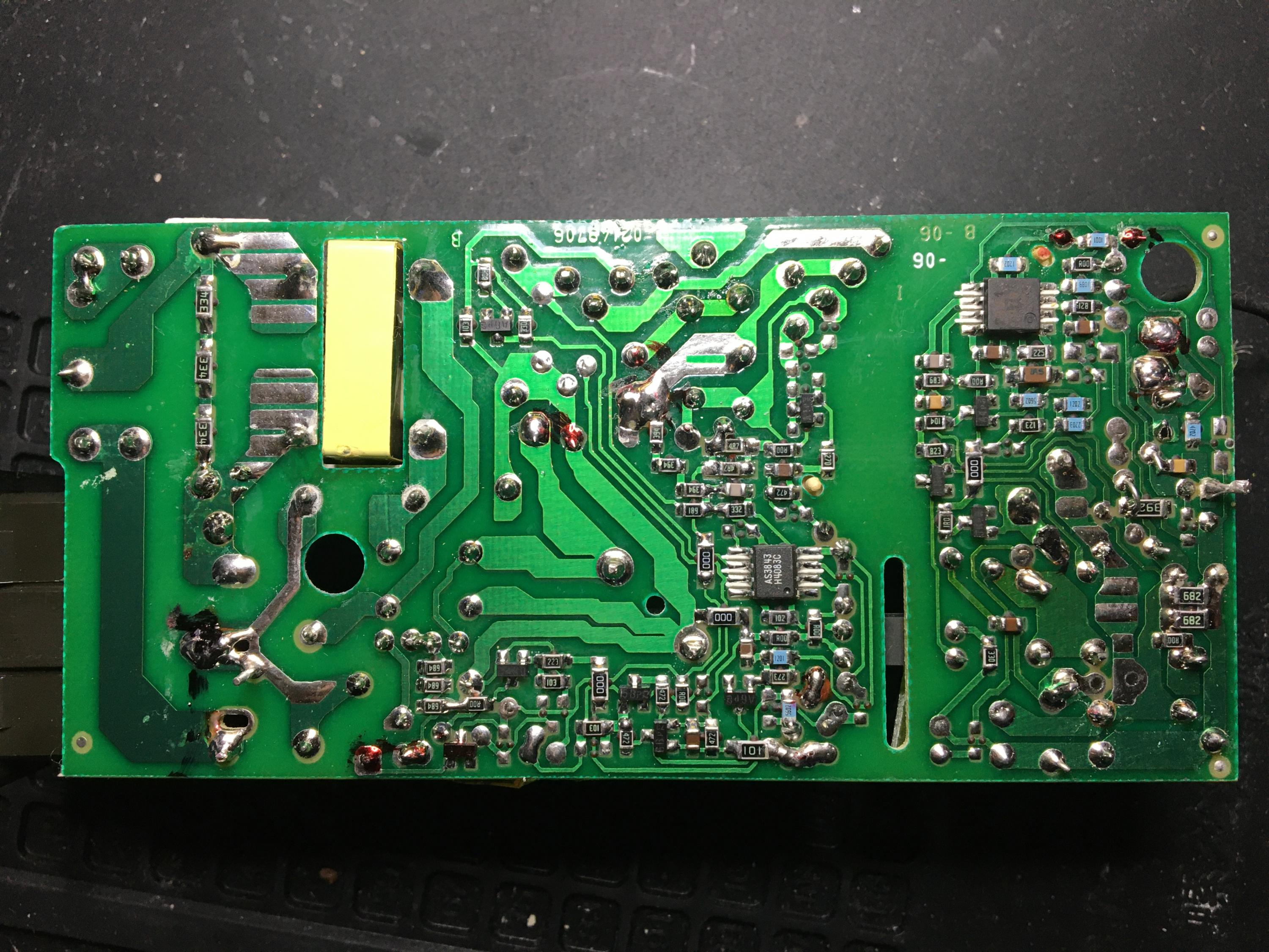

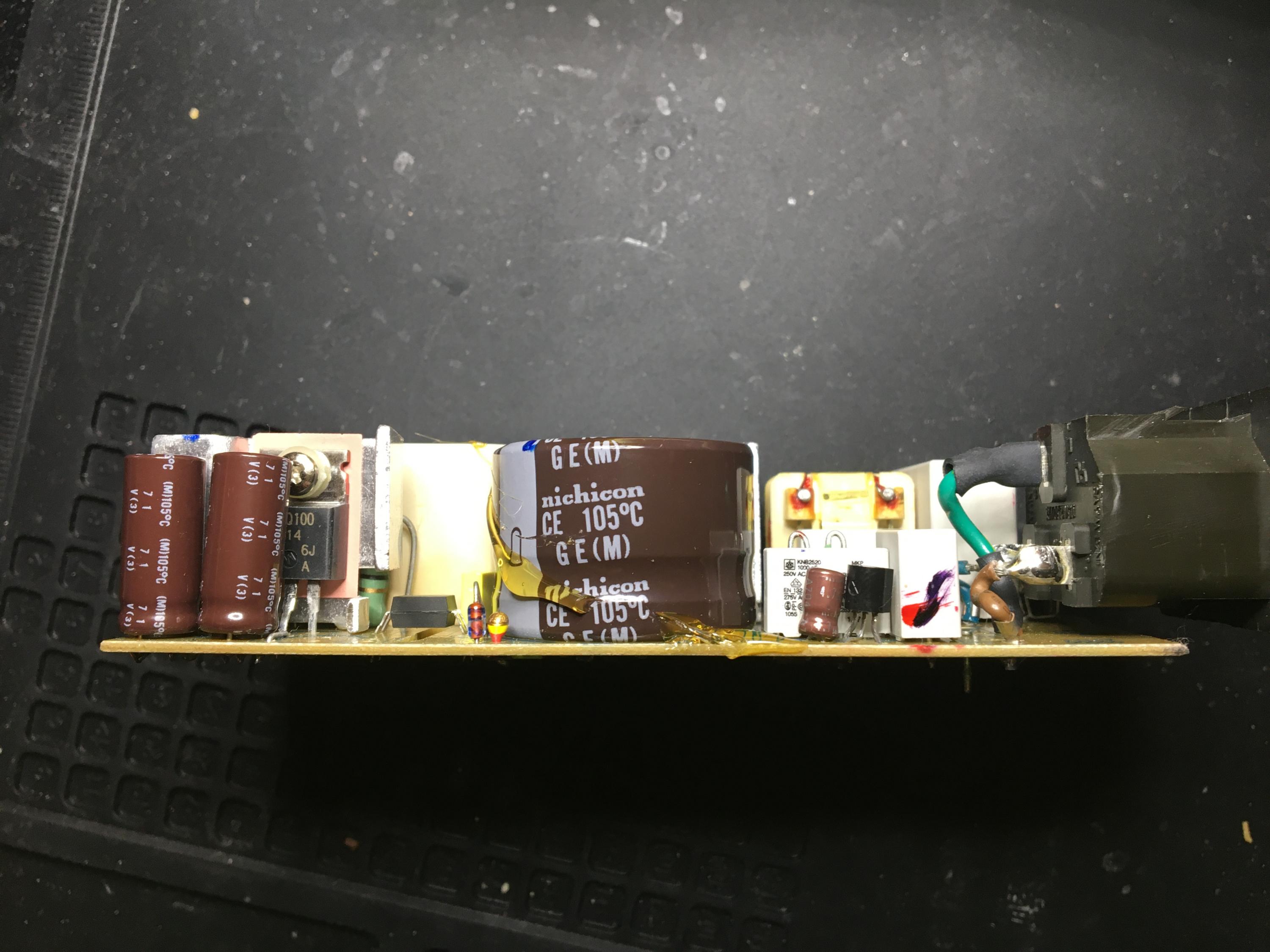

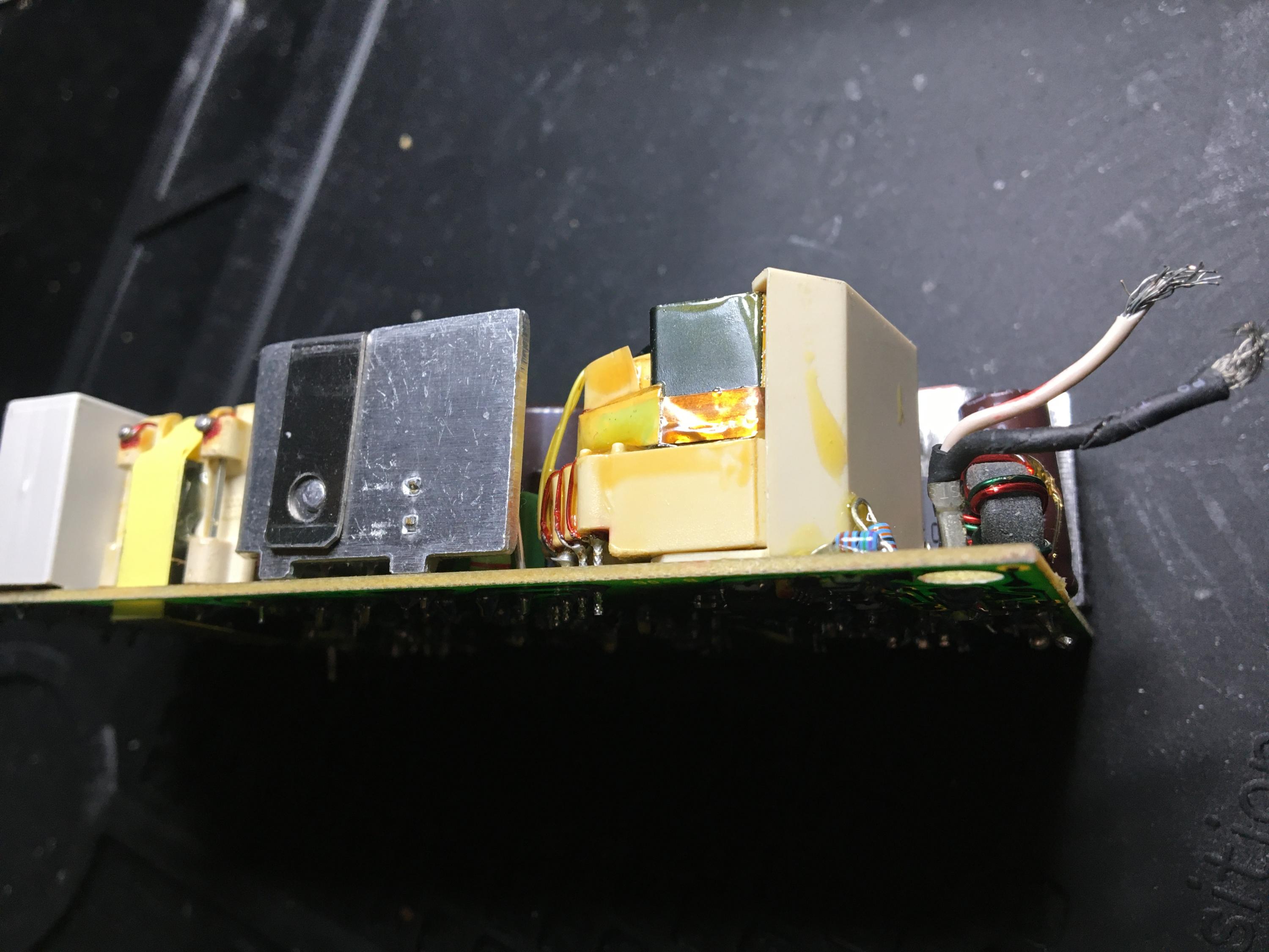

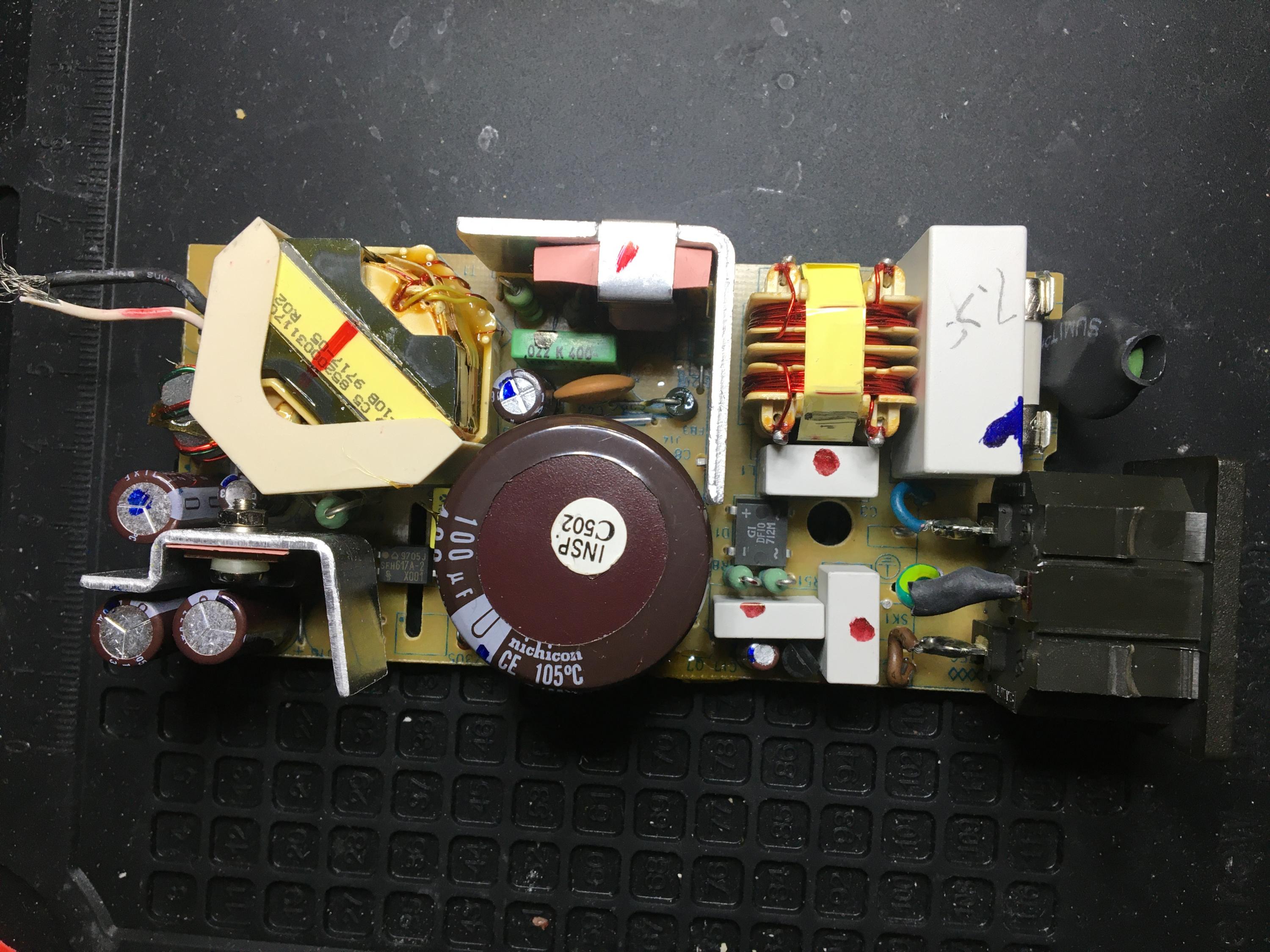

    I've inherited a few PowerBook 3400C laptops, two of which are working and one potentially repairable, though may be used as spare parts. All have power supplies but only one power supply actually works. All of the adapters appeared in good shape, so I disassembled one of them in hopes of figuring out what was wrong. However, I haven't had any success thus far and I'm unsure of the circuit design so I don't want to go poking at it too much and end up on the AC side.
    I have tried different input AC cables but no matter the input, there is no output. I am attaching photos of the internals and hoping for some suggestions on where and what to test.
    Thank you for your time.

    Going by a couple of date codes I'm going to guess it was built in May, 1997. That means you could have electrolytic caps that have dried out, going high ESR. Checking to see if the fuse is open is probably the first step.
    The manufacturer was Astec, a very good company. The topology is flyback, probably discontinuous. The PWM IC is a 3843, located on the bottom of the PCB. One critical component that can cause it to fail to turn on is an electrolytic capacitor, often around 47uF. This is typically charged after turn-on through a high value resistor from the DC voltage across the big electrolytic capacitor. If that small capacitor is high ESR or the high value resistor opens up, the 3843 won't get the Vcc it needs to start up. I would look at the small electrolytic cap between the big electrolytic and the transformer and the small electrolytic cap between the board edge and the white film capacitor. The high value charging resistor might be one of the two green resistor between the white film cap and the bridge rectifier.
    Given the age of this adapter I'd check to see if the output capacitors are still OK.

      It turned out that the small electrolytic capacitor between board edge and white film capacitor had leaked, though it was impossible to see until removing it from the board. Along the way I replaced output capacitors and the capacitor between the transformer and big cap. The latter capacitor was bulging on the bottom slightly.
      For future reference, because the values were difficult to see until I removed them from the board, the electrolytic capacitor between the transformer and big capacitor is 120uF 16V from Nichicon and the small capacitor at board edge is 4.7uF 35V. The three larger electrolytic capacitors near the output are 220uF 35V
      Thanks for the help.
