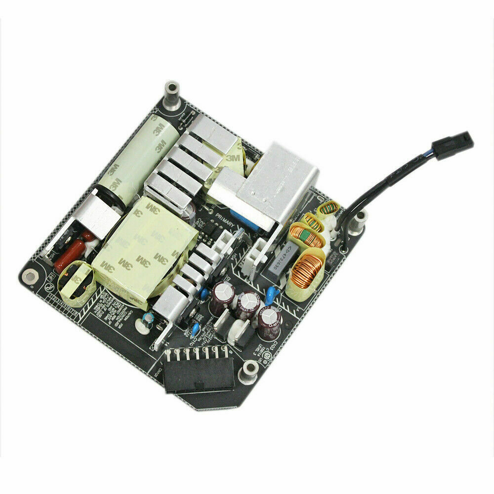

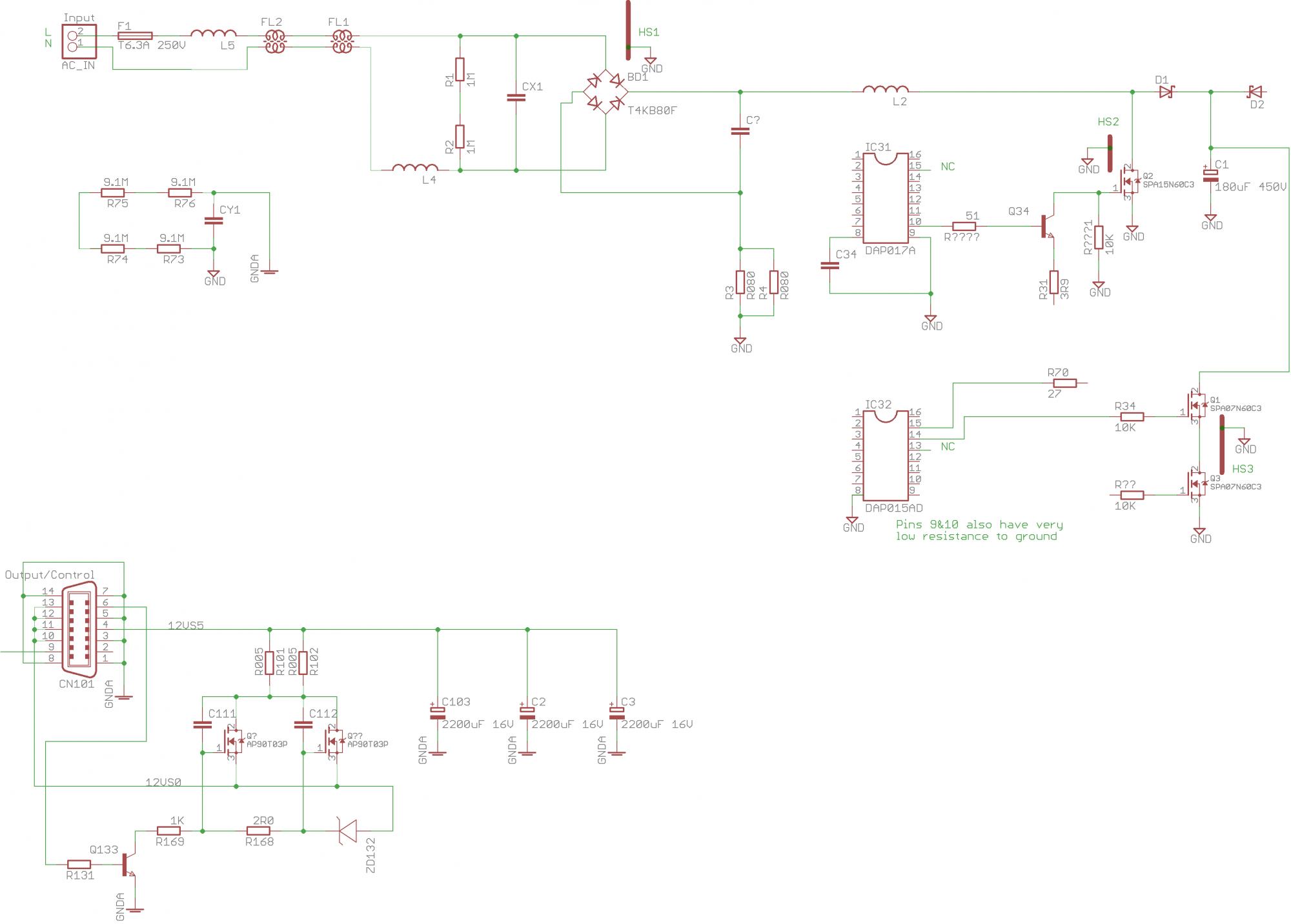

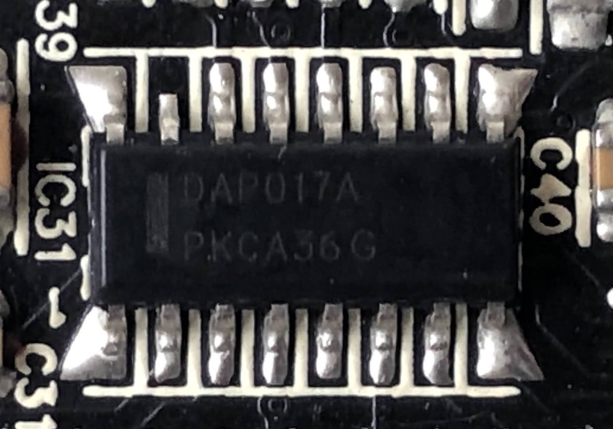

    I need help identifying and finding a pin out for IC31, DAP017A (PFC I think) and IC32, DAP015A (PWM controller I think). A schematic would also work but from my searching on this forum, they don't seem to be available. I have a self drawn schematic which I've attached below. Both parts seem to be in SOIC16 packages. I can't seem to get any PFC boost out of this unit even though I have changed all the bad components I could find:
    F1 open
    Bridge rectifier, BD1, T4KB80F is shorted.
    Q1,Q3, SPA07N60C3 open.
    Any further troubleshooting tips would be welcome.

    A couple of more images for context. Also I should note that Q2, SPA15N60C3,
    and D1,D3 appear to test good.
      Re: Need Help debugging Delta Products ADP-200DFB (iMac A1311)
      I could only find a description of the part number
      http://www.datasheetdir.com/Dap017-T...lication-Notes
        I have to ask how you found that? I spent hours searching and didn't see that.
        The DAP015A may be similar to ST Microelectronics, L6599AT. I'm still checking that out. Many thanks! -Reed
          Basically I click on each listing until I found one that had information for what I was looking for
          I just put this in google search “ DAP017A “

            I've updated my schematic. Is there a way to update or replace attachments?
            Using the schematic that SAM_SAM_SAM linked to I was able to figure out the boost circuit is indeed running. I just need to get the input voltage high enough to get valid Vcc.
            Boost begins at ~90VAC input. 200VDC on C1.
            Gate drive on Q2, Bursts of 192KHz @ 13.6Vpp
            So now I need to figure out the PWM circuit. I see no gate drive on Q1 & Q3. I haven't found any pinout or datasheet for DAP015AD, but my google-fu is weak. It does seem to be quite similar to ST L6599A. Many thanks for the help so far.
              This is for the DAP005 which from the listing I have seen should very similar but I could not find the DAP015AD full date sheet but the description is very similar
              I also found this “ L6599D - L6599 - DAP015 - High-voltage resonant controller “
