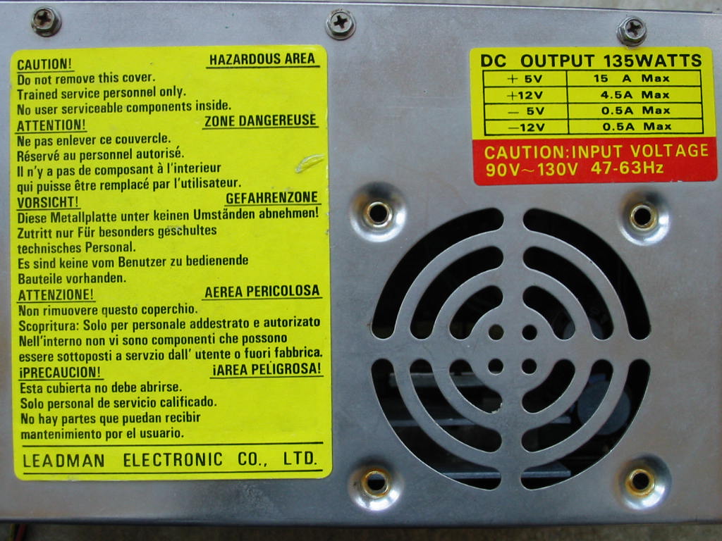

                    Leadman ALYWA-4-86-XT [Leadman 1985 PC-150] PSU
                    I got five (5) old AS-IS power supplies off of my local CraigsList last summer. Owner said they were bad and/or failed bench testing many years ago. I haven’t tested them yet and don’t know what I will do with them either. But as always, I open up all used electronics I get to check for roaches / pests and clean up if there is dust. So while at it, I took some pictures. The unit I have for you today is an old Leadman.
                    https://www.badcaps.net/forum/attach...1&d=1547613992
                    I don’t know much when it comes to these old PSUs, but it looks like a unit for AT systems (please correct me if I am wrong.) To be honest, I also didn’t know Leadman was this old as a company. FYI, this is the same company that made many crappy PowMax PSUs later on in the 90’s and early 2000’s.
                    Model number, as far as I can see, is ALYWA-4-86-XT, at least according to this label on the case:
                    And here is the other label with all the voltage rails and their current capabilities:
                    The distributions seem pretty standard for an AT PSU, with the 5V rail being rated the most (15 Amps) and the 12V rail trailing far behind (4.5 Amps). Of course, those of you who’ve been working with computers long enough to know Leadman and PowMax PSUs, I’m sure you’re probably wondering if the ratings above are actually real. After all, one should never trust a Leadman unit, right?
                    So let’s have a look inside:
                    At a glance, this PSU doesn’t appear to be bad for an AT PSU. After all, many AT PSUs weren’t packed full like today’s high-power units. But taking a closer look revealed a few things that caught my eye…
                    As you can see, Leadman didn’t skimp on the input filtering just on their ATX PSUs later in the years. Even “back in the days” it appears they were cutting corners… if not outright driving on the bank. In particular, look at that Christmas candy-colored common-mode choke with its telephone-like wires! That’s a classic sign of a nasty cheap PSU. Capacitors C1 and C4 are installed across the Live and Neutral lines, so they should be X2-class rated. Yet, all we get is regular polyester and ceramic caps for C1 and C4, respectively. Then, next to the input caps, you can see some large and small diodes – this is the “bridge rectifier” of the unit… and a staple cost-cutting technique of Leadman / PowMax PSUs (the different diode sizes, that is). As if installing the same bigger diodes for the whole bridge would have been so much more expensive If you thought that’s all, look at the blue wire for the voltage selector switch up there – it’s some thin measly 22 AWG stuff. But the cheapness doesn’t end there, either:
                    Most of the input wires are actually 22 AWG, with ground being 24 AWG! Sure this is a low-power AT PSU, but corner-cutting like this is just silly!
                    Let’s move onto the secondary side:
                    Here, we have some interesting surprises – the output filter electrolytic caps are all Japanese brands, and I actually think they may be genuine (most likely because cheap Chinese and Taiwanese caps weren’t widespread back in the 80’s). The black cap is a Nippon Chemic Con SL 16V, 1000 uF (probably for the 12V rail) and the two big gray ones are “NTK” brand, 10V, 2200 uF (probably for the 5V rail). The lack of vents on these caps also suggests this is an old PSU from around the 80’s. This is further supported by the “LEADMAN 1985 PC-150” label on the PCB. Speaking of which, I don’t know if that’s the actual model number of the PSU or just an internal PCB model. But either way, it’s not a good AT PSU (save for the caps, perhaps.) Sure the output caps appear to be fairly large, but also note that there are empty cap spots on the PCB and that some of the output caps installed are smaller than the PCB markings. So I’m pretty sure Leadman was doing more cost-cutting here.
                    As for the components on the heatsink: I couldn’t get any part numbers off of those, due to them being covered by brackets (that I didn’t feel like removing.) They are all TO-220 parts, though - likely two BJTs for the primary side (can’t imagine this being anything else but an H-bridge PSU ) and two output rectifiers for the 5V and 12V rails. There is another TO-220 component on a separate smaller heatsink on the secondary, which I’m not sure if it’s a regulator or a diode for the -5V or -12V rails. However, that’s all there is to this power supply.
                    Next, a shot of the PCB solder side:
                    https://www.badcaps.net/forum/attach...1&d=1547614130
                    Yet another pointer for this PSUs vintage - the traces definitely don’t appear to be computer-generated, which wasn’t uncommon. The separation between primary and secondary traces appears marginal. It might still be better than some mid-2000’s gutless units of theirs, like the Sun Pro KY-480ATX I posted here a few years ago. And the soldering appears to be done with leaded solder and not that bad.
                    Last but not least, sharp eyes may have noticed from the case pictures that the fan is missing. Well, this is why:
                    It’s probably the only issue that is not Leadman’s fault. Looks like a decent fan, TBH. It is ball bearing type too. Brand is ALYWA (same as PSU?) and model number DFB-8A12M, rated for 150 mA @ 12V. Might be worth a short at fixing it, but will see.
                    Well, that’s all I got for this power supply. No detailed component breakdown again, but I think the pictures speak for themselves. Overall, it's not that terrible when considering this is an AT power supply. In fact, it's probably better than some of the gutless PSUs they produced later in the years. Nevertheless, I still think this unit belongs to this thread, mainly because of the corner-cutting. After all, I posted an Astec PSU of a similar vintage in the Quality Pictorial thread (link here), so I think that explains why I posted this Leadman here even better.
                    Anyways. I suppose that's yet another gutless Leadman added to my collection. Weeee
                      Re: the gutless, bloated, and fried power supply hall of shame
                      "X" cap C4 is rated for 500V and a horrible tempco! The "Y" caps are also GP ceramic disc types, !
                      The output caps are all rated for 85C, which mean that at best they are high quality general purpose parts. I don't know who NTK Electronics is, but the NCC SL series part is high quality general purpose, and that series probably went obsolete in the mid 1980s. NCC/UCC's low ESR parts in that time frame would have been the RX or RXA series in miniature can, and RZ or RZA series large can. Probably all 4 were available, with the RXA and RZA being fairly new.
                      In that era Boschert and Astec tended to use low ESR parts on the 5V output, and high quality general purpose capacitors for the lower current outputs (in NCC/UCC, SL or SM series).
                      If you wanted to fix that thing and make it safe, you could probably salvage real X and Y caps from something you've scrapped. You might be able to uprate the input rectifiers the same way. You also would want to replace all the 35 year old electrolytics. You'd want to use the worst low impedance parts you could find for the output capacitors, maybe something like Nichicon PS series (NCC/UCC seems to EOL older series quicker than Nichicon does).
                      Or maybe it could be a "Get a load of this POS!" curiosity for your hardware nerd friends.
                      PeteS in CA
                        Originally posted by PeteS in CA View Post
                        If you wanted to fix that thing and make it safe... Or maybe it could be a "Get a load of this POS!" curiosity for your hardware nerd friends.
                        Most likely the latter case. I don't really trust Leadman designs that much, TBH. Or maybe take it apart for its useful components?? (Though there isn't much of anything special in there.)
                        Like I said, fan is probably the only thing worth fixing.

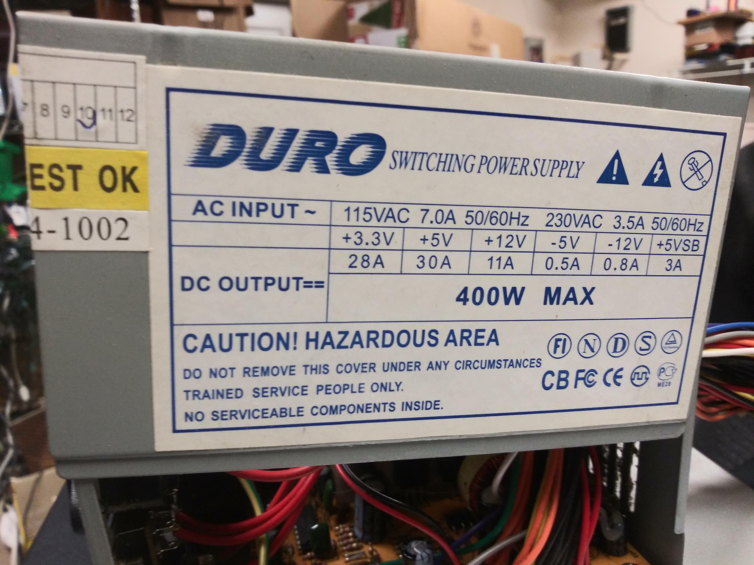

                                Here's my submission to the gutless hall of shame. A Duro "400W" ATX PSU, pulled from a curb picked XP PC. I'm going to hazard a guess this is just a crappy Linkworld PSU (Like the "300W" one on JonnyGuru's site). The output on this was so crappy that it actually took out a cap on the motherboard.
                                No bridge rectifier here, Just the 4 crappy diodes. EMI/RFI filtering? Bah! We don't need no stinkin filters! SWCON caps on every end of this thing, a +12V section that's good for 6A at the most (2x FR302 Fast-Recovery diodes). All of this running an AMD based machine.
                                Somehow, this did not kill any hardware other than one cap on the mobo. After putting in a spare Bestec (Not the 12-250E mobo destroyer!), The machine ran just fine.
                                This unit is still alive, but I sure as hell ain't plugging this in ever again.
                                    RE: the Duro PSU...
                                    Not sure if it's a Linkworld - at least it doesn't look like it to me.
                                    Pretty gutless unit though, especially the secondary side with its two 3 Amp DOaB. Not only that, but I see a 40N03P MOSFET (Q5), which tells me the 3.3V rail is likely linearly-regulated from the rectified 5V rail. This is a cheap way to get a clean 3.3V rail with very little ripple, but it is very inefficient. And I imagine the 5V rail rectifier is probably a 20 Amp part at best. So 3.3V + 5V combined power is realistically no more than 100 Watts.
                                    At least back in the Pentium 3 and Athlon days, most PCs rarely required more than 40-60 Watts of power. So that's how this PSU probably managed to survive that long.
                                      Yikes! Are you sure those caps with "K" vent markings aren't "Rulycon"?
                                      That would be the right period for the dreaded "Rulycon" caps! (or the dreaded "JEE" caps)
                                        All caps in this thing are branded "SWCON". Don't see any other brands in here
