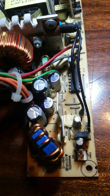

    Good morning,
    I have a pc7071 lenovo desktop psu that when i short the 4-5 pin and REMOVE the power cord it powers up for a while. when i plug in the power cord it stops. All caps looking good.
    I have a little experience with PSU's. Any idea will be welcomed .
    thnks in advance!

    Look for any burned or damaged parts and swollen capacitors.Take some clearer,close up pictures

      I don't see anything burned. The caps looking good.
      When i put the cord on, then remove it, and then short the pins, it powers on for a while and i have 3,3v 5v, and 12v.

        The power supply may be turning off because of OCP (Over Current Protection) / SCP (Short Circuit Protection) / OPP (Over Power Protection). There could be a short on the motherboard that the power supply is detecting. So have you tried using the power supply to power a different motherboard ? (may not be realistic if the power supply uses a proprietary connector).
        In your pictures some of the capacitors look a little buldged on the top like the 4 tall ones with K bungs (probably rubycon capacitors). But your pictures are pretty bad so hard to tell.
