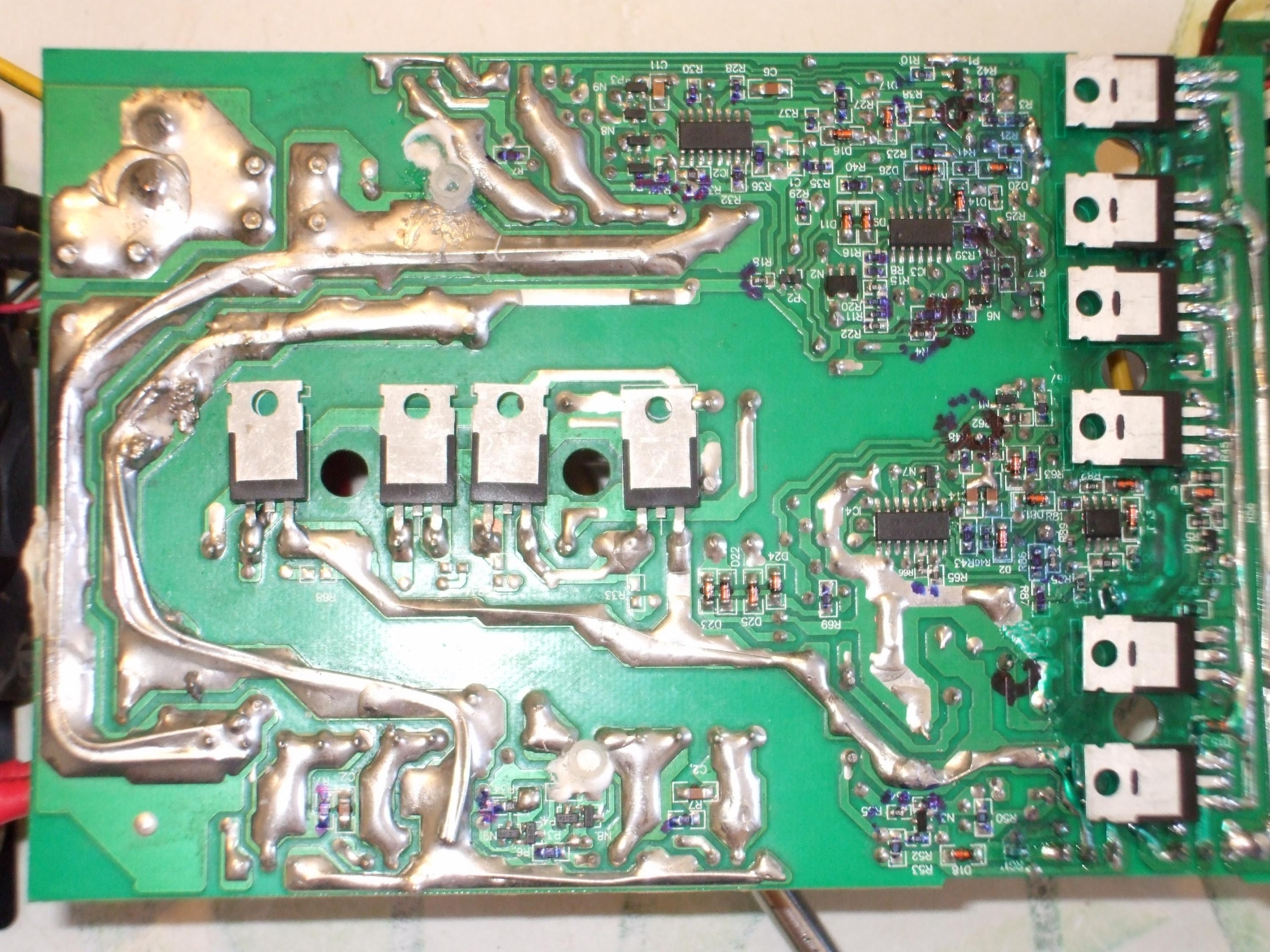

    I have a Black & Decker 1000 Watt inverter,
    Model #VEC049DCB, does anyone know where I can
    get a schematic diagram/parts list? Need part number
    for output MOSFETs that blew out, and also for a few
    traces that burned.
    Thanks in advance for your help.

      I found part of the mosfet, it looks like IRF640B.
      Would be nice to have a schematic for the
      burned traces or even a pic of the traces.
      Thanks again.

        I ordered the Mosfets from Digikey, part #IRF640NPBF-ND.
        Repaired the traces, installed the mosfets and replaced a few
        resistors. Inverter is back together, hooked it up and turned it
        on and have a green light but has no output with a lamp hooked
        up to it, but when I shut the switch off the light comes on briefly.
        Any ideas? Thanks in advance.

          Do the mosfets have a controller IC chip that they are hook to if so it might not be working right please post a picture of the board front and back

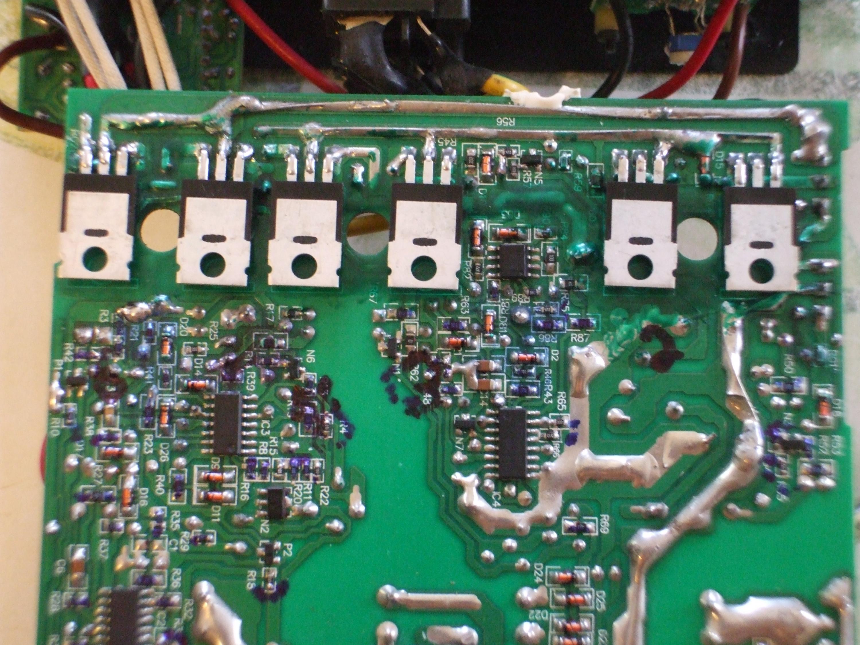

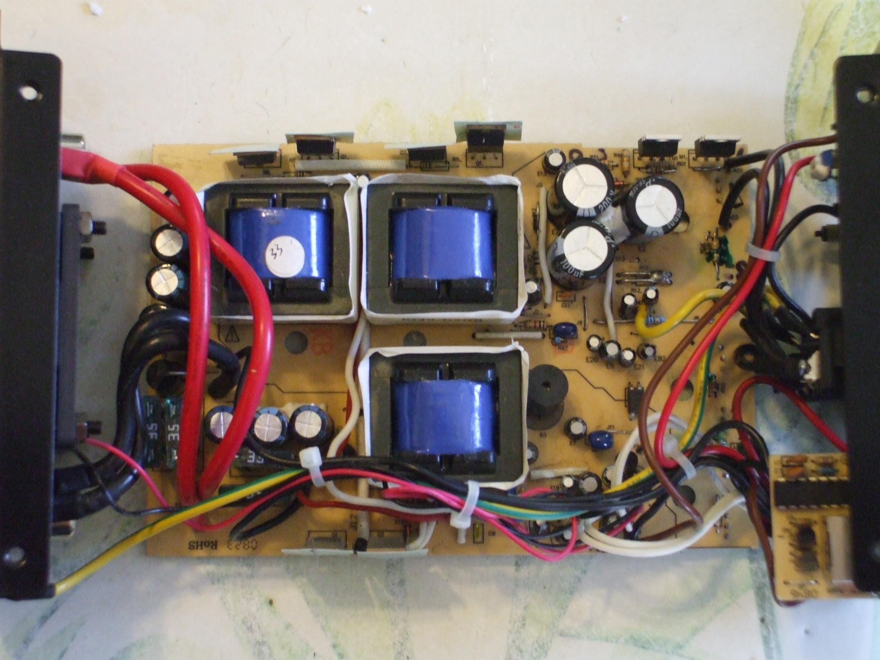

            Re: Black & Decker 1000 Watt 8.5 Amp inverter help.
            Hi sam_sam_sam.
            Here are the pictures of the bottom and the top of the inverter.
            The Mosfets on the right in pictures 29 & 31 are the ones I replaced.
            Thank s again for your help.
            Sorry for not uploading the pictures, not all here
            this migraine is kickin.

                check the mosfet connections .i noticed one looked not soldered and one looked shorted .might just be the pics though .

                  Hi everyone sorry it has taken me a while since my last post, my Mom passed away, haven't felt much like repairing anything. I did manage to repair my inverter. I replaced (IC1 Sop-8, Digikey #AP358SGDICT-ND) and (IC4 Sop-16, (Digikey #KA7500CDTFCT-ND), this did fix my problem and my inverter is working again.
                  Thanks again to all those who helped me fix this inverter.
