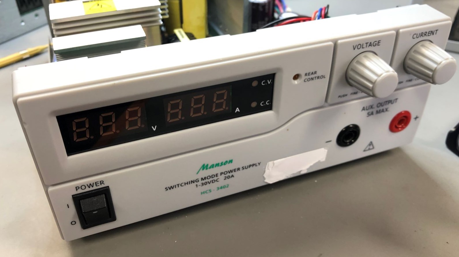

    G'day all from a first time poster.
    I've got a Manson HCS-3402 here that has been playing up, and then today failed.
    On start up it used to go through all the self tests OK, run for 30 seconds then power down. Yesterday, it ran through the self tests OK, then displayed ERR on the front panel.

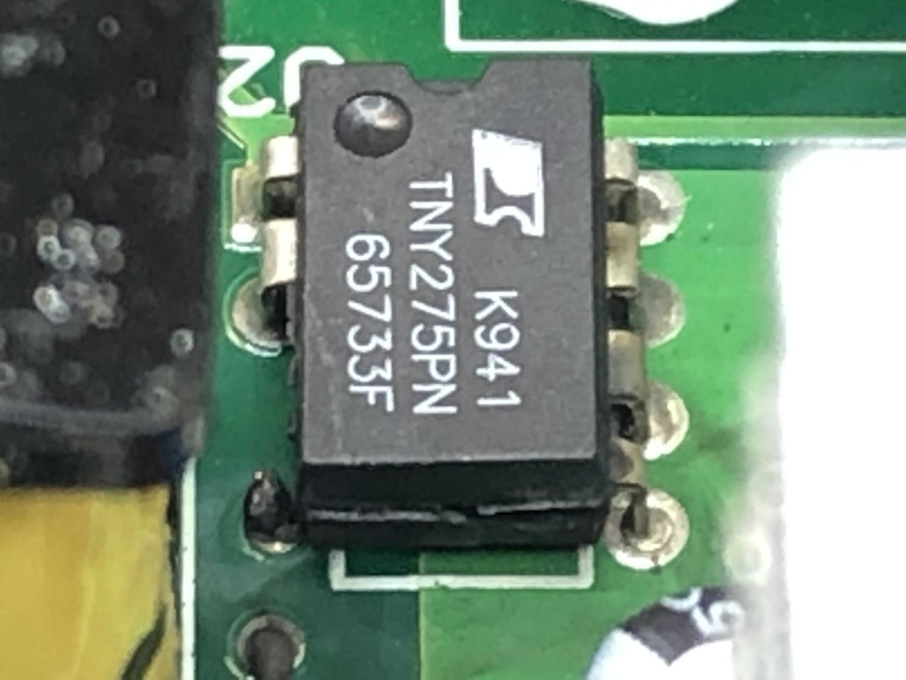

    Today I powered it up, and got nothing. I tried again in preset mode, and it powered up, ran for about 60 seconds, then vented smoke. On the primary side, U2, Pin 4 looks more like a failed fusible link with D5 also looking quite sad. Mains fuse (as expected) also blown.
    Before I get too carried away, are the schematics readily available for this model? I did read through an earlier thread on the 32xx series and grabbed info from there, but quite a bit of difference between the models. I believe these are the same as the Peaktech 1575.
    Hoping that there is a chance of resurrecting this!
    Cheers.

    Damage to U2 - Pin 4

      You can get some here
      https://www.ebay.com/sch/i.html?_nkw...&ul_noapp=true
      https://www.jotrin.com/product/parts/TYN275PN
      They say that they take PayPal
      I would not recommend buying from them if they do not take PayPal
      That just me
      I would recommend that you check for shorts near and around that chip seeing how the pin burn off the chip
      Could you please post a wider view of the area around that chip thanks
      Here is the data sheet for this device
