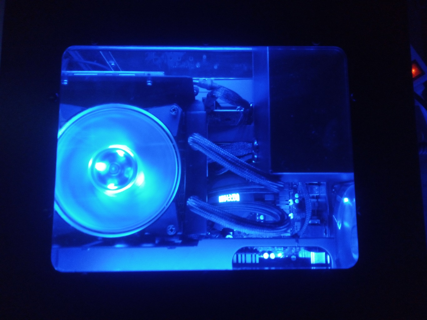

      Ok, thanks for your opinions. The final setup is:
      AMD Ryzen 3 1200@3.8Ghz 1.3Vcore
      Coolermaster ML120L RGB water cooler
      2x8GB DDR4 RGB 2666@2933mhz C16 1.35V
      Asrock B450M PRO4
      Gigabyte RX560 OC 4GB (powerlimit removed)
      240GB Kingston SSD
      I have added some pictures. I made them with my PotatoCam©™, so in reality it looks much much better than in the pictures. I also did some mods to the pc:
      - Case panted black from the inside (looks really good)
      - 3D printed bracket to fit 120mm radiator in the 5.25" drive bays
      - Added 2 RGB LED strips
      - Sleeved ALL the cables
      - recapped PSU and replaced 12V rectifier
      That was quite a lot of work. If i run Furmark and Intel Burn Test simultaneously, the 12V rail drops from 12.66V to 11.40V, so won't do that again... But with some heavy gaming, the 12V rail stays around 12.0V, so no worries there. The 5V stays solid at 5.12V and the 3.3V rail stays solid at 3.52V. The system runs stable and quiet. The power supply does run a bit warm, but the efficiency of it is horrible of course and it has got a temperature controlled fan which doesn't really help with thermals.
      I will see what happens. Currently it is purring like a kitten, but who knows for how long.
            IDK, looks pretty good to me already. Nice light mods you got on there.
            (And LOL @ PotatoCam©™ )
            You mean foam wouldn't have been good enough?
            https://www.badcaps.net/forum/attach...9&d=1544304344
            (Picture by Drack, found in this post )
              Yeah, i really like this case now. The hardware/case combo with LED's is just right. Especially when you know it's a budget build.
              Aww, dang it. Should have done that instead.

                                          Just a small update on this PSU project It's still chugging along nicely. The CPU has recently been replaced with a Ryzen 5500 with a small oc to 4.5GHz boost and the ram had some headroom as well, from 2666C16 all the way to 3600C16, not bad for early DDR4 memory. The current system configuration:
                                          - AMD Ryzen 5500 @4.5GHz Boost
                                          - Cooler Master ML120L RGB AIO CPU Cooler
                                          - 16GB DDR4 2666C16 @3600C16
                                          - Asrock B450M Pro4
                                          - 1TB SSD + 256GB SSD
                                          - Geforce GTX1650 Super 4GB
                                          - Some additional RGB lighting
                                          In the summer during longer gaming sesssion the case temp can read up to ~46 degrees right where the intake is of the power supply so i really can't fault it for it's performance and reliability up to this day. Still haven't gotten around to replace it with the other PSU that i prepared for this build a couple of years ago.
                                          In the meantime i had a Cooler Master MWE White 450W fail on me after a year in a relatively low-power file server. It was a really weird failure where the PCB had a burn mark on quite a thick 240v input trace without any further damage to be seen. And the circuit breaker tripped. It was always connected to an APC UPS so it should've had an easy life. Sometimes luck needs to be on your side i guess.
