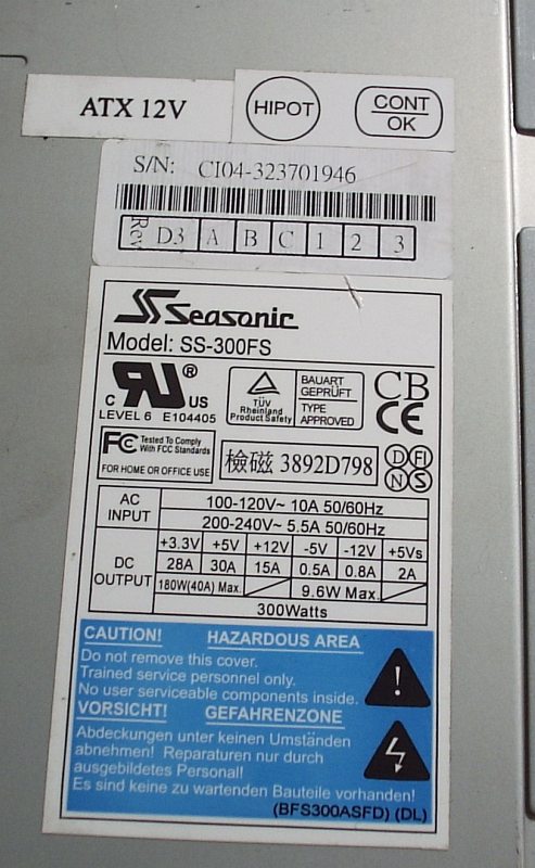

    Heya all I need your advice..
    Lately i had been visiting some local computer shop/market. At there, second hand PSUs were for sale everywhere. Usually i dont bother to look at them, as i knew from my experience those where cheapo bastard psu like simbadda, ersys, premium, deer, or other unreputable brands. Korean PSUs that can be found there are decent but will only suit P3 system. Those were sold all for the same price, $4-5. But then, I was in a need of a bunch of molex connector for my project , a $4 spent wouldnt hurt me, so i took time to look at those cheapo PSUs.
    To my surprise, i found:
    - Seventeam 300W and 250W PSUs (about 3 units)
    - Hipro 300W PSUs
    - Seasonic 300W and 250W PSUs (about 3 units)
    The Hipro one is a big size unit, it wont fit a standar PC case, but i bought it anyway for my collection. As for the seasonic and seventeam psus, my question is : can i use them for current modern system, that will consist of..
    • Intel E5200 (45nm 2.5GHz)
    • Biostar/Gigabyte motherboard with Nvidia chipset (onboard GPU 7050 or 8200 series) or Intel G31 chipset
    • 2x SATA HDD
    • One SATA DVDRW
    • 3x 9cm Fans
    • PCI Video Editting Card
    Currently i'm building about ~ 10 PC systems, I'm certain they all will be light load systems. I would need those PSUs if it turn out they are decent for my projects. So, let me know what do you think, can i use them? Or are there anything i should worry about? (like atx cable 20 to 24 adaptor)
    (Of course they will be recapped before i put them to use..)

    Re: Using old Seasonic and Seventeam 300W PSU for today modern PC?
    In case you need more pics to help me analyze ...
    Seasonic SS-300FS PSU (300W) :

              These are old ATX 1.2 or 1.3 units: most of their output is on the 3.3 and 5V lines because Pentium 3s and Athlons draw power from these. Since P4s and Athlon 64s, computers draw most of their load from the 12 V line so:
              a) open them, clean from dust and check caps: Vent (Seventeam' secondaries) and other known bad brands are suspicious, check their ESR. Replace bulged or marginal caps as well;
              b) ensure there is enough power on the 12 V line: any value above 150 W (e.g. Seventeam's 180 W) is more than enough for a low consumption Core 2 Duo and motherboard with integrated or low-end graphics (Ati 2400 and 3450, nVidia 8400/8500), just avoid anything more demanding;
              c) test voltages at full load: if 3.3 and 5 V lines are too lightly loaded, they may be out of tolerance (higher than 3.46 and 5.25 V respectively: according to ATX standard, +/- 5% tolerance on 3.3 and 5 V lines and 10% on 12 V line).
                  SeaSonic SS-300FS 300W
                  I really like this unit! It runs virtually silent, a little bit warm, but everything went smooth. Oced the X2 5000+ to 2800Mhz no problem occured.
                  I temporarily replaced my 500W Silversone with this Seasonic 300W to power my main rig in my signature. It is quieter than that Silverst0ne (which is actually a low noise PSU).
                  20 pin atx plugs into 24 pin socket:
                  (What a mess of cables... )
                  Voltage rails at idle :
                  Voltage rails at full load :
                  It rocks solid!
                    Before recapped, the unit is in good condition. No burnt marks, no discoloring components, no bulging caps (JPCE-TUR). It started fine with dummy loads.
                    That black thingy is a foam (for a spacer).
                    After recapping :
                    Caps : Nichicon HE, Chemicon LXZ, Chemicon KZJ, Sanyo AG, Samxon GC, Rubycon YXF (for a 47uF 63v).
                    Hmm..that's it for the SeaSonic PSU. The Seventeam units will have to wait till i get spare time to recap/modif/test it properly.
                    Any comments are really appreciated..

                      Hmmm, must have at least 3.3 and 5v sense if the voltage on them increases as the load does.
                      More likely its more of a crossload situation because of the 12v based computer its powering.
                      • yanz
                        • Nov 2004
                        • 910
                        Yeah, when the load on 12V increased -> 3.3v and 5v rails are up a bit. It is really noticeable on my DMM screen. The same will happen when I playing with the CPU multiplier (example : goes from 1600Mhz to 3000Mhz in a sudden).. The system is stable though..

                              The psu is a group regulated one so expect some crossload; moreover power draw is higher on the 12 V line than on the 5 V one and this affects voltages: given that values are still within tolerances and ripple should be under control, I wouldn't worry at all.
                              Good recap for the Seasonic.
                              About the two HiPros: the brand is [was?] known for good psus with average caps, usually they're worth a recap. The 250W one was employed in some old HP Pavillion desktops and I believe it's pretty low on 12 V (say 11-12 A), the 300 W is only mentioned in an Abit motherboard test: check their labels before buying.
