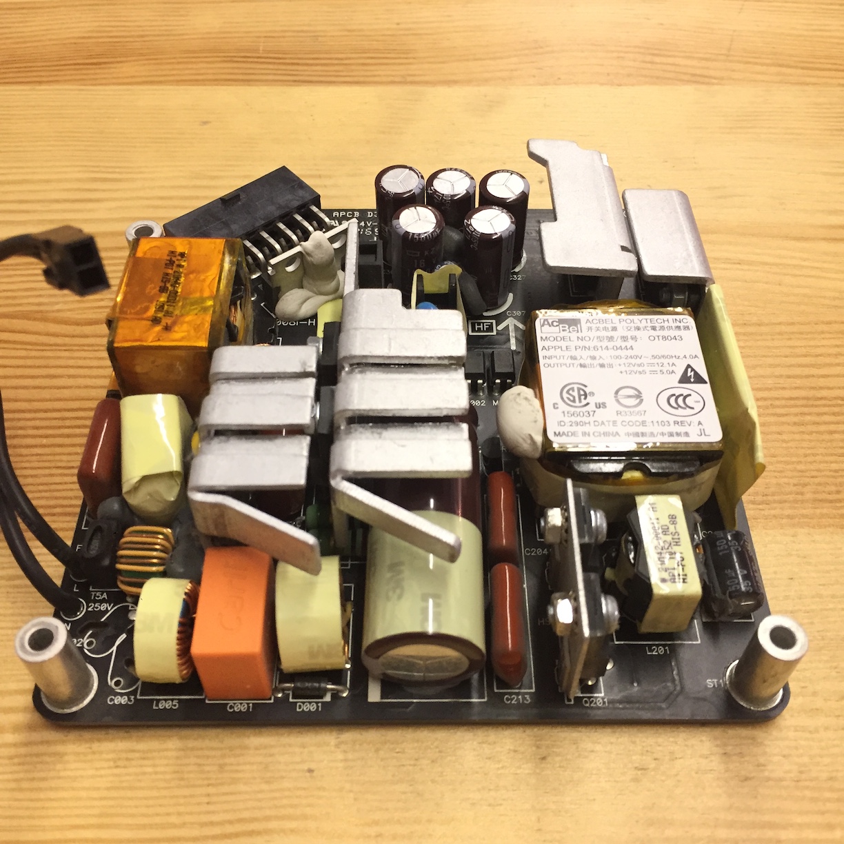

    iMac A1311 PSU 614-0444
    Hello, I am hoping someone can point me in the right direction in fixing the power supply on my mid 2011 21.5" iMac (A1311). The onboard diagnostic LED lights 1 and 2 do not light up when plugged in and powered on. The iMac turns on but does not get passed a black screen. For the past year if turned off the computer would not boot up unless I unplugged the power cord for a few hours. This past week I was updating to 10.13 Sierra and it shut down and will not get passed a black screen now. I pulled the PSU, but everything seems to visually look clean. Attached are some pictures. I really don't feel like buying a new PSU for almost $200 on a computer I do not use very much. If anyone has had an experience in dealing with these PSU's and can pass on any suggestions I would appreciate that. Thanks in advance. -Jay

    The 5 capacitors are KZH 1500uf 16v. Should I start by replacing those 5. Is there any suggestions for a better brand of that style of capacitor? Or should I be looking somewhere else on the PSU?

      I'd look into whether or not it has the equivalent of a 5VSB or 12VSB. If it should but does not, that is where your problem is rather than those output capacitors. If you have no standby voltage, look at small lower voltage electrolytics on the primary side.

              Same iMac, 21,5" Mid-2011. I'm trying to fix an issue with an on/off flashing backlight, everything else seems to work.
              These are the voltages I measured on the PS 14-pins connector:
              pins 1, 3, 5, 7, 8, 14: ground
              pin 2: +3,3 volts
              pin 4: +12 volts
              pin 6: nothing
              pin 9: +3,3 volts
              pin 10, 11, 12, 13: +10,50 volts
              Pin 13 is connected to the inverter input, that is marked 12 volts: there's definitely something wrong.

                i have a problem with an a1311 source and needed help. This is always oscillating the standby 12V, 10V, 11V, 12V, standby pin ... and input 380V, 398, 392, 380 in the high voltage capacitor, all capacitores are ok.... I suspect the pwm.

                  Hi. I found out that in my power supply one of two MOSFETs near the output plug was shorted... That's why I couldn't get a correct 12v rail for the inverter. I replaced both MOSFETs and now everything works fine.
