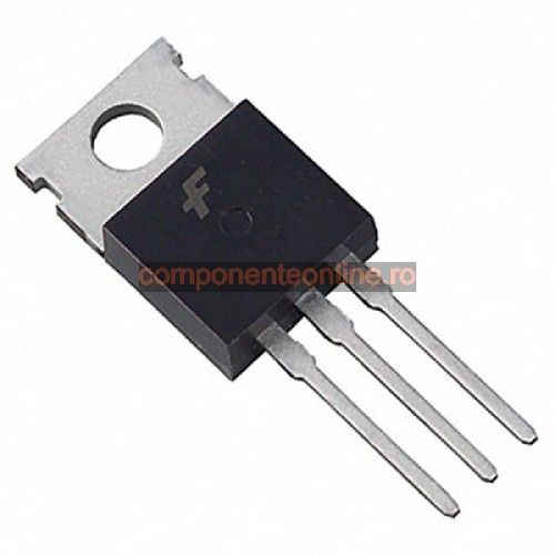

    If the BJT logo looks like this:
    the 13009s were made by Fairchild, which has been bought by On Semiconductor.
      Not really. It looks more like a J on mine - the line that makes the F is missing.
