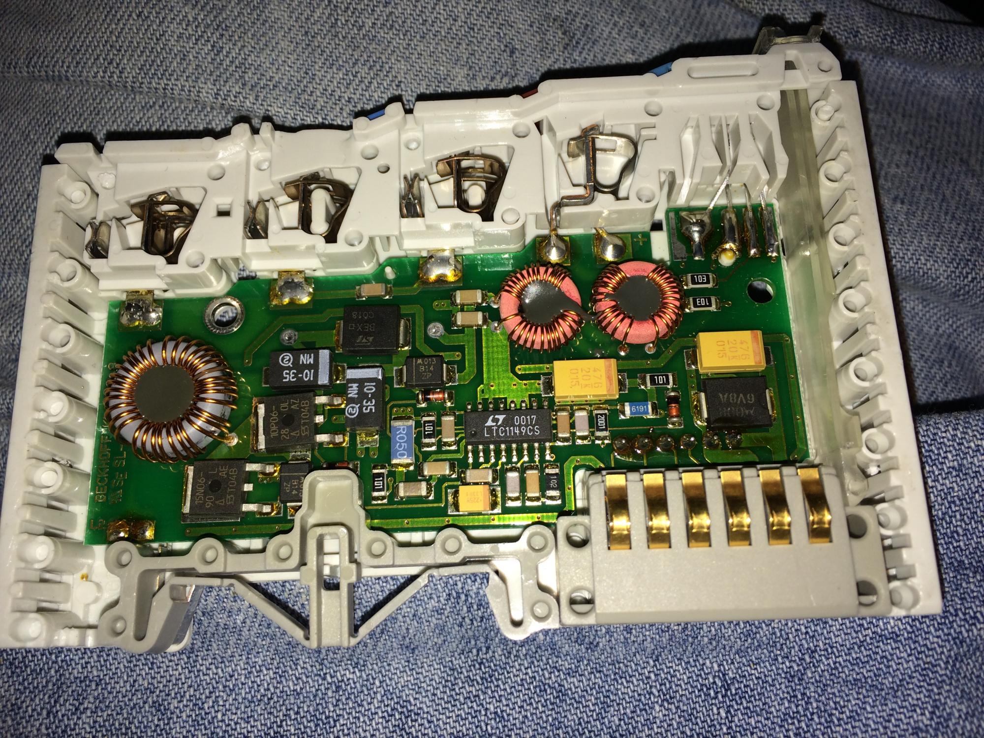

How often do surface mount caps fail the one in photo
    • Jul 2011
    • 6069
    If they fail what type do you use
    The ones marked 10-35 are those caps as well ?

    The yellow ones are tantalum capacitors, which tend to have the habit of exploding or igniting, with flames.
    The black ones with a white bar seem to be polymer capacitors and as far as i know they don't fail more often than others, or well.. don't have a reputation for failures.

        black & yellow are both tant's
        value is on them.
        black 10-35 = 10uf 35v
        yellow 476 20 = 47uf 20v

          476 is 470uF not 47.

              Isn't it "47" and 6 zeros after it? That's 47,000,000pF, which is indeed 47uF

                    47uF - see the reasoning i mentioned.
                    http://www.csgnetwork.com/capcodeinfo.html
                    Last line of the 2nd table - 474 = 0.47uF; add two more zeroes at the end to make it 476, and when you move the decimal point two digits to the right, you get 47uF

                      OK thanks that what I though that it was 47uf

                        like mariushm said, the only way tantalum caps fail is by violently bursting into flames. other than that tant caps last a very long time. asus at one point designed a mobo with tant caps for the cpu vrm instead of electrolytics/polymers at the height of the bad caps scandal. the tant caps physically look ok so i highly doubt they failed. look elsewhere for the problem.

                          I was wrong about the black capacitors because there are black capacitors that are actually polymer or hybrid polymer capacitors, just not in the typical round cases.
                          Here's for example a Panasonic HX series : https://cdn.badcaps-static.com/pdfs/...057483404e.pdf
                          Looks like the difference is more or less in the shape of the metal leads.
                          Here's polymer tantalum hybrids (from what I remember, they have the "advantage" of being safer than simple tantalum capacitors but naturally there are some tradeoffs) : https://na.industrial.panasonic.com/...ntalum-polymer
                          Also worth mentioning that unlike regular electrolytic and round polymer capacitors, on these capacitors the bar tells you it's the POSITIVE side of the capacitor. Some capacitors even have the + printed on the bar.
                          and ps. Remember that some companies (Asus and Asrock are the major ones in IT) which like to print the silkscreen on their printed circuit boards in such a way that the black bar on the pcb is actually for the POSITIVE side of capacitors, exactly the opposite from the common way.
                          It's OK though, they're consistent, if you see basically all capacitors apparently inserted the wrong way, you know it's the stupid silkscreen.
                          If you see just a few, it could be that someone already tried to fix the board before you and put the capacitors the wrong way so it would be worth investigating (ex. determine the negative and positive side by following the traces, often negative side goes to ground so that's easy to determine with a multimeter set on continuity)
                          also a note... polymer capacitors with voltage rating over 25v are kind of rare in this surface mount format, and typically the capacitances are small - see the datasheet above where they stop at 33uF 25v.
                          // and last edit: on the board on the first post, I would definitely rework some of the joints which seem to have little solder to me. Basically, if you don't have one already, you should buy a flux pen or separate liquid flux. wet the joints with some flux and then add a bit of leaded solder to various terminals on the pcb, all those surface mounted diodes and mosfets/transistors on the left side seem a bit dodgy to me.
