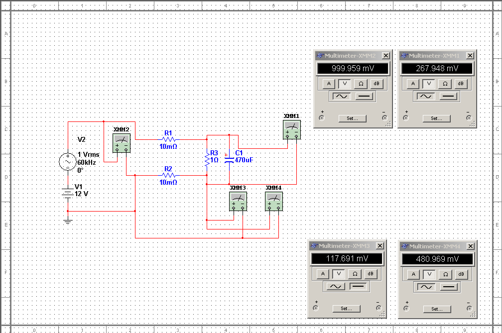

        1. Get the caps off the load resistors.
        2. Return the low side common from the load to the common (black) wire(s) from the output of the supply, not to the chassis of the unit under test.
        3. Connect scope probe gnd to case of PSU and probe tip to an unused wire from the same rail (under test) you want to measure:
        You want to measure ripple on +5. Connect load between one of your red wires and any black wire; connect probe tip to one of those red wires which does not have the load attached. Again, connect scope gnd to case. This puts scope gnd/common very close to the secondary common of the supply under test, and also puts the probe tip very close to the rail whose ripple you want to measure; you use one of the unloaded red wires (in the case of +5) as a "jumper" to go directly to the output of the supply.
        You also never connect the scope common to the return wire of the load at the load; here you have common potential rise, leading to common mode currents up the scope probe shield. That current goes thru the scope case, up the third wire of the scope, down the third wire of the PSU's line cord, and back to the secondary low side. This is an unwanted parallel path for testing; remember, this is secondary current (with ripple) going up your scope cable. Any AC component will couple into the center conductor. Depending on phase, it can give false indications of greater or lesser than actual ripple.
        The scope common must go to the lowest point on the secondary- either the case or an unused/unloaded "black wire" with a computer SMPS.
        In order to truly measure ripple, you cannot have any resistive elements (like loaded wires to resistor banks) before the point where you pick the sig off with scope.
        See example:
        M2= ripple at supply
        M1= ripple after being shunted by filter consisting of test lead/clip resistance (R1/R2), load resistance (R3), and the "lying capacitor" (C1) across the load
        M3= DC return potential rise- results in current up the scope probe cable shield
        M4= AC return potential rise- also results in current up the probe cable shield, but being AC, couples into the signal wire! A recipe for misleading/false "safe" ripple indications.
        All wire has resistance, and so has voltage drop while carrying current! This is true both at the load end of a "supply" wire, as well as at the load end of a "return" wire! See M3 & M4 again- the low side of the load is not at GND potential, but actually higher!
          Those are the Panasonic 2200's. You literally just told me doing this for testing was fine.
          You can't see it but there's two yellow wires. One shorts PWR_ON to the chassis and the other is +12.
          I already did the ripple check again and things have improved even with the wrong value caps.
          I just wanted to follow-up.

            Re: SPI ATX 350w refurbish
            No, that's not what I said at all.
            One- I never specifically said to put them across the load resistors- the diagram shows what will happen.
            Two- "try these caps for testing" means to solder them into the unit in question, even if temporary to evaulate how it responds, as has been done here and elsewhere.
            I don't know how you made that leap; it doesn't even make sense to do that, especially while leaving the old ones in place. Should've pulled the board, pulled the 3300/16v teapo, and whichever teapo on +5 before the pi choke, and replaced/subbed both with one of those panasonics.
