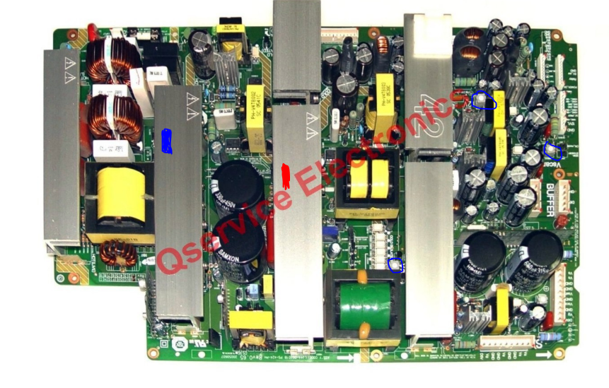

            Re: Philips 42pf5320/10 PSU
            This is the pic of my psu. The chassis of my tv is lc4.9e AA.
            The fuse I replaced is under the heatsink on the left (marked in blue). Although it could have been under the heatsink marked in red.
            I also circled in blue the 3 mini dials that I was talking about.
            I have no idea how to test for S/C.
              Hmm and do you get the Vs supply ? A fuse does not blow for no reason something cause it to go pop, normally the Vs fets blow as technically they take a shorted load on start up which strains them a lot.
                I do not know what the VS and VA voltage on this tv should be as there is no sticker on the unit to advise what it should be. Any ideas?
                  There will be somewhere, but Vs should be 210v or so and Va should be £60v or so.
                    Ok. I found what they should be and measured and they were a little out. I adjusted the mini potentiometers and got voltages correct. Buzzing has quietened down a bit. I noticed when i disconnect the main av board from psu, the psu stays on.
                      Just a quick update to say my TV is back working. Thanks you Reecey for pointing me in the right direction by checking VS voltage. This helped me discover that the little dials on the psu were to change the voltages of the vs and va supply. After correcting these voltages and leaving the TV unplugged for an hour, it turned on no problem with no buzzing.
