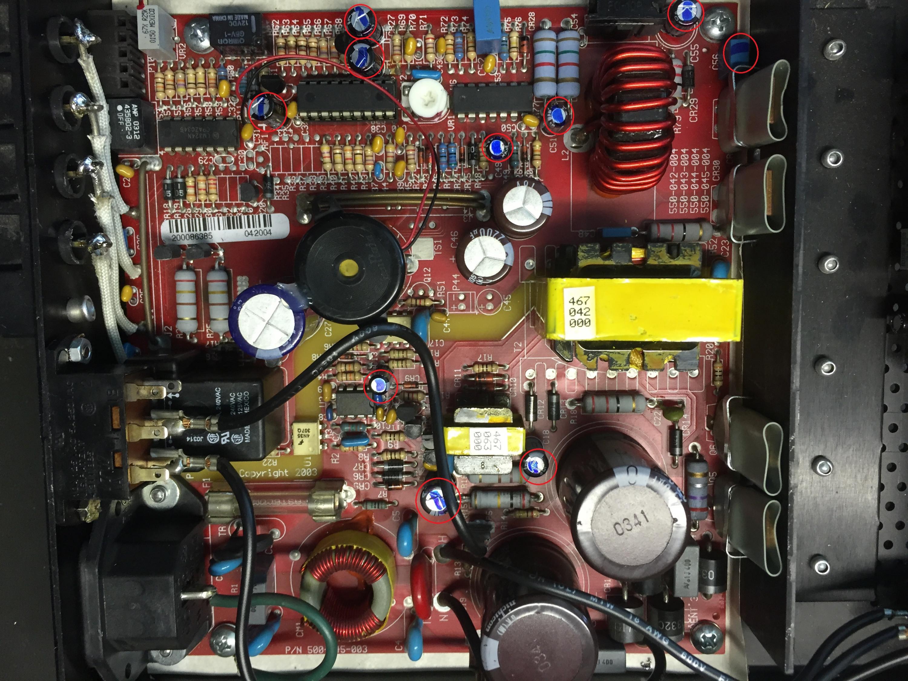

    I had a ICT2012-12BC charger series PSU here on my bench that didn't want to turn on. The light inside the on/off switch worked, but the rest was dead as a door nail. This PSU has a digital display and it needs to boot for a few seconds before it turns on.
    Replaced:
    C13, C15, C18, C33, C35, C36, C49, C51, C55 electrolytic capacitors.
    C56 (very top right corner)is a film capacitor 63V, 1uF. It was blown wide open on this one.
    I also replaced the 2 capacitors on the display board (not shown).
    Problem taking it apart is that almost everything is riveted to the chassis. I ended up drilling out 2 rivets from the 115/230V switch on the back, in order to take the board out. I replaced the 2 rivets with screws, washer and nuts.
    All small electrolytic capacitors mentioned above, were either really toast (over 20 Ohms ESR), or not far from it being bad. Needless to say: Another one saved from the junk bin!

              The original caps in that PSU were all Nichicons KME series that failed or close to fail. PSU has a 2003 stamp on the board.
