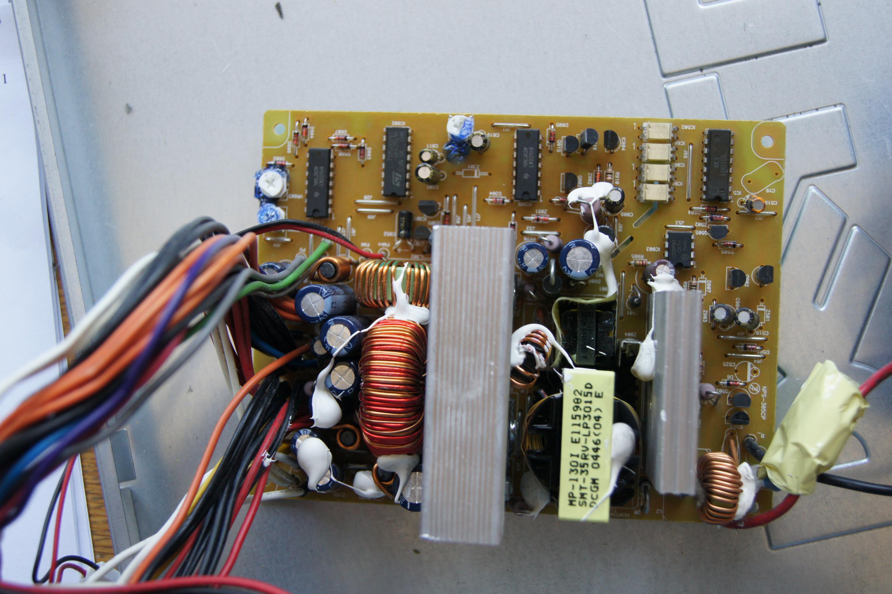

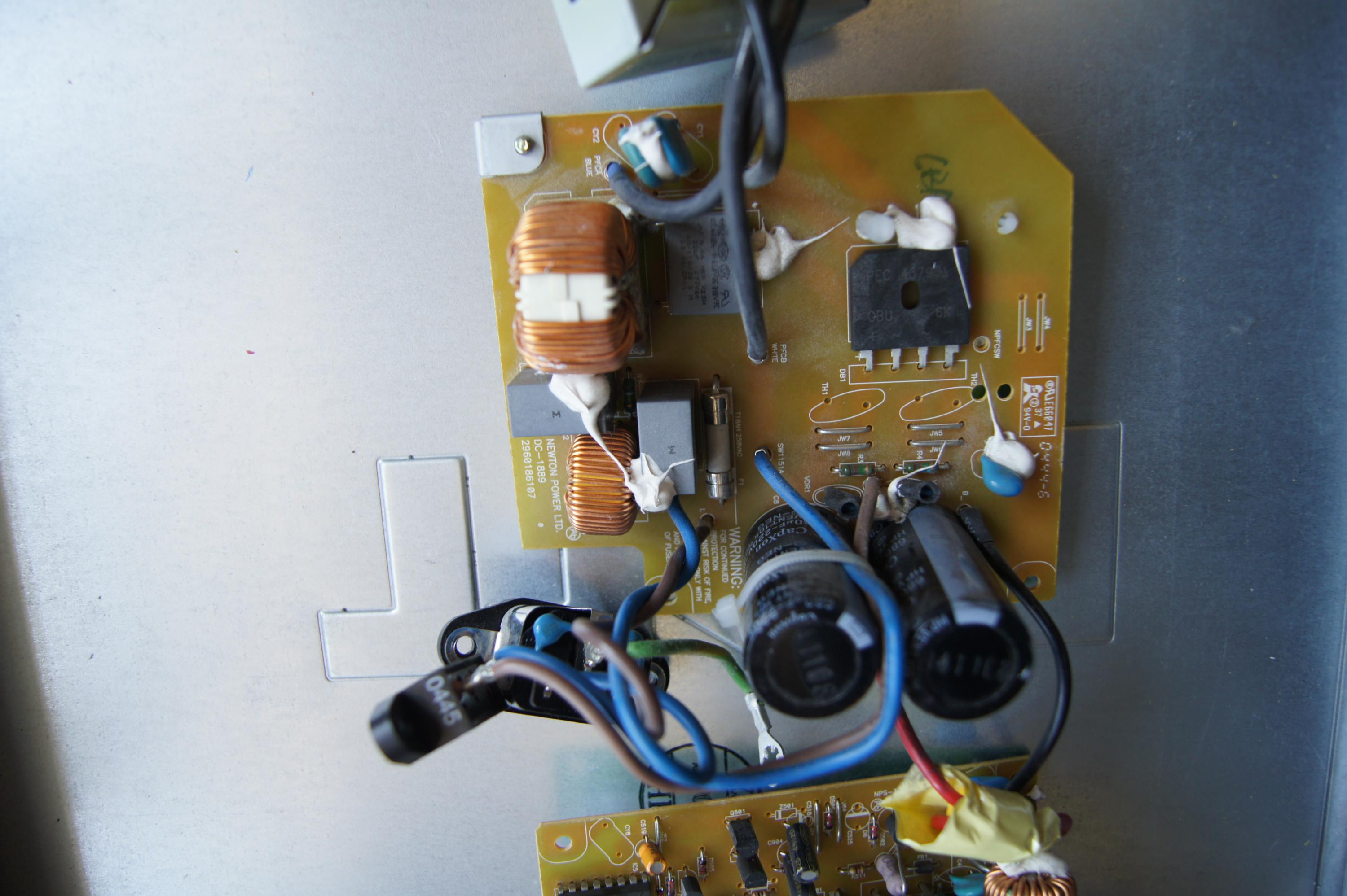

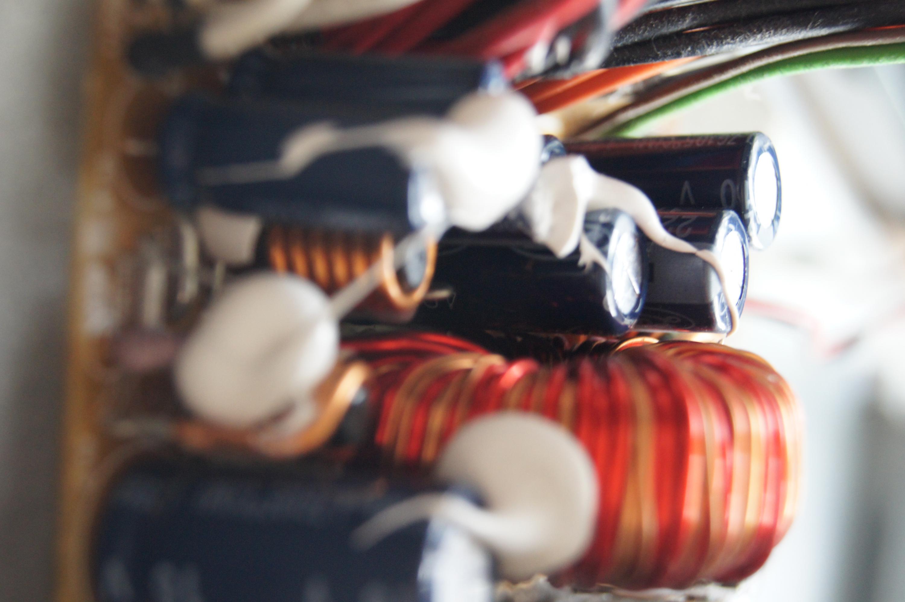

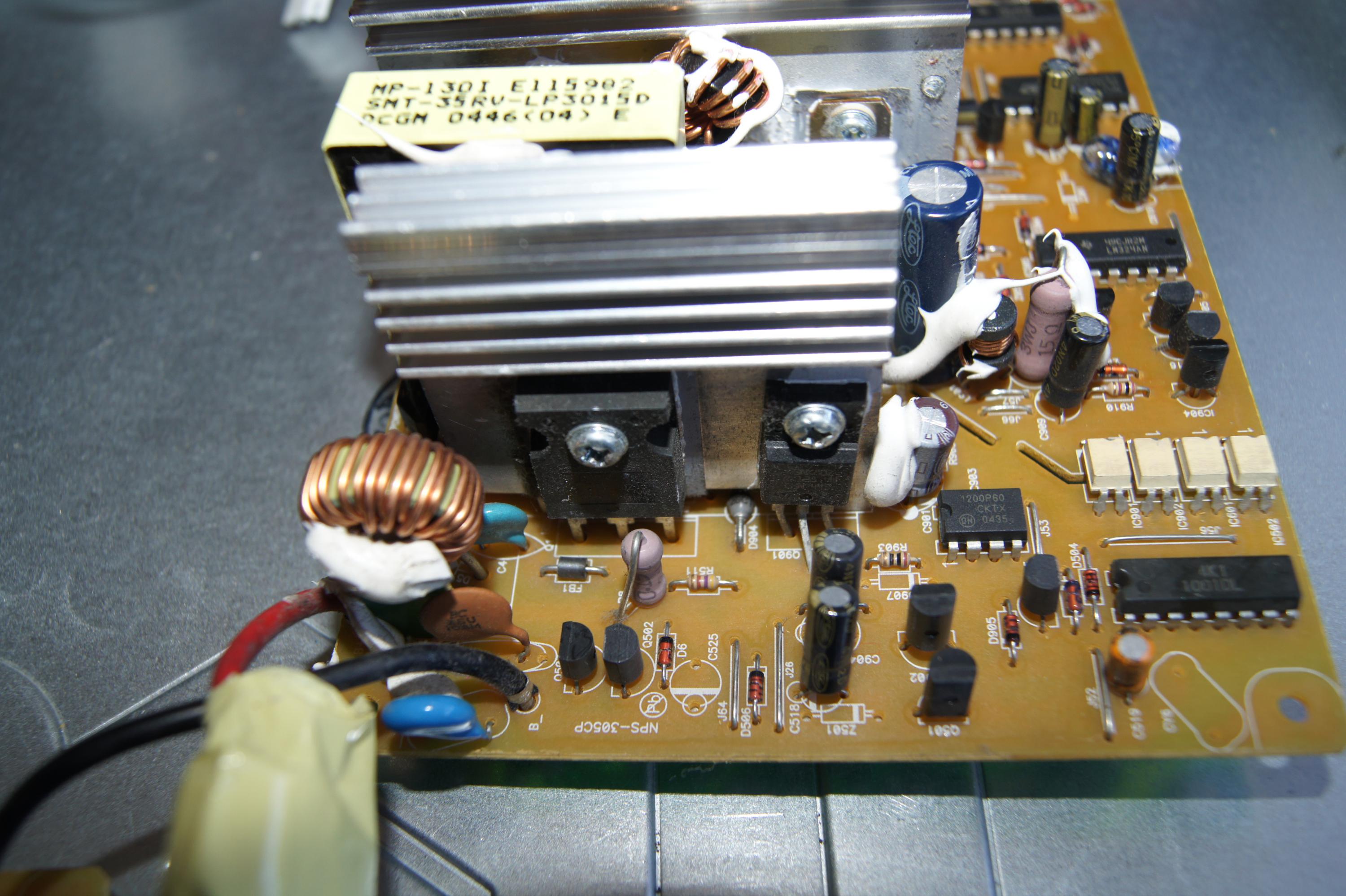

      Re: NPS-305CB from Dell Dimension 5000 "dead"
      Here are various views of the controller circuit board and the mains input circuit board:
      Regards, Richard
        Is it me or are some of the Ltec caps bulged slightly?
        My guess is that there is a bad capacitor or two somewhere.
        The PSU won't start because faulty electrolytic caps will have high ESR when cool, and it will be lower when hot/warm.
        You could try heating the board with a hair dryer to see if it will start working again. Just make sure not to get it too hot, or you'll pop the capacitors XD (Though, they have to get over 100C to make them pop on you...)
        Commonly it's the little electrolytic caps that go bad and cause this.
        But yes, it certainly could be caused by something else.
        Just, seeing the Ltec caps in there makes me suspicious that one might be bad.
          Doing a might bit of research, the NPS-305CB is a unit that has a fan at the intake rather than at the exhaust, and possibly a PPFC. So those capacitors might have been under a bit of thermal duress. The primary CapXons and LTEC capacitors are indeed suspect, but more so the smaller, GP ones as Ben said. Those smaller LTECs, akin to the smaller Teapos, have a penchant for silently drying out over time. Are you getting +5VSB? Do you have a digital multimeter or ESR meter? You'll need certain tools to check the secondary rectifiers and bridge rectifier for shorts (and the other primary components), the condition of the capacitors, etc. I don't think those LTEC are bulging. If even a bit of hydrogen gas was present inside, there would be slightly more pressure at the top (or bottom). That doesn't mean they can't be bad without showing it, though. Also, "bad" capacitors could bloat under 100*C.

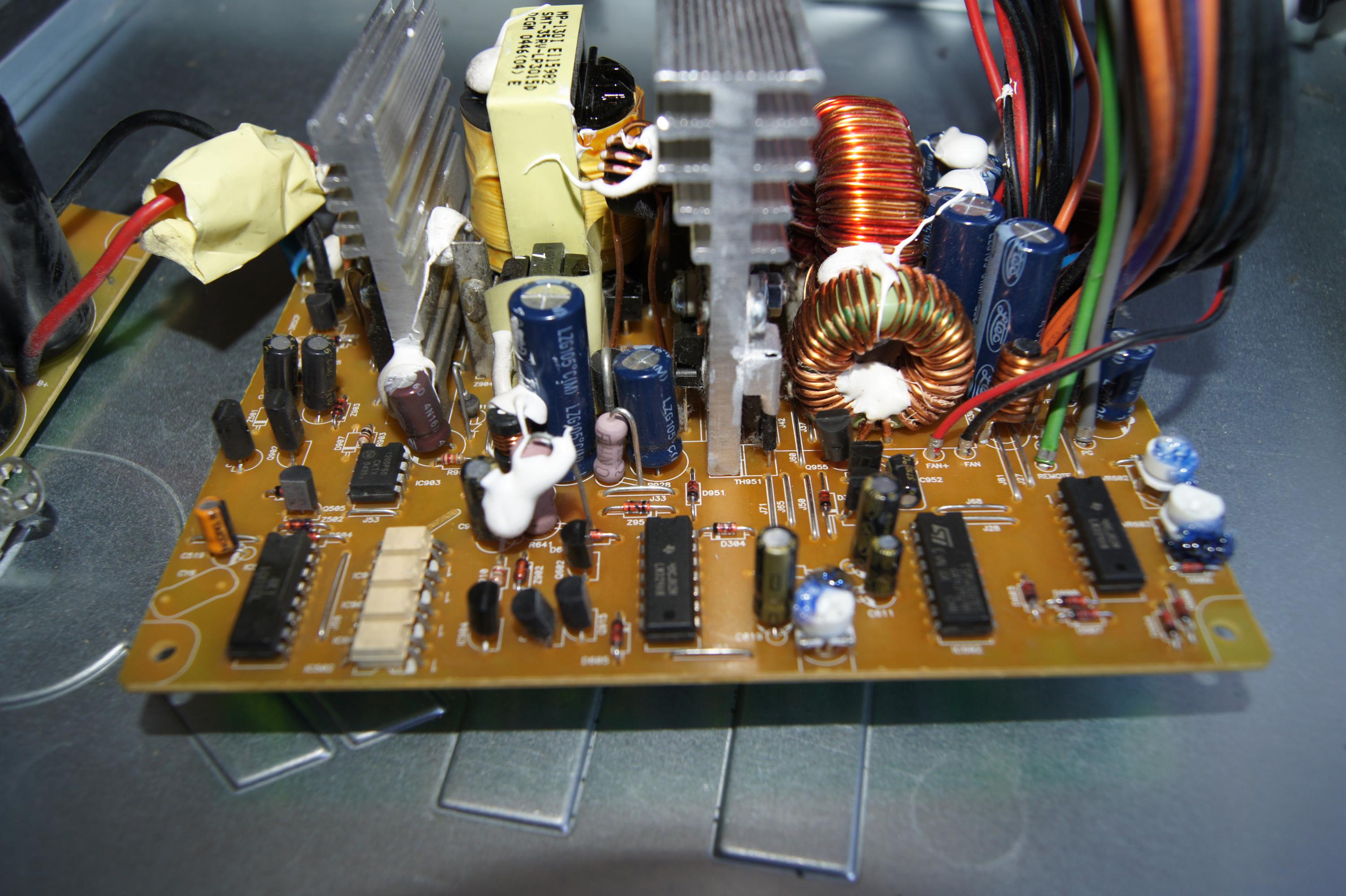

                            Originally posted by RG34
                            1. Following the suggestions of Wester547 and Momaka, I checked +5V SB (pin 9) and found +5.05v (also found +4.68v on "power on" (pin 16)). So as it seemed to me that the SMPS might now be OK, I reconnected the dismantled psu to the mobo etc. and the PC powered up! I'll now reassemble the circuit boards and fan back into the psu housing, refit in the PC tower cabinet and see if my luck continues....
                            That's a poor practice. Problems rarely go away or magically fix themselves.
                            You should have at least recapped the LTec caps on the 5 VSB circuit. Ben7 is correct - the tall LZG does appear to be bulging a slight bit in the picture. And even if it isn't, it is still good to replace it with something reliable, because cheap cap brands regularly fail on the 5 VSB rail.
                                  However, as ever, it's a matter of priorities; I'm making the 2006 Dell Dimension 5000 redundant and just need it to stay alive with minimum effort for about 1 week whilst I extract data from it.
                                  I see.
                                  In that case, don't wait too long to back up the data.
                                  So what brand of capacitor should I buy here in UK in place of the, allegedly crappy, Ltec brand?
                                  Nichicon: PW, PS, PM, PV, PJ, HE, HD, HW
                                  United Chemicon / UCC: KY, KZE, LXV, LXY, LXZ, KMY, KZH, KZM
                                  Panasonic: FC, FK, FR, FM
                                  Rubycon: ZL
                                  I think that is a good amount of choices there. The ones in bold are the closest in specs to Ltec LZG.
                                  BTW, here's a photo of the capacitors which I think you referred to as associated with the 5VSB line:
                                  Nope. The caps for the 5 VSB line are right in the center of pictures 2 and 3 in post #3 above. Near the yellow transformers in the middle.
                                  PS Is it OK to scrape away the bits of white gunge that's splattered over various components of the psu? What's the purpose of this stuff?
                                  Yes, you can remove it if it's in the way.
                                  It's glue to hold down the components when the PSU was manufactured.
                                  • TELVM
                                    • Oct 2012
                                    • 547
                                    • Spain
                                    ^ I think those four caps at least are on the standby circuit. The IC marked 1200P60 is the standby PWM controller. The '3' and '4' Ltecs are the +5VSB output filtering caps, replace them as per Momaka above. For '1' and '2' I believe you can use any decent 105C general purpose caps of same uF and equal or higher voltage rating.
                                    Momaka will correct me if I'm wrong.

                                      • RG34
                                        • Oct 2015
                                        • 18
                                        Thanks TELVM for labelling my psu photo so beautifully and informatively!
                                        Originally quoted by stj: 1 is probably your startup cap for the standby supply btw - look at how the bastards put it next to a heatsink! i'm sure they do that shit on purpose.
                                        Probably not on purpose, that would require some forethought; more likely poor layout design or time pressure to get the design to market :-)
                                        Richard
