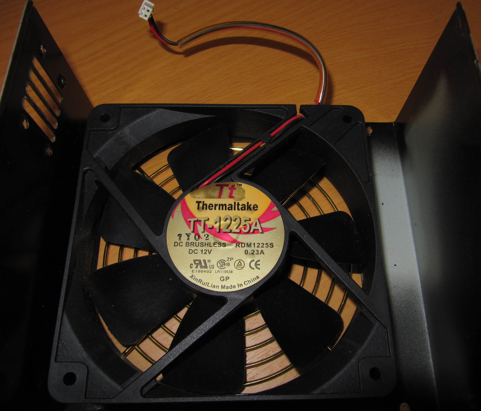

    Also, I don't know if anyone has told you before, but your pictures are absolutely superb! Always in focus and show great detail.
    By the way, if you find a busted CRT TV on the side of the road or next to a dumpster, open it and take its boards. Those usually have small SMD and regular through-hole resistors. Personally, I like the SMD resistors, because they are super-easy to solder on solder-side traces. So with that fan mod you did, you could easily have fit a small 3.3 KOhm SMD resistor on those adjacent traces. It ends up looking like factory-installed .
    Not that there is anything wrong with your soldering. Just mentioning this if you want to try something new .

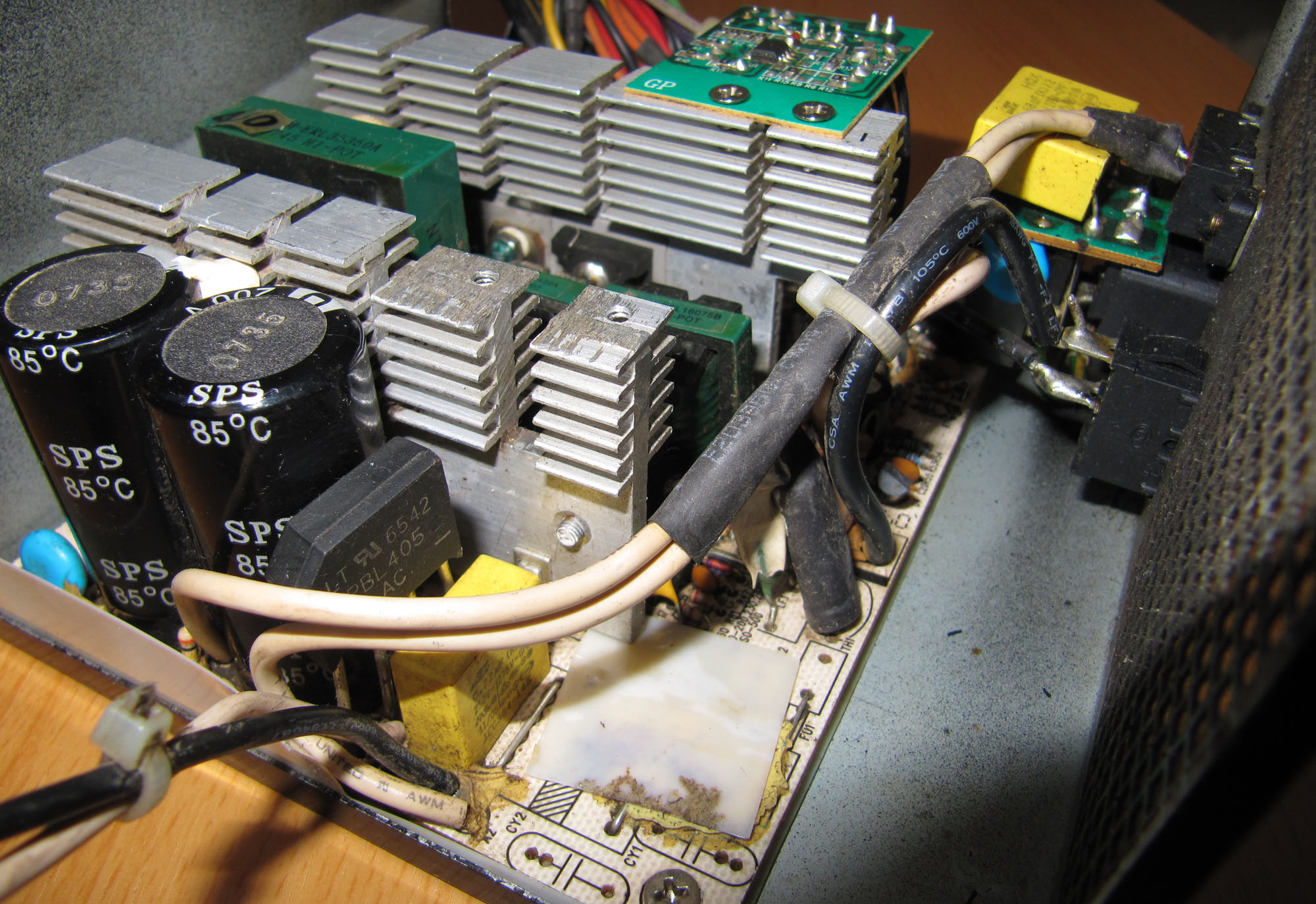

        I got another TR2-420 for free recently.
        5vsb is ok, but after shorting green wire to black nothing happens, not even a slight move of the fan.
        The cap selection is a mixture of Jun Fu and OST, some of them bulging.
        I am going to fix it.
