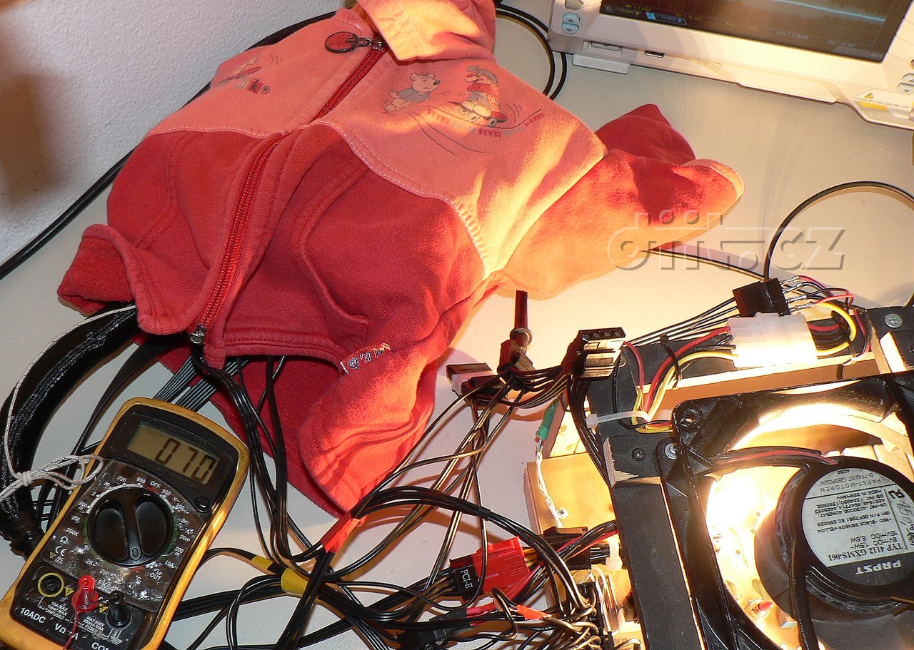

Looky! Pulling 522 watts from the passive thing while being dressed and it is still not reaching 80 °C on secondary heatsink after 10 minutes. My equipment shows over 96 % efficiency…

That's my load tester, upgraded over time. It houses 13 lamps actually and over 200 W in resistors.
It finally turned off at 85 °C after 25 minutes like thisLess jewellery, more gold into electrotech industry!Half of the computer problems is caused by bad contacts
