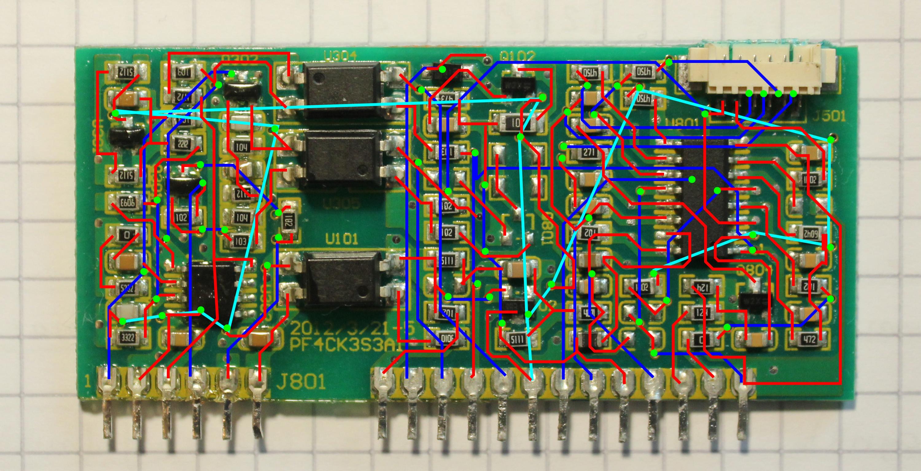

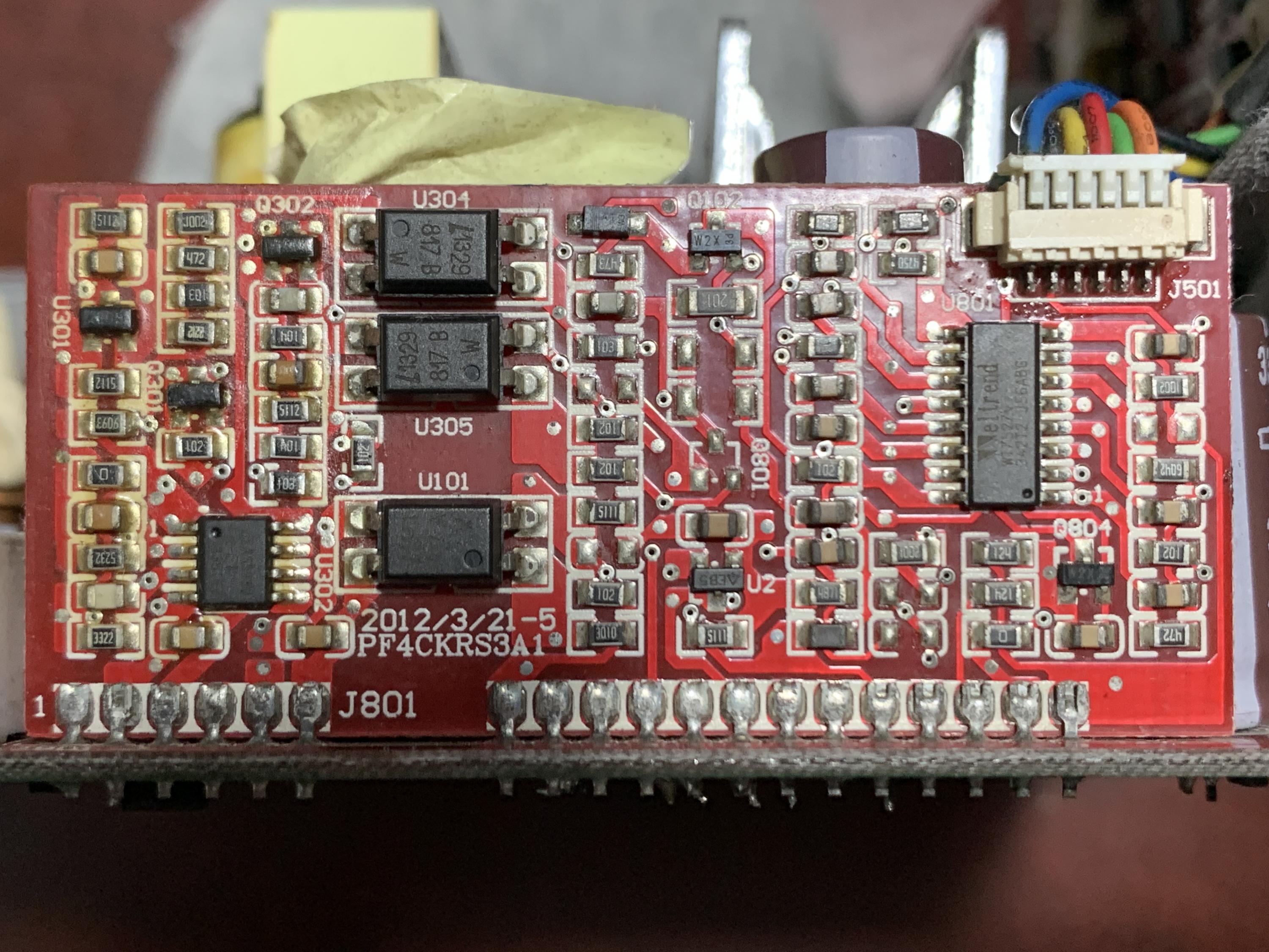

        Too bad that guy didn't finish his schematic of the little side board. It's in Photoshop and I couldn't open it in Gimp. Or know the IC markings.

          I believe, its the same just different pcb color
