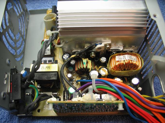

Dell (Liteon) PS-6311-1DS 2005 power supply.
    Please don't throw rocks I am new to computer power supplies.
    This is a working Dell Liteon PS-6311-1DS out of a Dimension 4700 that was working.
    My question is are there common failure caps in this Power Supply that need to be replaced?
    So far I have found a 22 x 50v reading 3 ohms and a 2.2 x 450v reading 5 ohms and cracked solder joints on the GBU808 bridge rectifier.
    Thanks for any help
    Ron.

    Mainly the OST and Ltec capacitors are likely to go bad.
    In general, the caps that are on the secondary side should be replaced, I'm talking about the larger ones, like 1000uF to 4700uF (if there are any that large capacitance wise).

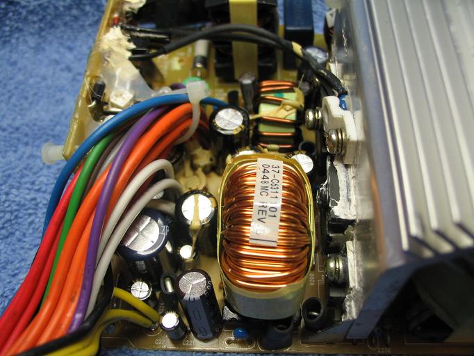

    Also, replace all the capacitors in the 5V standby and the capacitors in around the transformers, between those two heatsinks.
    I had one of these (or at least it was very similar) with both primary side caps bulging a bit, they were OST, so, go figure... replaced them with american made capacitors
    Muh-soggy-knee

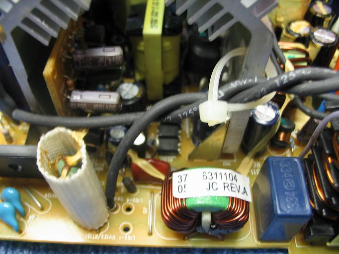

      How can I track down the 5v standby caps?
        Re: Dell (Liteon) PS-6311-1DS 2005 power supply.
        Originally posted by ron350 View Post
        Ben7 thanks for the help.
        just follow the +5V STBY cable line reverse back, you will found it.
        "There is no shortcut to be successful. No pain, no gain."
        Best Regards
        Rudi
        Thank You
          Thanks senz 90.
          I followed the purple wire and it is marked 5VSB on the board.
          There is only one 470 x 10v cap on that line, that I can see. Guess I will replace all the cps on the board I can.
            I recently repaired a Dell\Lite-On PSU, All the OST capacitors were bad except for one and the primaries (and only one of the bad OSTs was slightly bulging!)
            The LTecs were still OK but I would replace them anyway. Two Taicons buried near the heatsink were marginal.
                Agent 24 you are correct.
                I can see two small 2 tan color Taicons on the vertical board between the heat sinks and another hiding in the wire jungle.
                Can I ask how the Ost caps and other power supply caps usually test bad; low value, high esr reading or what?

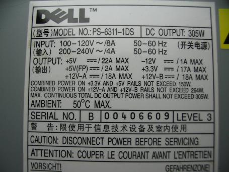

                    I've got a Lite-ON 6301-08A, but it is too different from yours to tell you exactly what caps to change... My unit has all OST RLP series caps. Similarly enough though, I've also got the small 10mm 450V 2.2uF cap near the primaries, but mine is stock UCC KMG series.
                    What you need to do is make a list of all the caps in the PSU in the following fashion:
                    Code:
                    1) xx Volts, xx Microfarads, xx Millimeters Width * xx Millimeters Height, Brand, Series
                    Also, can you post of a pic of the PSU label? I'm curious to see the rail ratings on your model. Mine has two +12V rails, one with 10A and the other 13A. Would love to see the ripple on those rails though, because the 12V rail capacitance is some of the weakest I've seen value-wise.
                      Large capacitors on output side.
                      1-470 x 25v @ 8 x 20mm Ost RLP
                      1-680 x 16v @ 8 x 20mm UCC KY
                      3-2200 x 6.3 @ 10 x 20mm Ost RLP
                      1-2200 x 16v @ 12 x 20mm Ltec LZP
                      1-3300 x 6.3 @ 10 x 25mm Ost RLP
                        Thanks for the picture of the label. Looks like your revision is newer than mine, namely because it has more powerful 12V rails.
                        1) 613750
                        2) P12378-ND
                        3) 493-4852-1-ND
                        4) 565-3368-ND
                        5) 1189-1466-ND

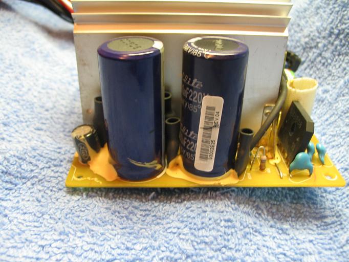

                        Please post the rest of the capacitors. All of them must be changed, except for the two large primary capacitors.
                          I think this is all of them.
                          On the large output caps why did they use 2200 instead of 3300?
                          1-2.2 x 50v @ 5 x 12mm Taicon VT
                          1-2.2 x 450v @ 10 x 12.5mm Ltec TY
                          1-4.7 x 50v @ 5 x 11mm Taicon VT
                          1-10 x 50v @ 5 x 11mm Taicon VT
                          4-10 x 50v @ 5 x 11mm Ost RLG
                          1-100 x 25v @ 8 x 11mm Ltec LZV
                          1-120 x 16v @ 6 x 11mm Ost RLP
                          1-470 x 10v @ 8 x 12mm Taicon HG
                          1-470 x 35v @ 10 x20mm Ost RLS
                          2-680 x 220v @ 22 x 48mm Elite GM
                          2-1000 x 10v @ 8 x 20mm Ltec LZP
                          1-2200 x 16v @ 12 x 20 Ltec LZP
                          3-2200 x 6.3v @ 10 x 20mm Ost RLP
                          1-3300 x 6.3v @ 10 x 20mm Ost RLP
