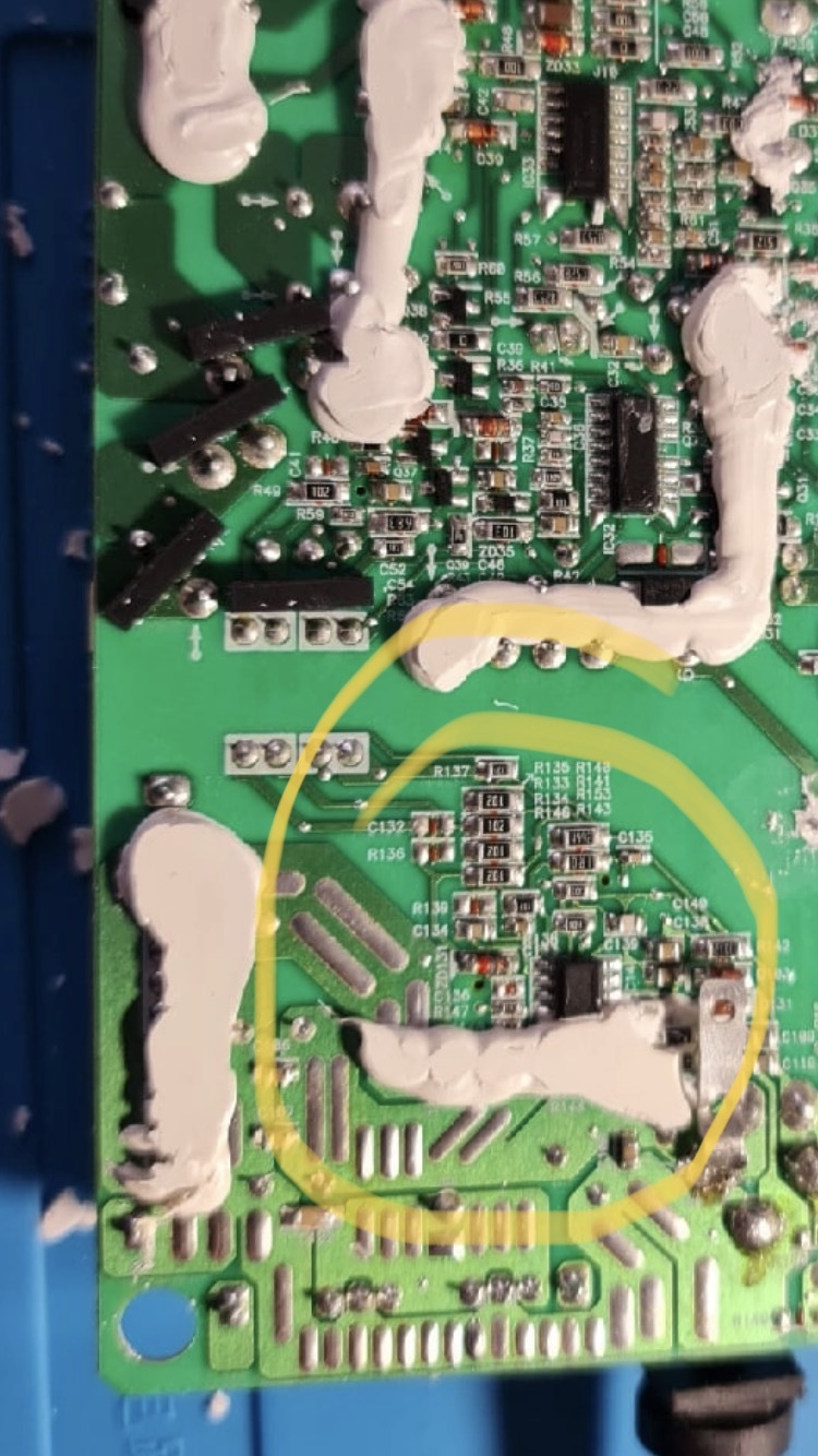

    There is an old, but working laptop PSU Toshiba pa3717e-1ac3. It outputs almost 20V with 6.32A. The task is to make giving out 24-26V with not less than 3.5A.
    It is built on the attached Click image for larger version  Name:	Toshiba.jpg Views:	5 Size:	140.3 KB ID:	3251557 PWM
    To me it looks like DAP019D, but I only was able to find datasheet for DAP018D - https://pdf1.alldatasheet.com/datash...I/DAP018D.html
    According to that datasheet, it does work with up to 28V. However, I am not sure how to make that happen, and still unsure with assumtption that this will apply to DAP019D.
    Please, recommend the simplest course of action.

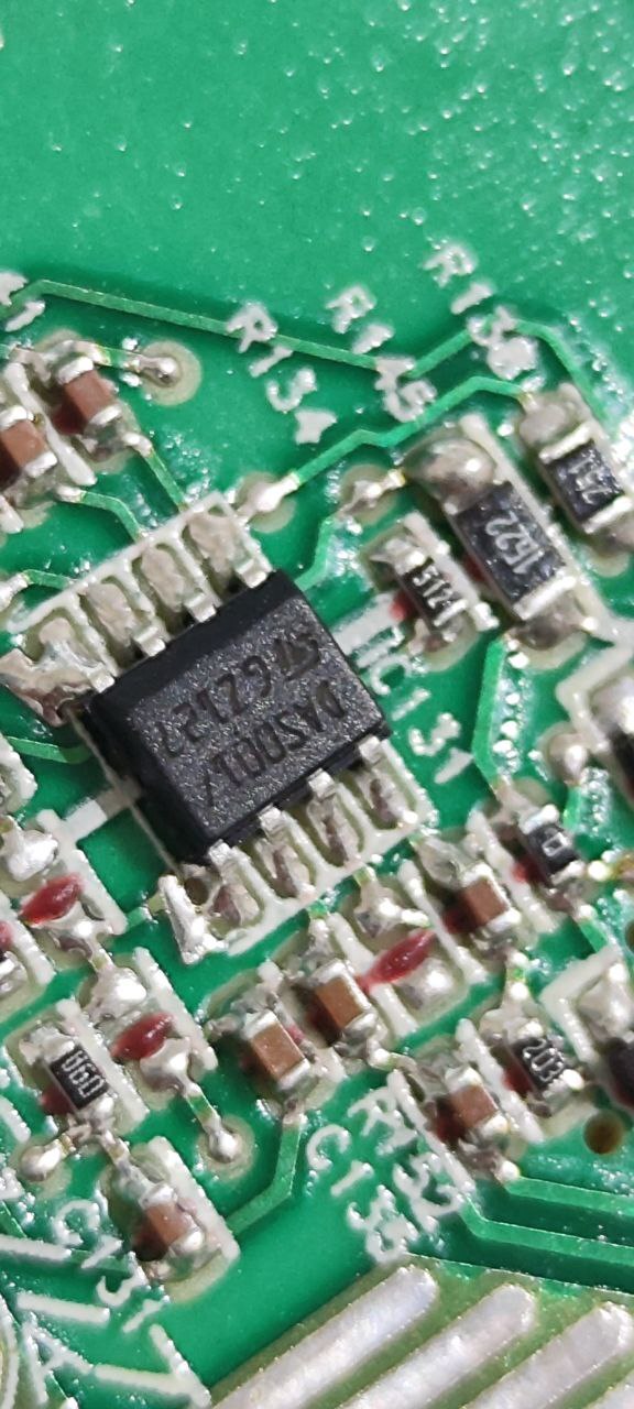

    Hi, what's the chip here? Click image for larger version

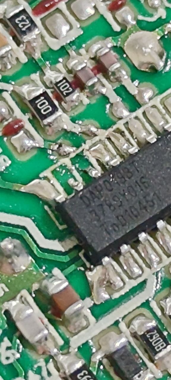

        The output capacitors are 25V/1500, but there is some space to install bigger ones, so it's not an issue.

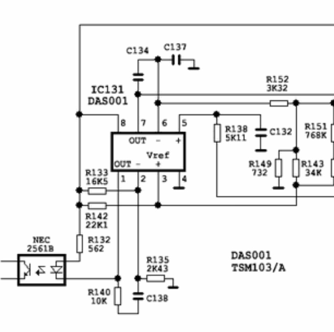

          The output voltage is regulated by changing the values of the resistors by 2 pin DAS001

            R135 is 2kohm, R133 is 121.5 ohm or its not clear which one is that. Should I replace R135 with lower resistance or higher? Would only R135 be sufficient ?

              Youtube made a miracle and suggested a video where my question was well-explained https://www.youtube.com/watch?v=yxNY-iYaok0
              I need a 20kohm resistor. Unfortunately, in the video the psu was unable to output more than 1A after been modified to 24V. Any ideas?
                • 31037
                maybe the controller has overvoltage protection or something - time to read datasheets.
