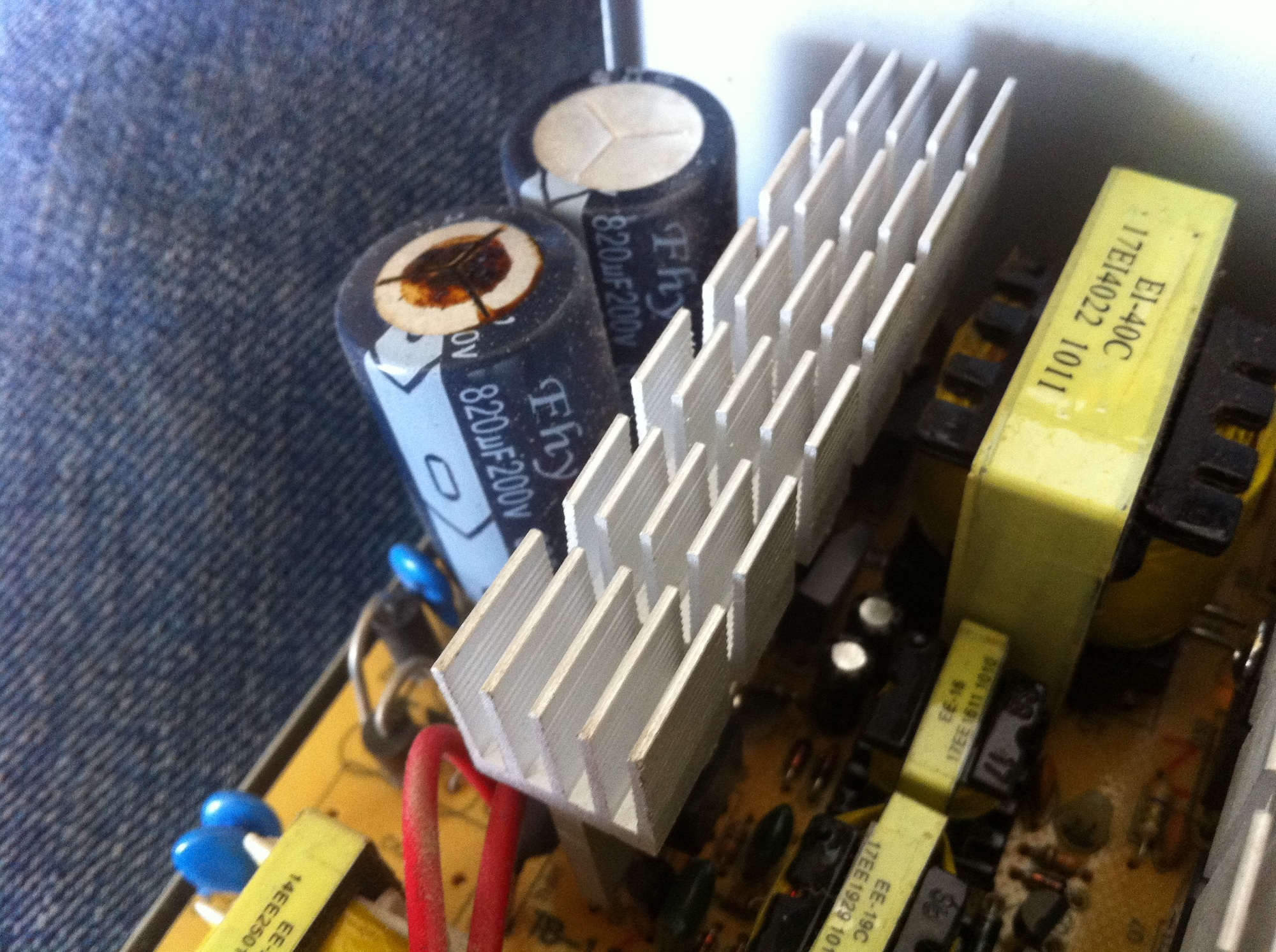

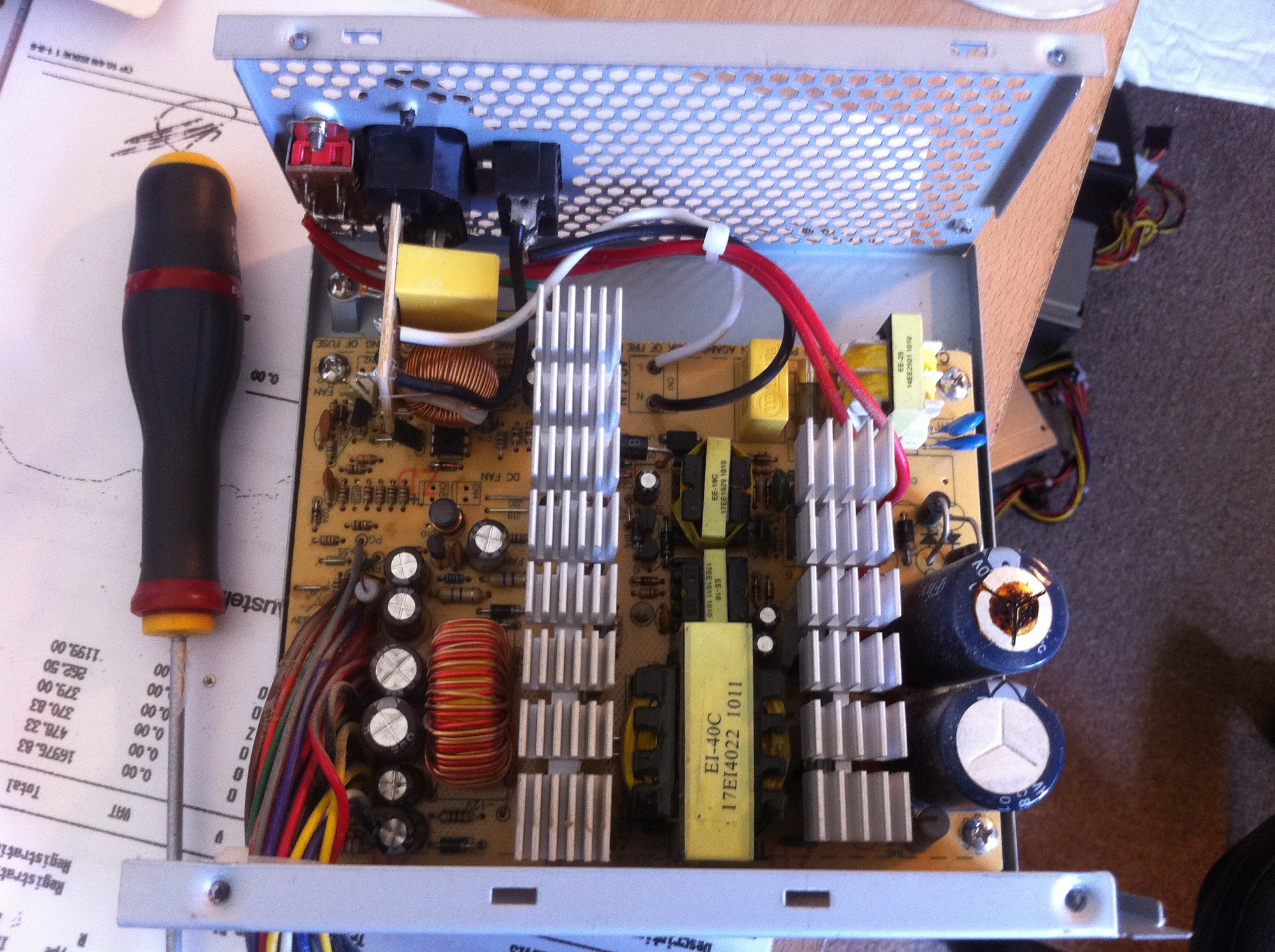

    Got this lovely example of PSU quality in a PC after there was a bang and a smell... It's a CASECOM ATX 400W. When I saw the leaking primary cap I was very surprised...
    Until I realised they are only 200V caps! We're in the UK on 240V.
    Annoyingly this thing also took out the PC's motherboard :-(
    Wonder how many more of these things there are out there!
    ETA: I just wondered whether it was me being dumb and there's some sort of step-down transformer or something in there but I don't think so.

    There's TWO capacitors, the voltage is split between them.
    The AC voltage is rectified, so it becomes 1.414 x 240 = 340v so each capacitor will get about 160-180v

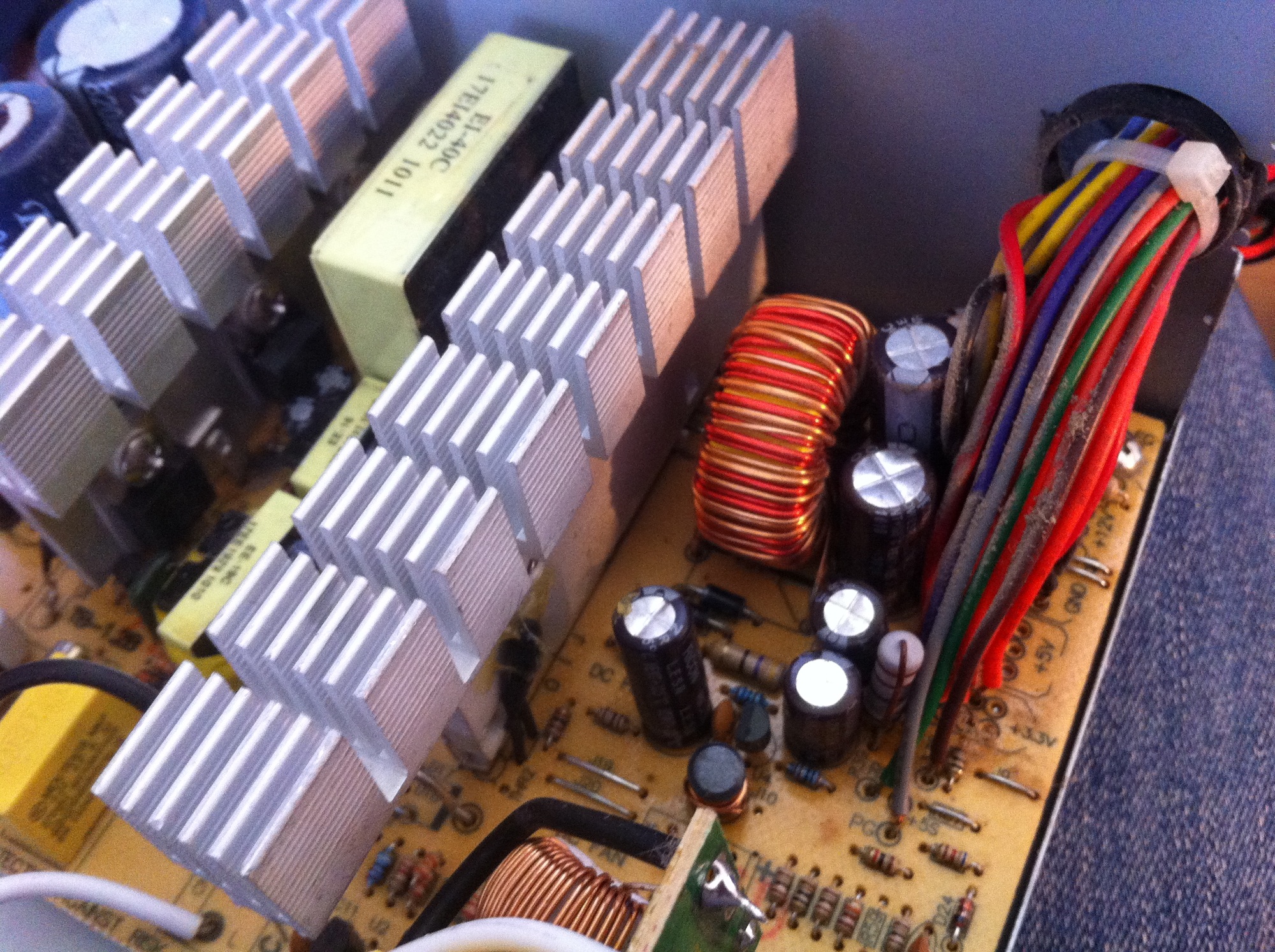

    It's not those capacitors that killed the board (though they really didn't help), it's the small capacitors on the secondary side and the lack of filtering (pi filters aka inductors and capacitors) that killed the board.
    The psu is a 250-300w at best, so no wonder it can't handle modern systems that need a lot of power on 12v.

      Re: Stupid PSU design FAIL
      Should be thread FAIL then ;-)
      You learn something everyday... wasn't aware caps were used in series.
      Will look elsewhere for the problem - cheers!

              The balancing resistor across that capacitor probably went open circuit, causing an over-voltage on the capacitor.
              Anyways, I doubt they are 820uF!
