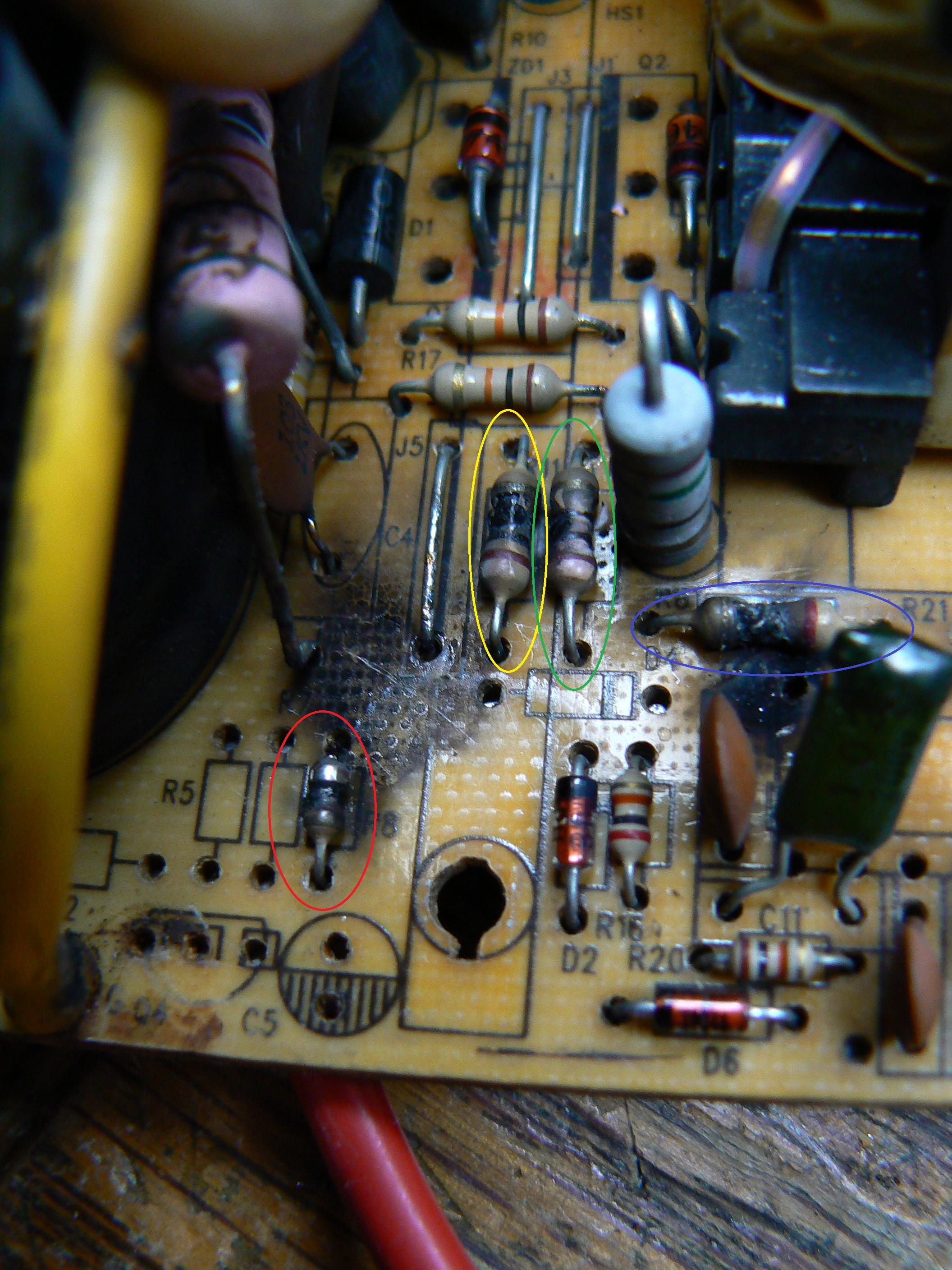

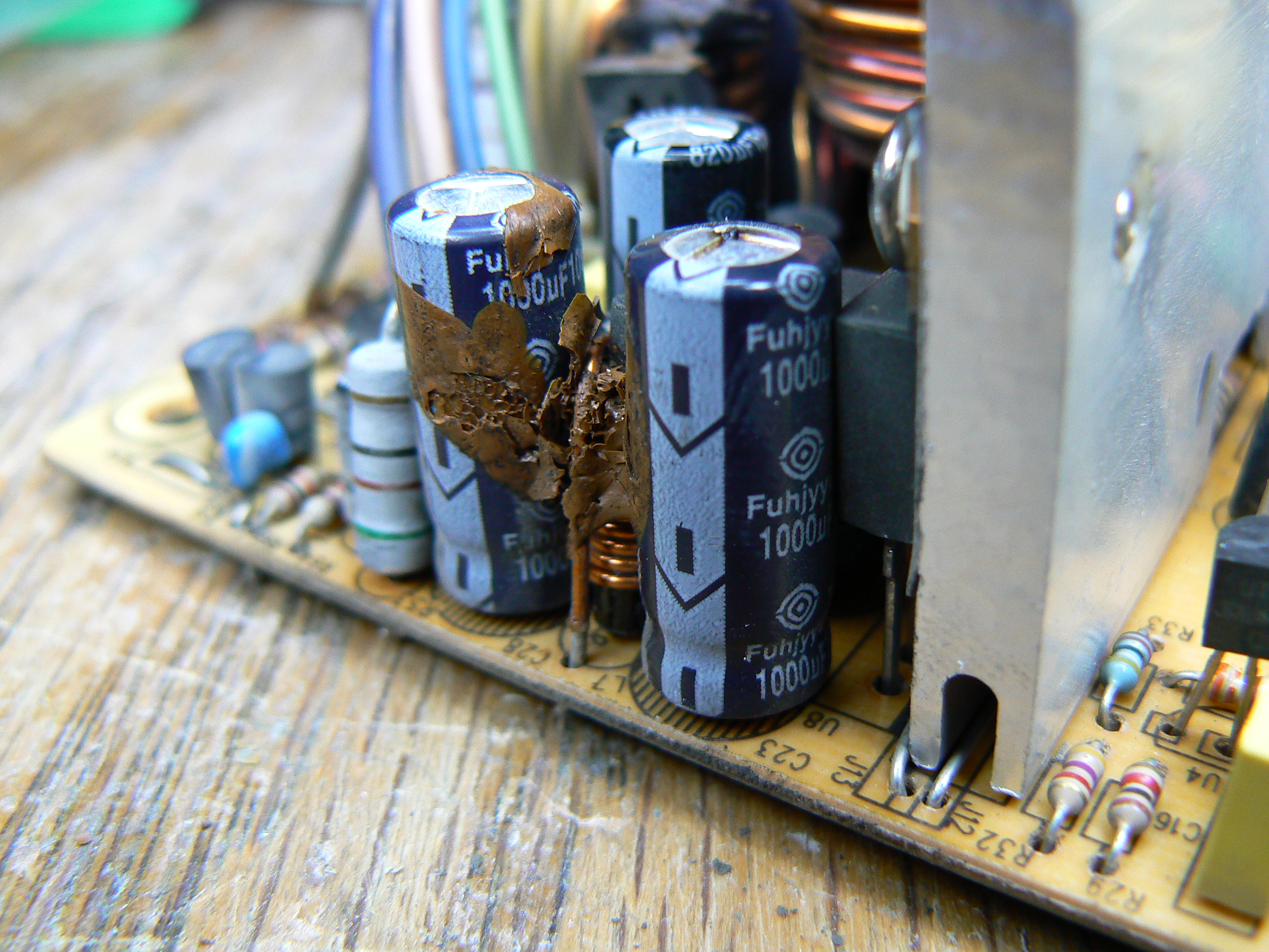

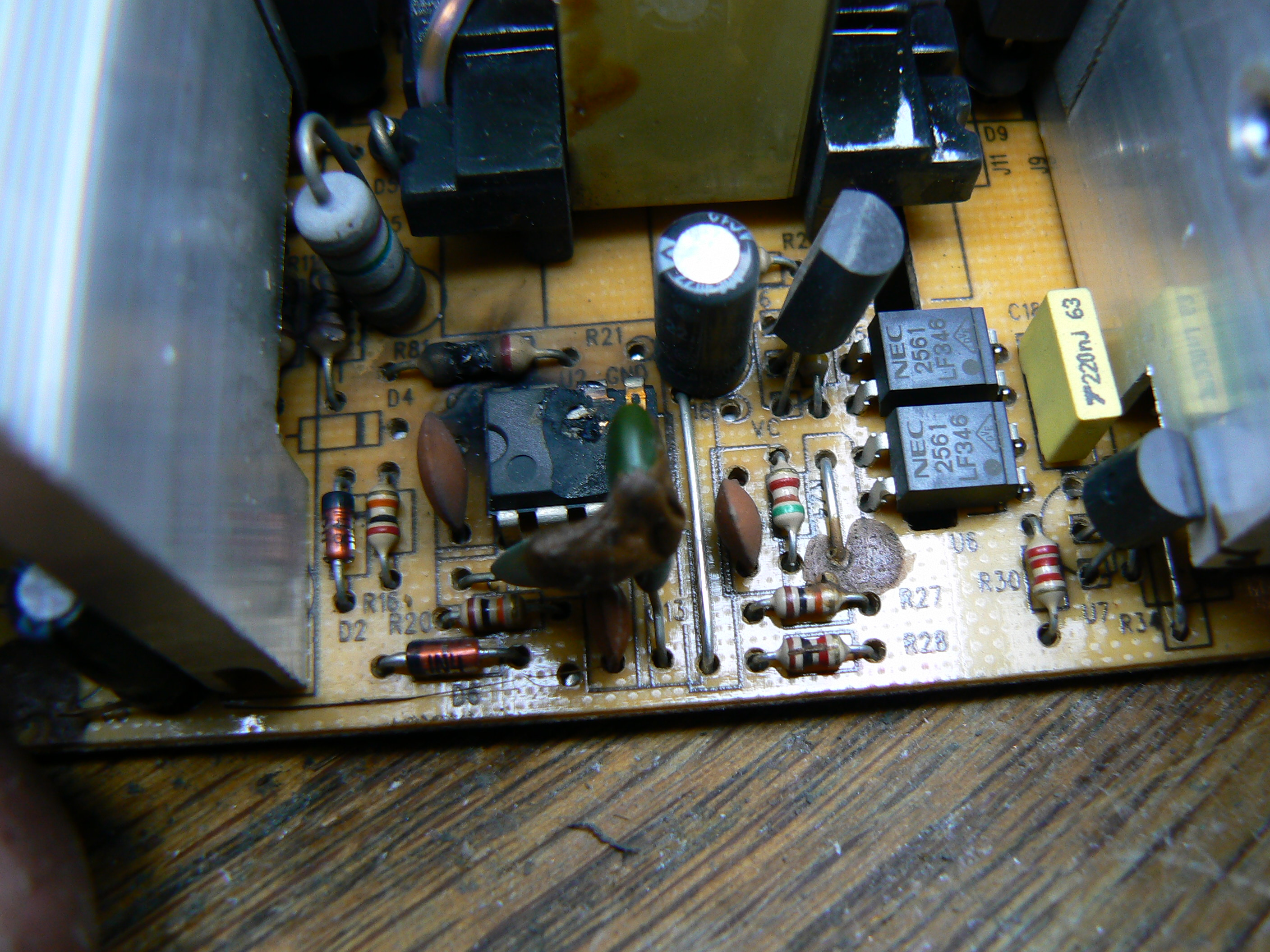

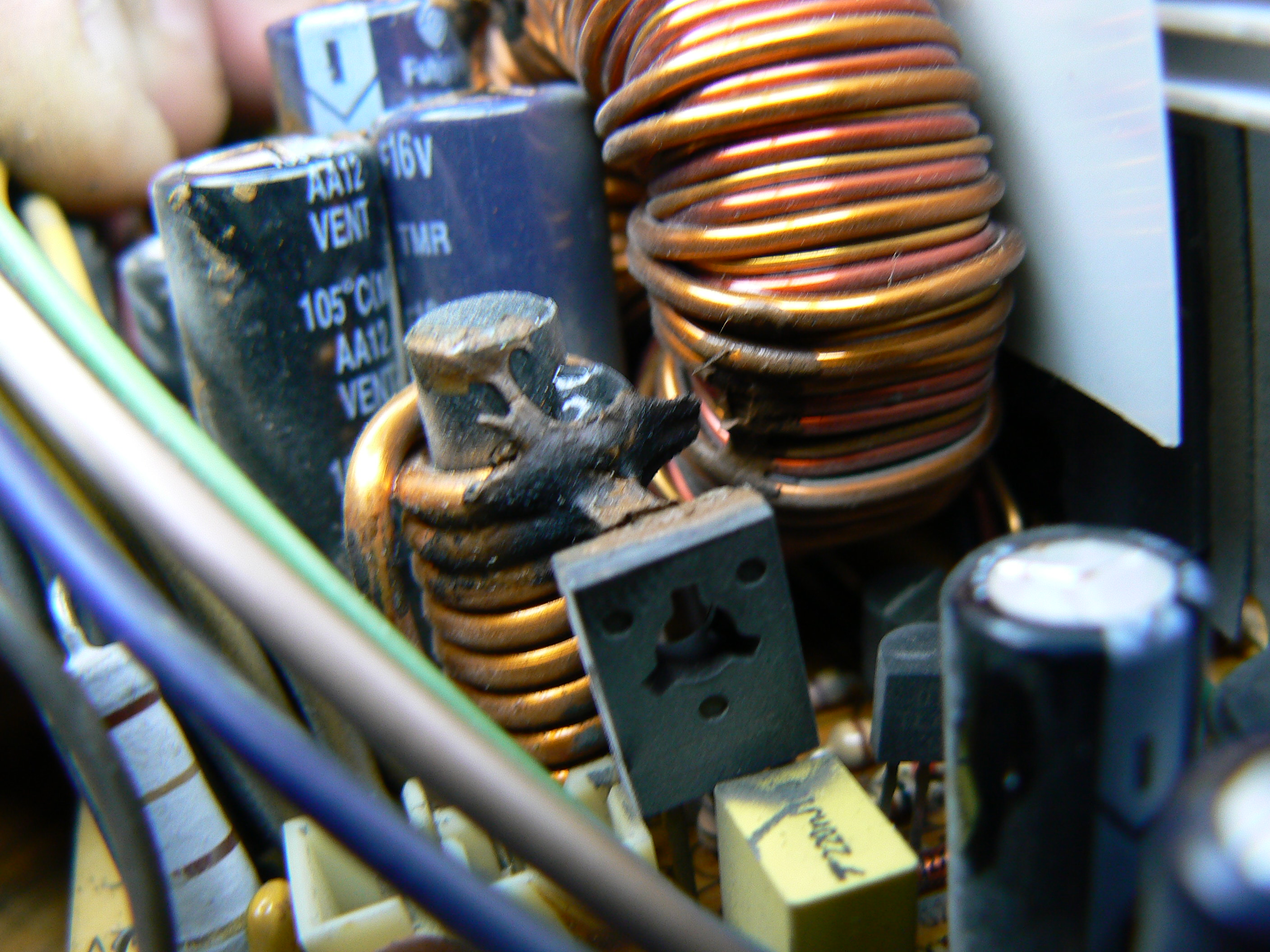

    I am attempting to rebuild an Antec SL-400 and it has a few burnt resistors and I am having trouble identifying their values. I am hoping that someone on the forum has one of these supplies or its' near relatives and would be willing to see what theirs have in the same locations.
    In the attached picture I have circled the four resistors I need to identify. I think I know the correct values of three of them but I am not 100% on those and the fourth I have no idea.
    R8 which is circled in red is the one I have no clue to its' value. I think the two resistors circled in yellow and green are both 10 ohm resistors. The resistor circled in blue I think is a 22 ohm resistor.
    If anyone could tell me what the value for R8 is supposed to be or if I have some of the other values wrong I would be very appreciative.

      Re: Antec SL-400 burnt resistors' values
      Red circle 1000 ohms R8
      Blue circle 22 ohms half watt R21
      Green circle 10 ohms half watt R13
      Yellow circle 10 ohms half watt R11

        Thank you very much for this information, it will help me out greatly.
        Now the problem I have is that I do not have a 22 ohm resistor on hand. I do have a 27 ohm resistor or I could use two 10 ohm in series, any thoughts on this and how it would affect the operation of the supply? Would one or the other be good enough to get it up and running?
        These resistors (and some soldering) are the only thing holding me up from applying power and seeing what happens. I am hoping I have found and replaced all the other bad parts but there is only one way to truly know. I would like to test it out when I get home tonight, if I have time.

          Rummage through your parts bin for a 22 ohm resistor, or look on parts'd circuitboards for them too. 22 ohms is RED-RED-BLACK
          Other option is two 1/4 watt 47 ohm resistors in parallel. That will give about 23.5 ohms, close enough

            I have an Antec TruPower 330 watt psu which is almost identical to the SL400. It uses a 10 ohm resistor in that location. So my opinion is that anything between 10 and 22 ohms will do just fine.
            Old proverb say.........If you shoot at nothing, you will hit nothing (George Henry 10-14-11)
              If it goes to the gate of a FET, the only consequence of a lower value is potentially greater EMI.

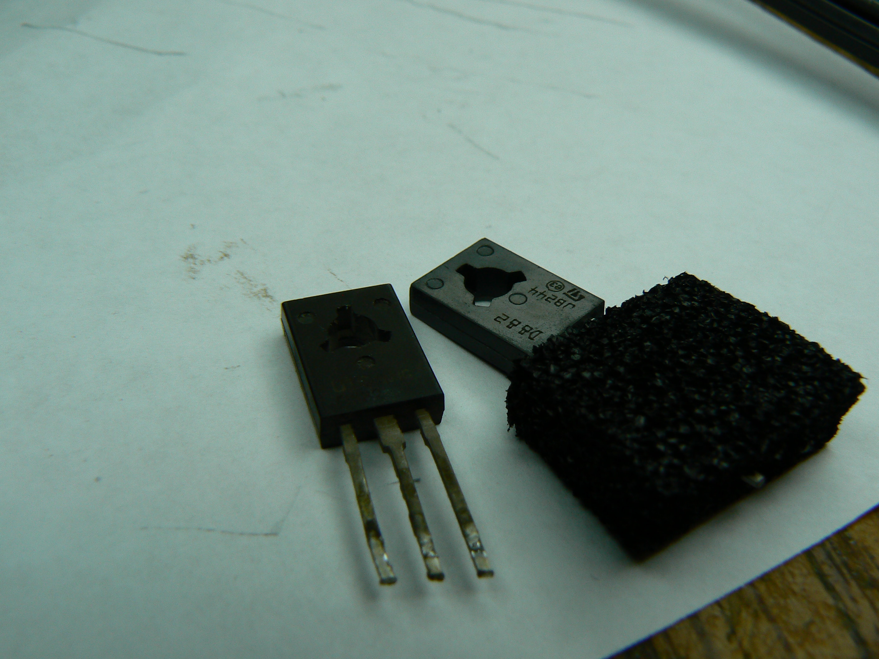

                            Actually the 5vsb FET was never shorted just the two main FETs and they have been replaced with new ones from Digi Key. That circuit is all original except for the caps and seems to be working good enough until I get the rest of the supply working. I actually played musical optoisolators by swapping both U5 & U6 with the one on the 5vsb circuit to see if they would cause it to have problems but both of them worked just fine. I replaced the TPS3510 chip with one I found in an old Bestec supply but its' operation was the same as the one I removed.

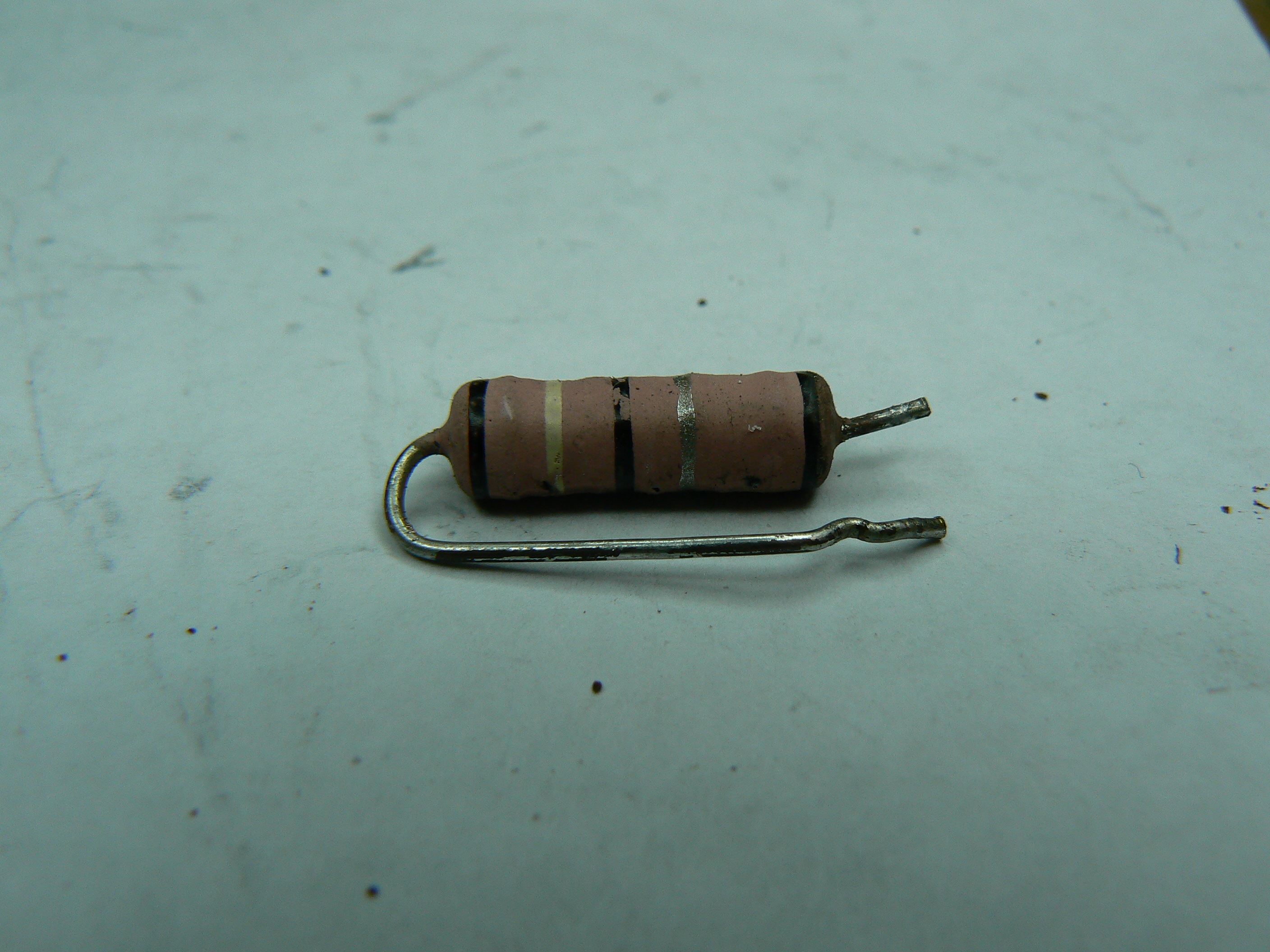

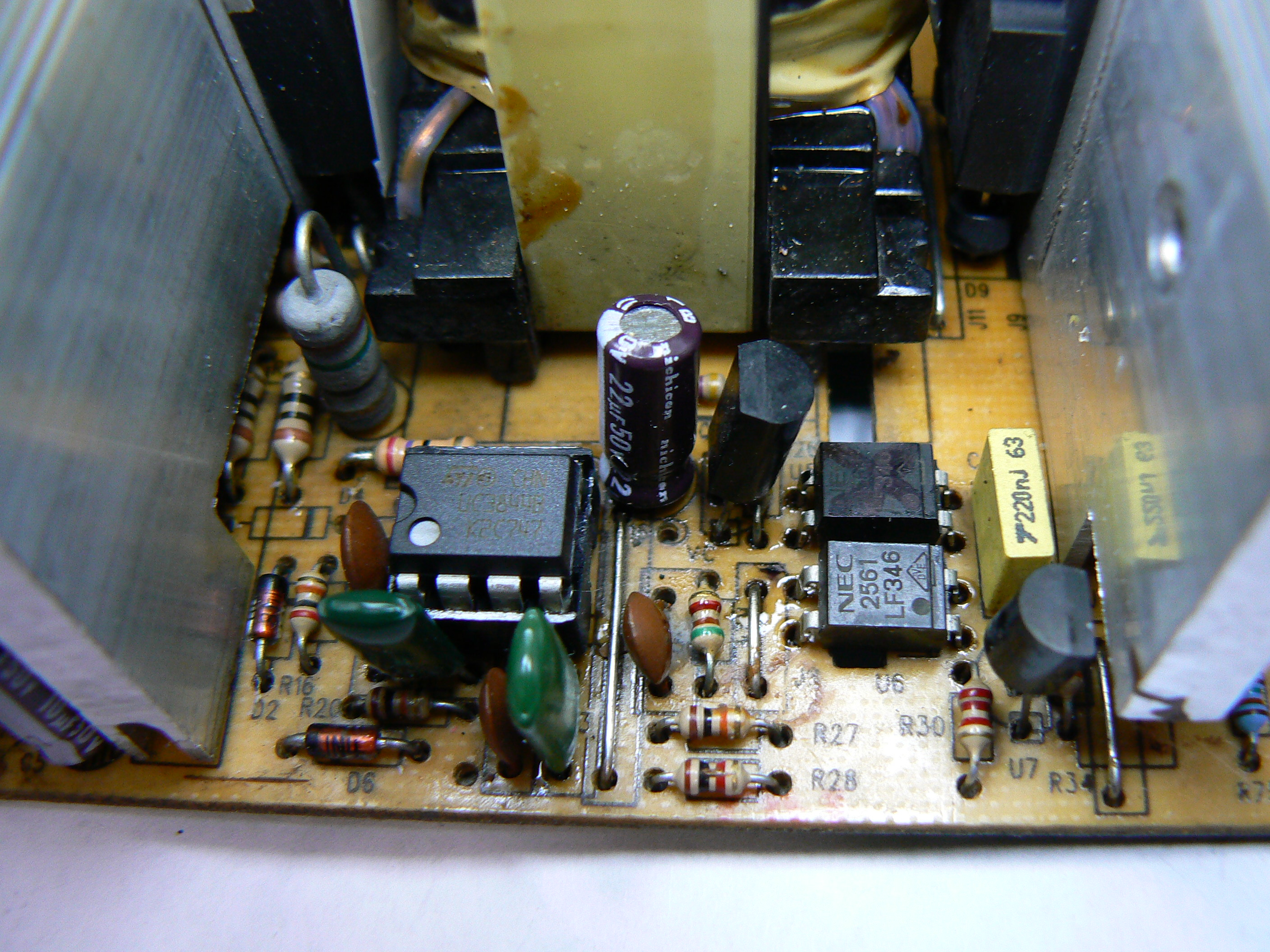

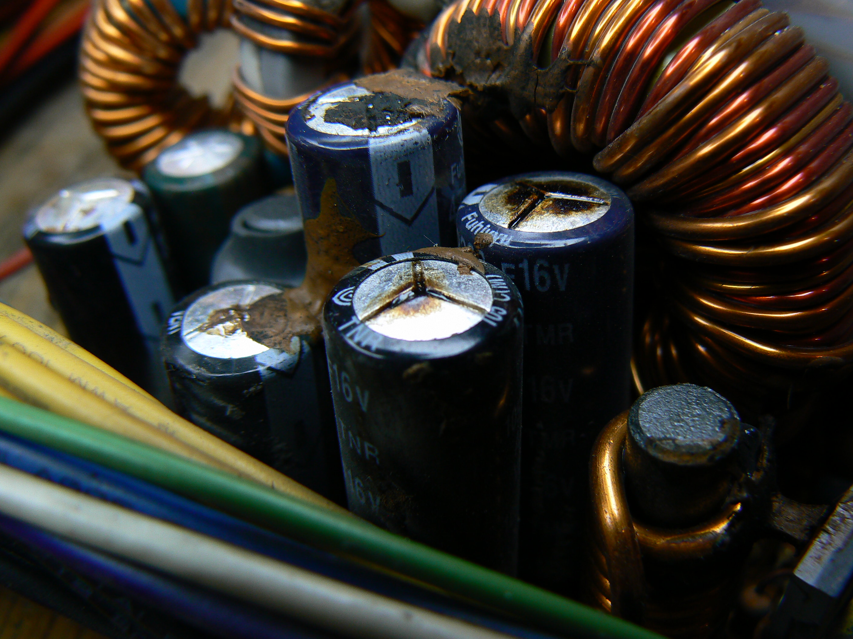

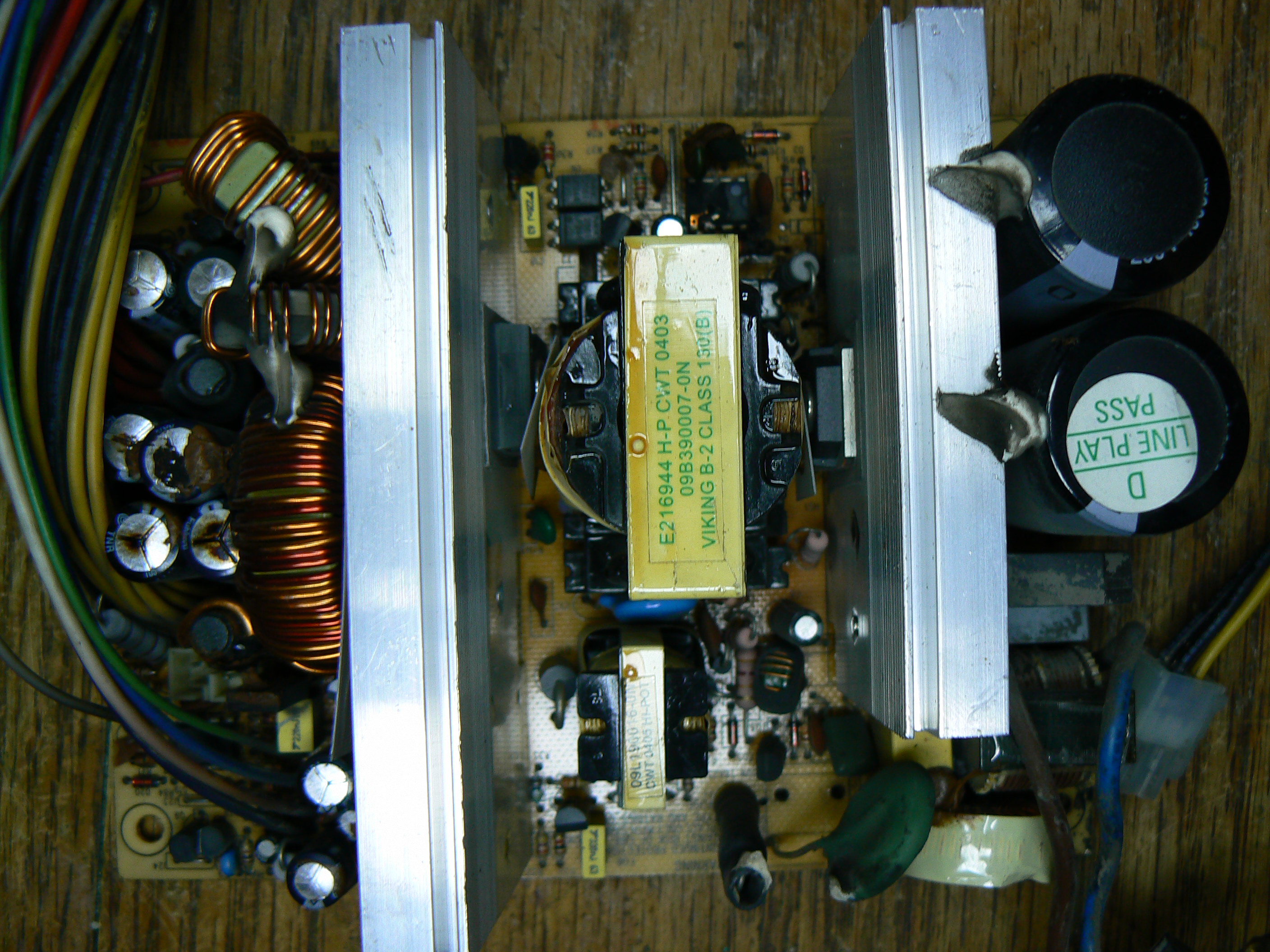

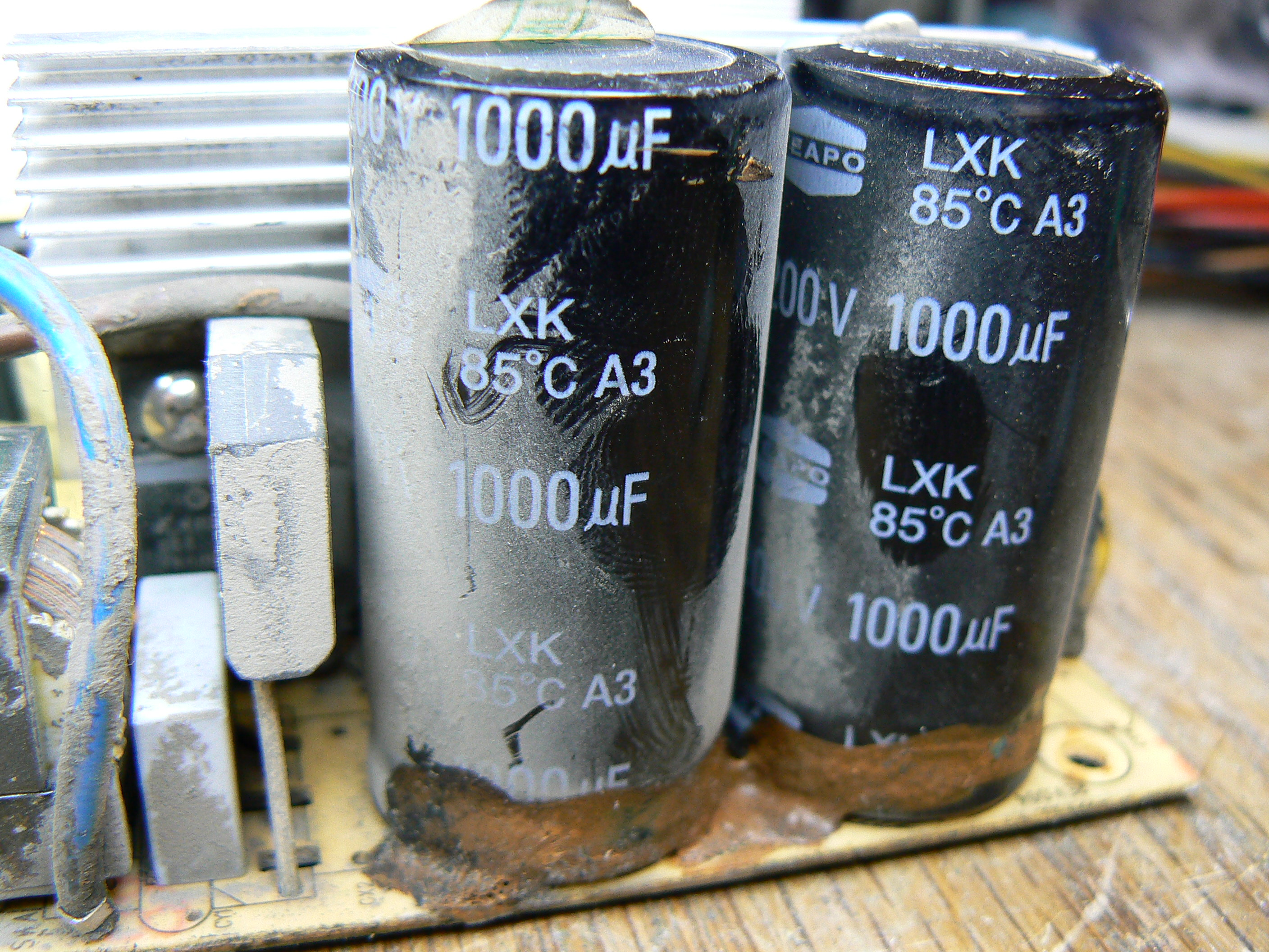

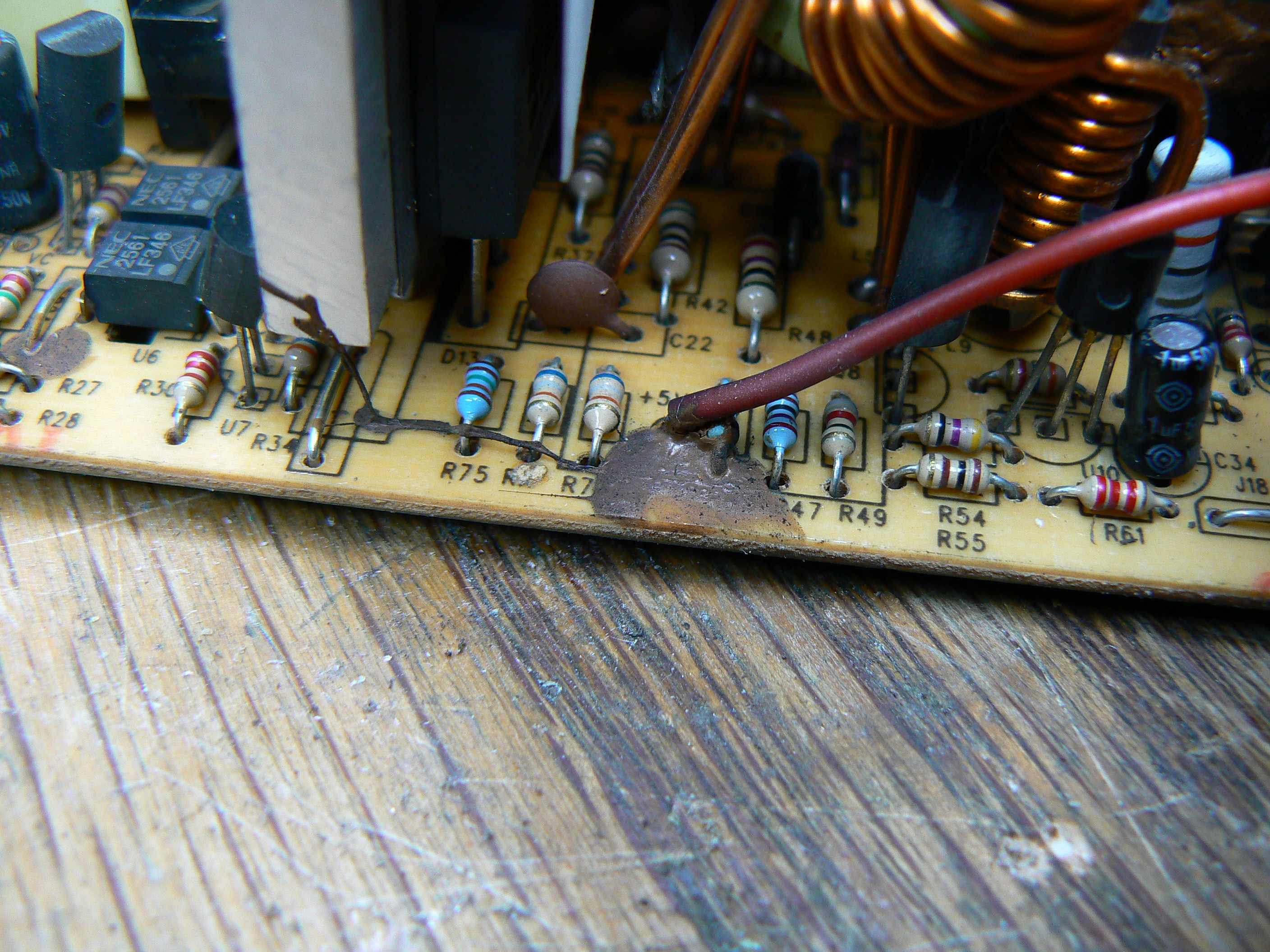

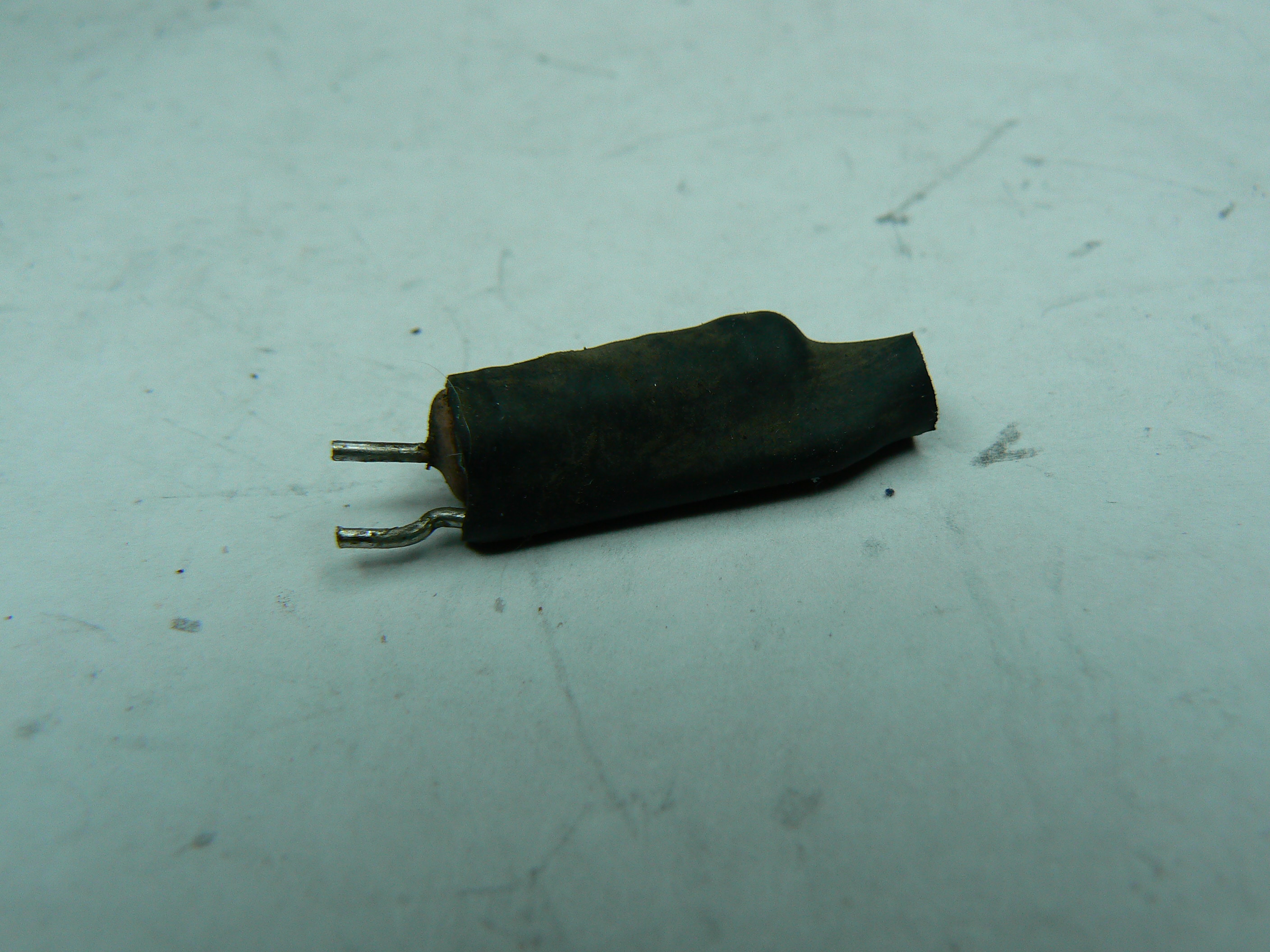

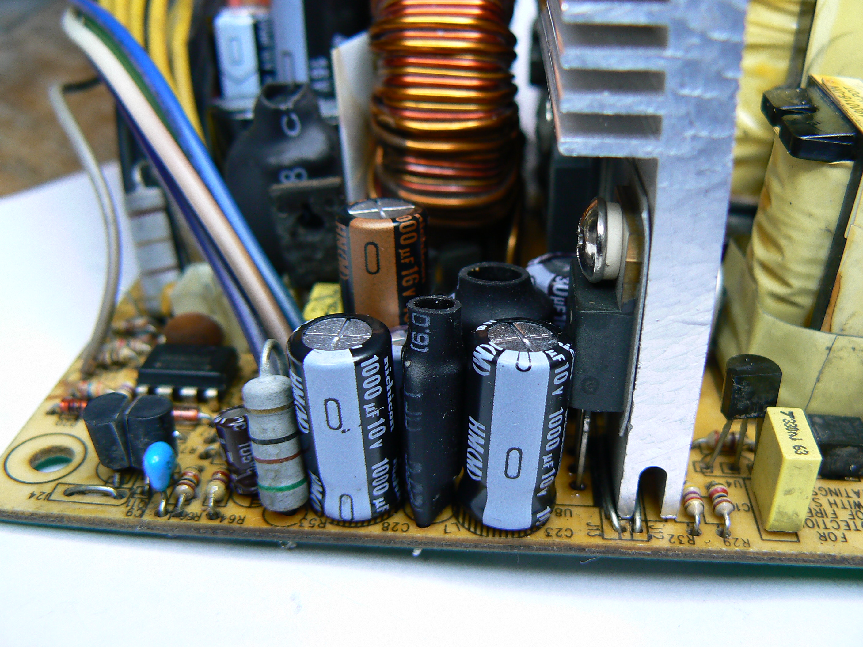

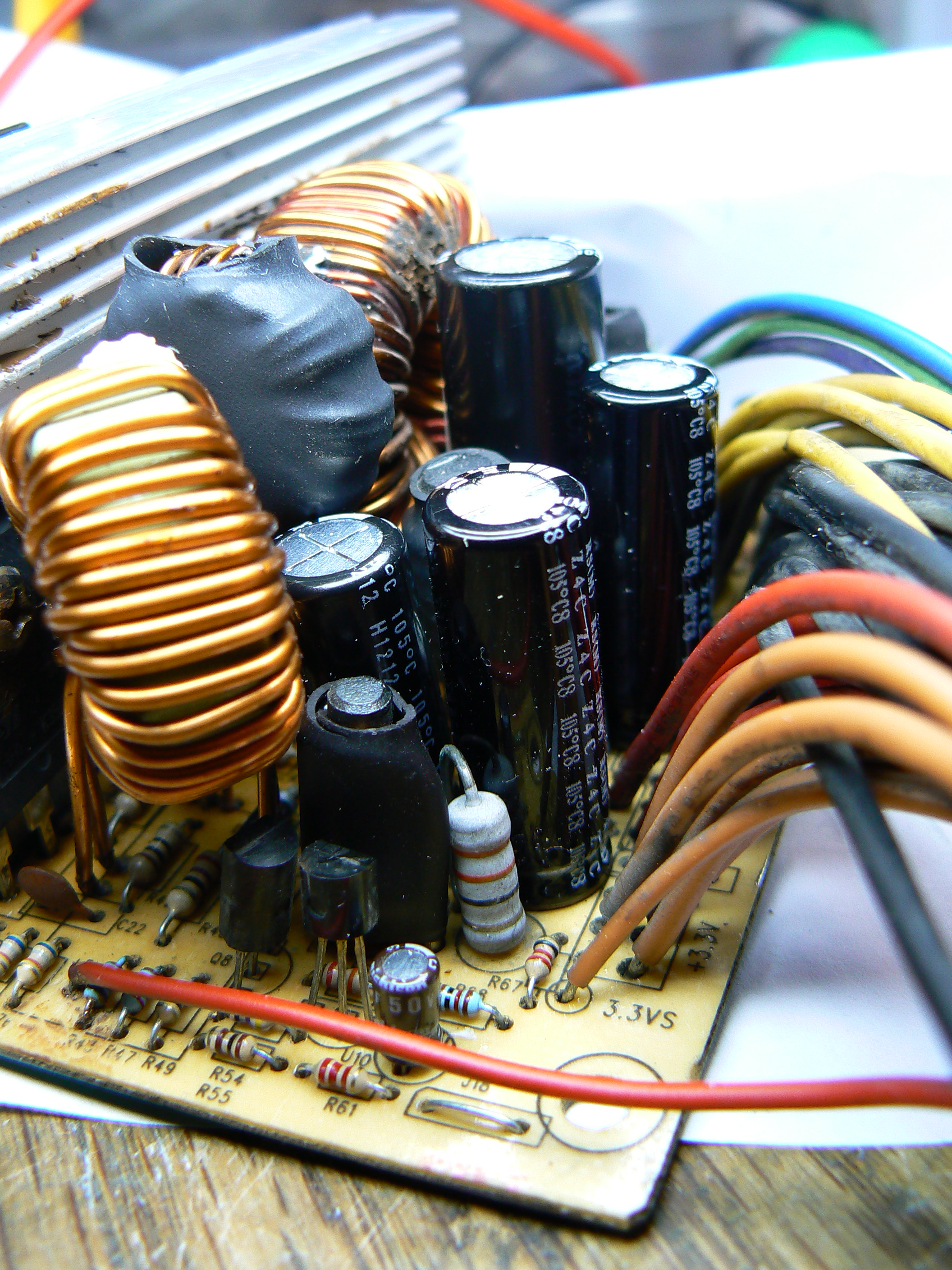

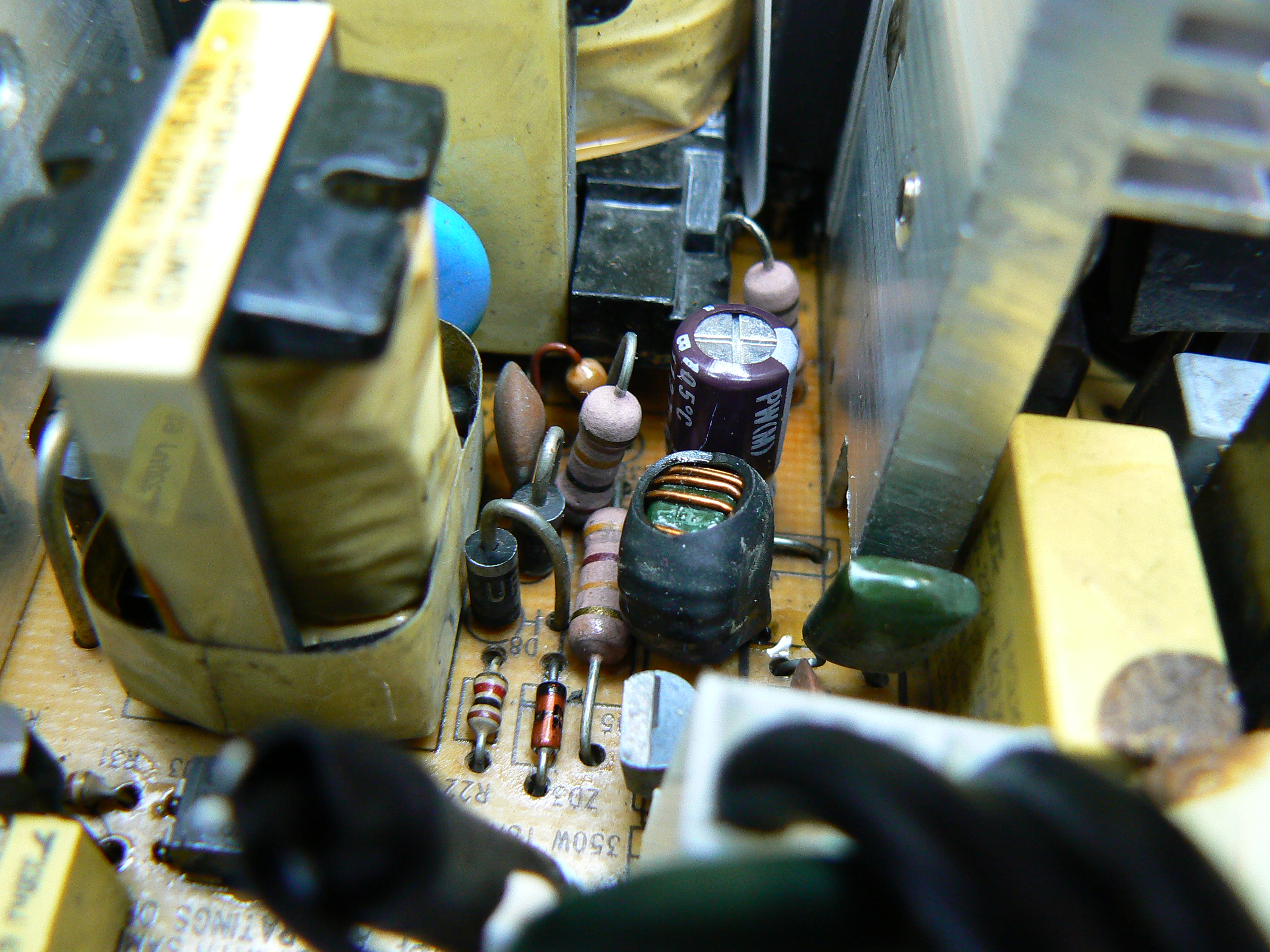

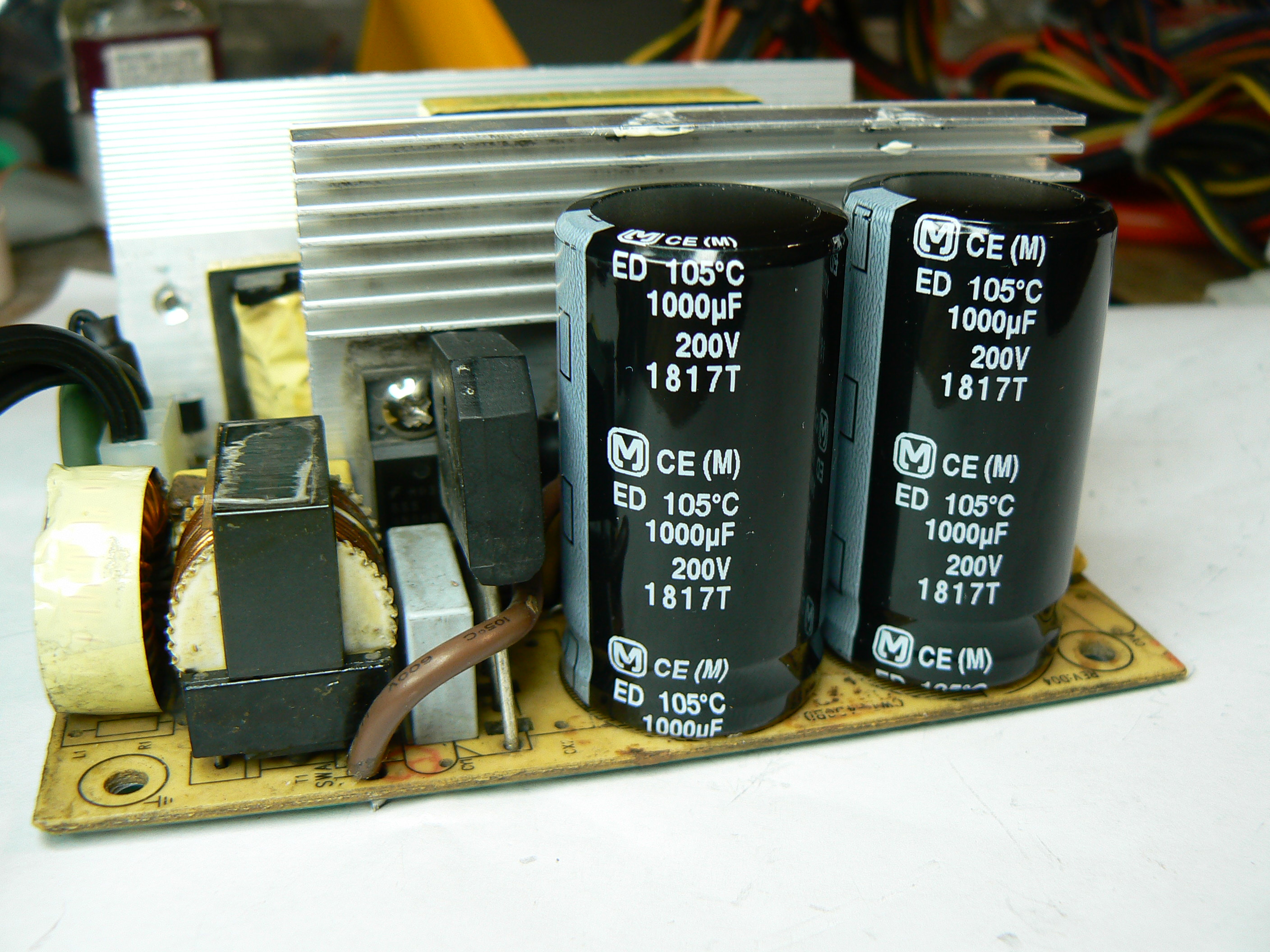

                                I pulled the resistor that is in the first two shots and it was open. I pulled a low ohm resistor from a junk supply and used it as a substitute. It was probably not the correct value but it was close enough for the supply to start working. All the voltages were good so I was very pleased with the results.
                                I then decided to test the fan controller and it would not push even one. I was not surprised by this as both fans were seized when I took it apart. I had ordered a new transistor (See the last attached picture) for this when I ordered my other parts so after swapping them I tried it again and the fan would run. It obviously needs to be modded to make the fans run faster but that is not a big deal.

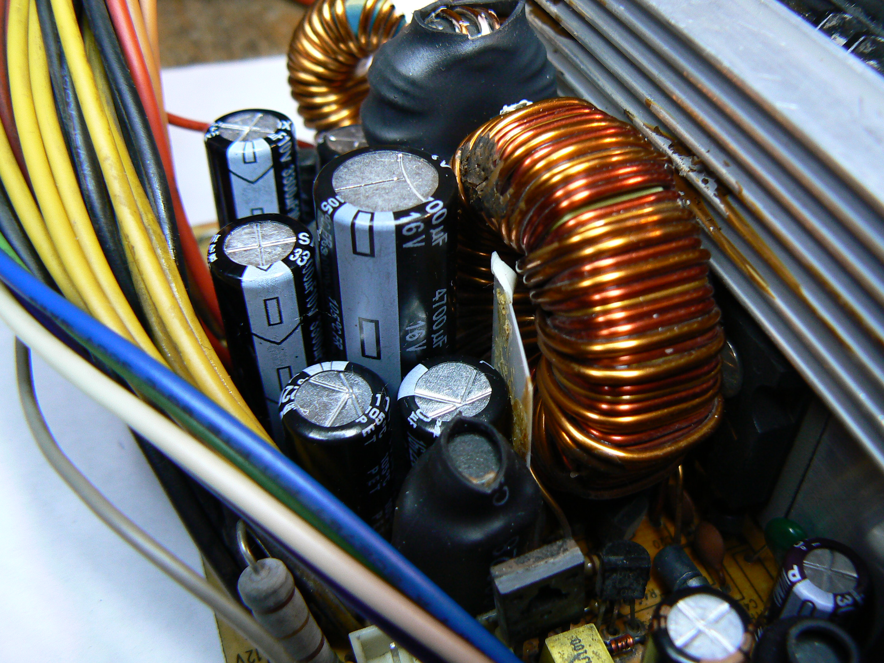

                                The other pictures are of the supply to compare to the ones from before the recap.
                                Thanks for the help guys.
