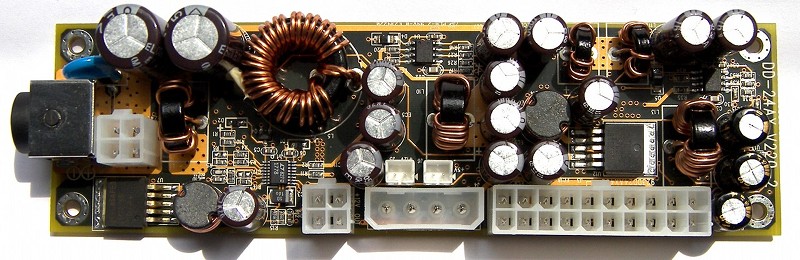

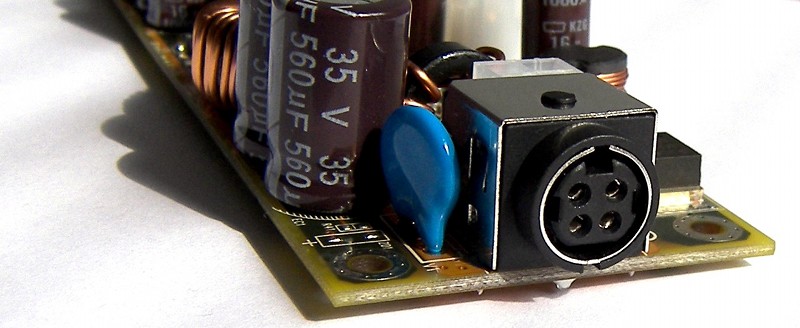

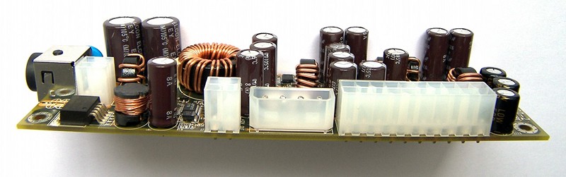

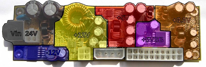

    I was reading about the pico psu and it looks like that the +12 volt feed comes directly from the DC source you use. So if your brick is not the bet quality it may fry your motherboard.
    Now this bad boy here seems to be a better design. It delivers 130 Watts continuous and still small enough to be used with a ITX mobo on a very small system.
    Looking at the pictures it does not look like rocket science to design and build something around this idea..
