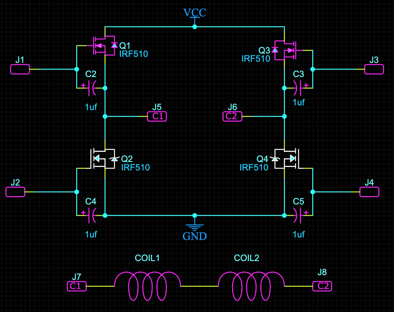

                        Re: Magnetic Stirrer Project Reset
                        I built two H-Bridges with this configuration:
                        And they work in that when I bring pins J1 and J4 high while J3 and J2 are low, current flows through the coils, then if I reverse the high and low state on the four outer pins, current flows in the opposite direction through the coil.
                        HOWEVER, I began to notice that when I had 12 volts on Vcc, the two top mosfets would get fairly hot while the two bottom ones did not. I also noticed that there didn't seem to be much voltage applied to the coils as their magnetic strength was pretty weak. That's when I decided to put an amp meter at the coil node C1(J5) to see how much current was actually flowing in the coil.
                        What I discovered was that it did not matter how much voltage was applied to Vcc, the current through the coil was always around 250ma. So when I applied 5V, then 12V then 19V at Vcc, the current through the coil was always the same. The voltage across the coils (that is the voltage from J5 to J6) is always 2 volts regardless of the voltage at Vcc.
                        What I am assuming at this point, is that the MOSFETs that are connected directly to Vcc are for some reason, "absorbing" the voltage applied at Vcc as it increases causing the rest of the circuit to remain constant and even though the current remains constant, the increased voltage at those MOSFETs increases the wattage they are dissipating which is causing them to get hot.
                        What I don't understand, is why are they doing this? Seemingly acting like resistors? I would expect this behavior from resistors, not MOSFETs. I also would have expected the lower MOSFETs to behave similarly to the top MOSFETs and what I mean by that is when I built this circuit, I was under the impression that since the current flowing through the circuit is the same, if the top MOSFETs were going to warm up, then the bottom ones would as well, but this is not the case and I'm stumped. It's as if the MOSFETs at the top change their properties because they're closer to Vcc but I know that's not possible.
                        Any ideas?

                              Well it looks like you've run into the MOSFET problem that all H-tree designers run into at one point or another - high side control. Easiest solution is to use P-channel devices on the high side, but you STILL NEED NEGATIVE FEEDBACK if you want to drive them sinusoidally. The problem with MOSFETs nonlinear inout curve still exists whether you're running single ended or H-tree.
                              As for amplifier design, I've already told the solution - you need an audio amplifier. Using an existing audio amplifier or copying an audio amplifier design is sufficient.
                              • redwire
                                • Dec 2010
                                • 3910
                                It depends on how much torque you want and how deep the flask is.
                                Three coils, L298 H-bridge, Arduino: http://blog.dzl.dk/2018/02/26/magnetic-stirrer/
                                https://www.edn.com/electronically-g...gnetic-fields/
                                Every commercial stirrer uses a motor...
                                  Yeah, that's how it should be done, digital on/off signals driving the coils, not with analog signals driving the coil and certainly not analog signals driving MOSFETs to drive analog to the coils...
