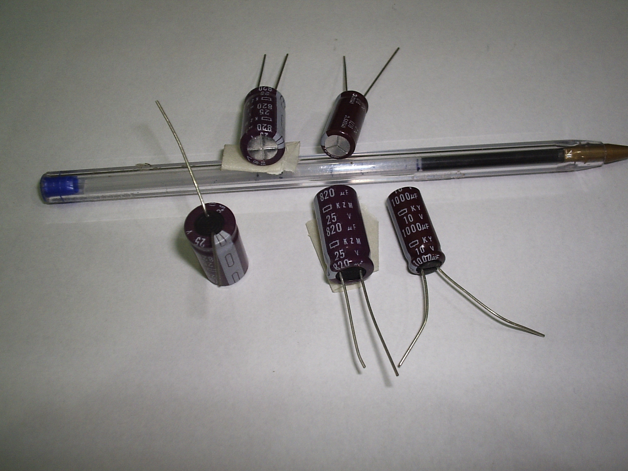

    Just bought these from a local online supplier. Do you think they are fake ?
    In the 1000uF x 10V KY I would trust, but the 820uF KZM seem suspect to me. Of course, I was disappointed, as the store sells the good brands ( Rubycon, Nichicon, UCC, Panasonic ) and the prices are not bad, although the price per order is still a little high.
    I could not get good light for the bung to appear, but it is a bulls eye pattern, not the two halves like the 1000uF x 10V KY.

    Yeah, those KZM look fake, the vent is different, the color is a shade off, and see how far the uf is away from the number? And the UCC logo looks a little off too. Seems like too many oddities to be real. Did you test their capacitance?

      The color is a little different, like they were on the sun for some time.
      Yes, what I noticed were the different vent, the bung and the separation between the u and the F.
      Sad. Well, I won´t be buying from that store again , also. I first thought about complaining to them, but I think they will just shrug and say they buy from the "best suppliers", and that the caps are from a "different factory" or "different batch ", "different model " .. Maybe I still will complain, but one doesn´t feel much at ease fighting with these online places that ask too much personal information when doing a sale....like with the telephonic companies, some charges may appear in a CC, and then one has to waste a lot of time and patience solving those "computer errors".
      Yes, they measured about 920 - 940 uF, while the 1000uF KY would measure something between 990 - 1017 uF. I think I will just keep those fake ones for using in junk atx psus. Too bad Farnell charges US$ 40 just for shipping here...

        The capacitance may be fine, but the question is the ESR and longevity? Probably not. The bung could be whatever supplier was cheapest on the day. Since they couldn't get the "mercedes" vent right they don't look to be trying to hard, just trying to fool the average customer?

          Yeah, I think so. Most people around the city that I have talked to just buy 105C caps, whatever the brand, and use them. Difference between brands and ESR is an alien concept to them .. : (

            Oh yeah, those are FAKE xD
