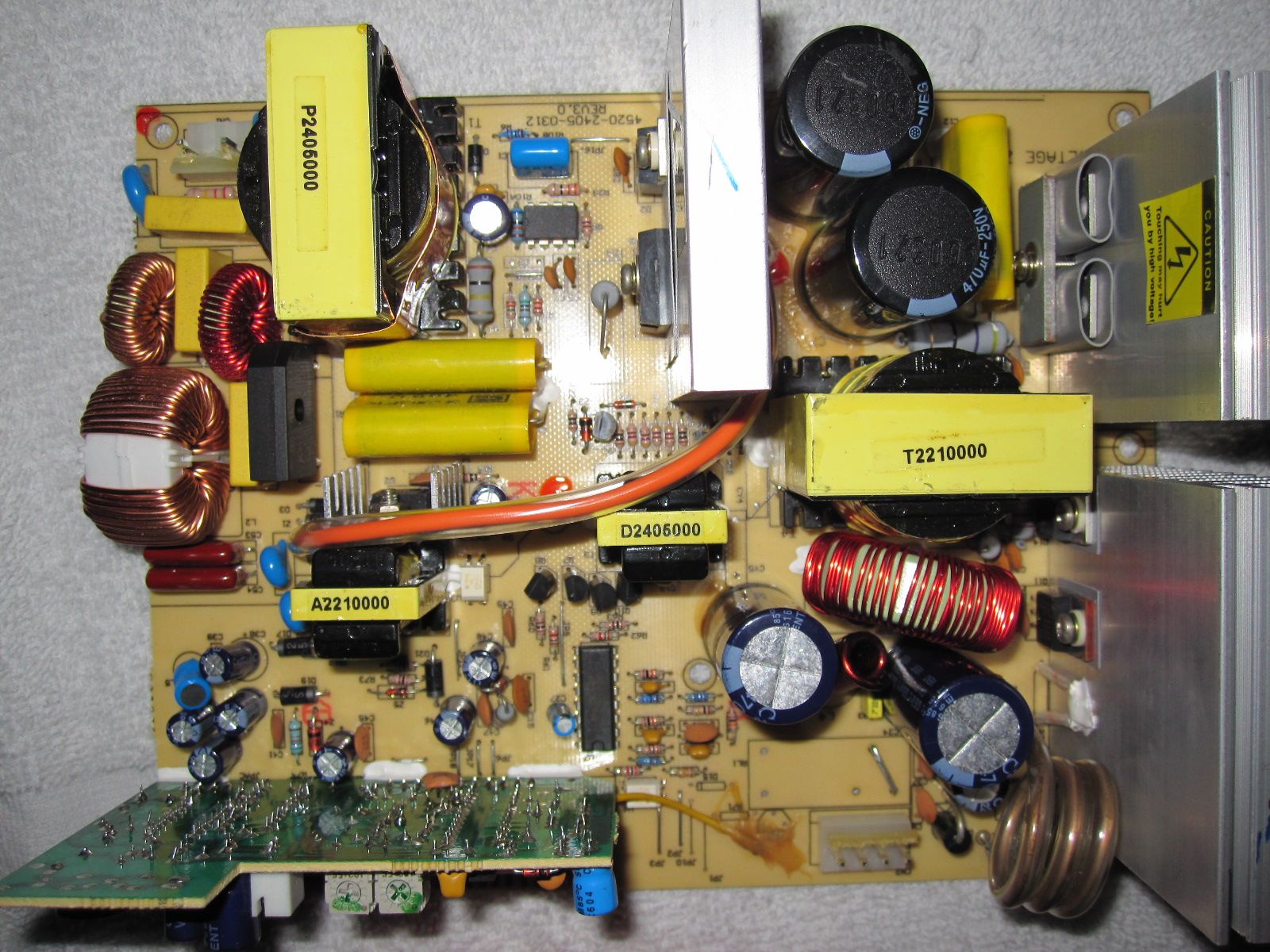

    I have a BK Precision 1665 0-20V variable SMPS. When I got it, it had 2 burned out switching MOSFETS, IRF840A and 2 shorted 1N4744A zener diodes on the MOSFET driver circuits. The driver transistors test good. I was unable to find any more shorted semiconductors.
    Problem is, after and even before replacing those parts, when using a 100W bulb in place of the fuse and I turn on the PSU, the bulb blinks and the panel lights go out. The bulb blinks at full brightness and when it is off, it is completely dark. The front panel is lit when the bulb is off, dark when bulb is lit. It blinks at a steady rate, just like the turn signal on a car.
    It was doing this even with the bad parts removed, and it does the same even with the new parts installed. New parts seem not to have been harmed.
    Any ideas what I should check?

                It uses a TL494CN for the main SMPS. However, there is something that appears to be another SMPS and large transformer with a large TO-3P package MOSFET and TO-220 rectifier. It almost looks as though the output of it drives the input of the 2nd transformer. I'm not positive though, as I get a bit lost following all the traces.

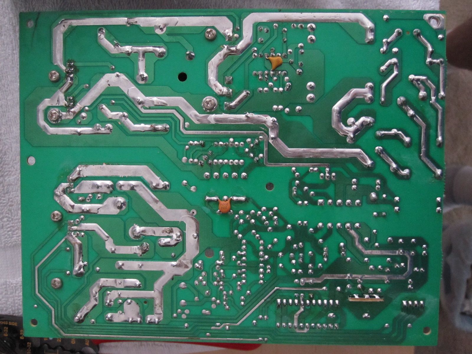

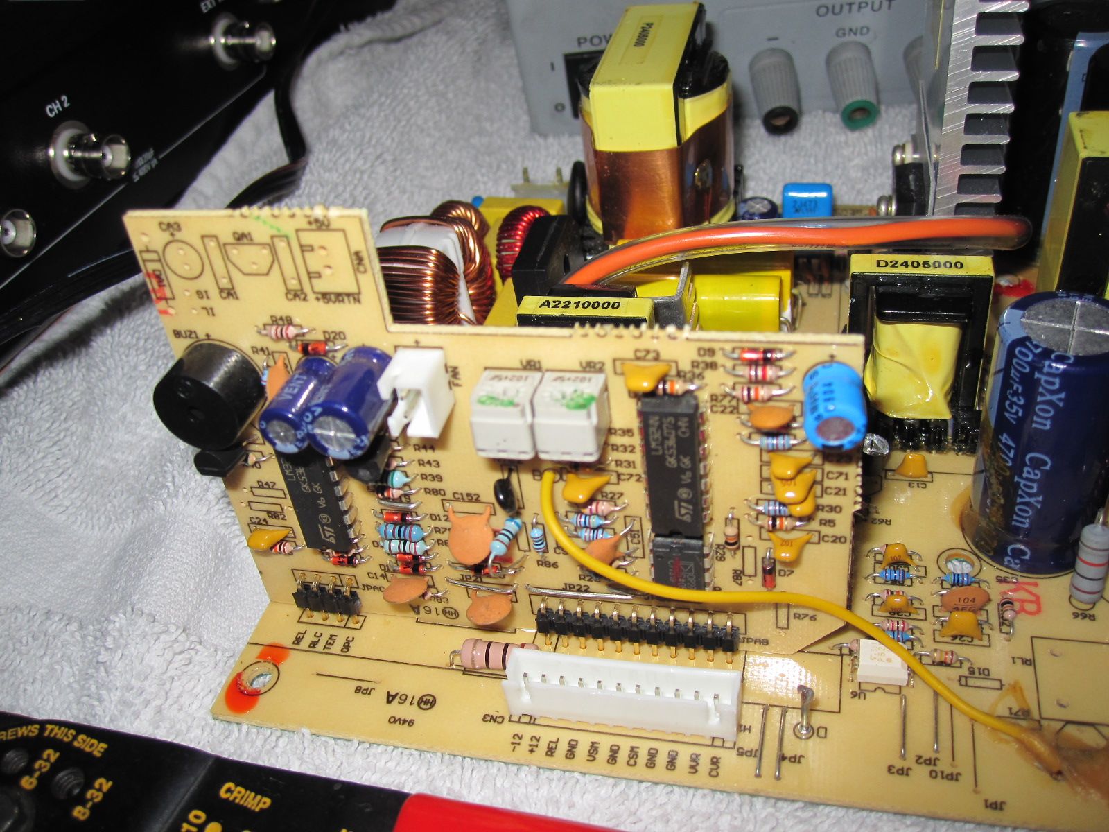

                      Pics attached.
                      The part that looked like another SMPS to me is actually the APFC circuit. I didn't expect this kind of PSU to have APFC, but I ran the P/N of the 8-pin DIP (MC33262) through Google and it's a PFC controller, so now things make a bit more sense to me.
                      I checked all the output rectifiers and none were shorted.
                      Could bad input caps cause this? They are CapXon which I've had some bad experience with on PC PSUs. I had an APFC PC PSU that blew the MOSFETs when the CapXon input cap went bad. However, it didn't behave like this one with the blinking of the bulb.
