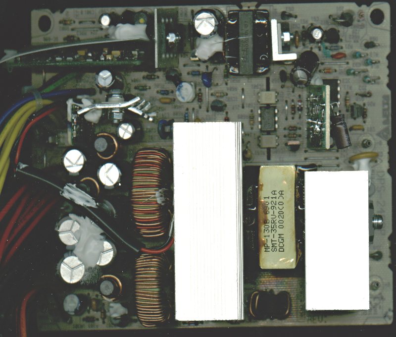

    I am interested mainly in the model labeled NPS-300CB, but is there some general OEM supplier of ATX PSU's for Fujtisu Siemens? Would like to know what I can expect inside…
  • mariushm
    • May 2011
    • 3799
    Re: Who is OEM for Fujitsu Siemens?
    The label with the ratings has the template of Delta power supplies
    The UL number (E131881) belongs to a Delta power supply:
    http://database.ul.com/cgi-bin/XYV/t...374&sequence=1
    Should be a good power supply, the wattage for the rails is certainly adequate for 300w psu.
    PS. In general, look for an UL number (the number below the logo looking like a flipped UR text), then you can find who makes it here: http://database.ul.com/cgi-bin/XYV/t...RAME/index.htm (paste code on UL file number)
    Then look on the PCB or on the transformers.. for example CWT likes to use a dark green tape on the transformers and has the CWT on the code.

            I've seen both good and so-so older Deltas. I have to think the pictured 240W running my fileserver 24/7 for the past decade is pretty good, don't recall if it has NCC, Nichicon, Rubycon, or more than one of those brands in it though it may be from their small server lineup, I vaguely recall they couldn't fit all the components on the main PCB so it had the input filtering, rectification and high side capacitors on a 2nd inverted PCB screwed to the top (not pictured).
            Seems like I bought about 5 of those around 2001 and the one pictured happened to have a manufacturing defect in that a small capacitor was installed backwards and vented as a result.
            I also had pretty good results with a few 300W DPS-300BB models built for Acer servers or workstations, don't recall any of them failing. They're the same as larrymoencurly pictured on the right in the following post, I vaguely recall I had to hack those over at Anandtech forums to figure out they needed more of a load on the 3.3V rail than many systems provided in order to keep them turned on which might seem like a bad thing but the value for the price paid was great: https://www.badcaps.net/forum/showpo...4&postcount=19
