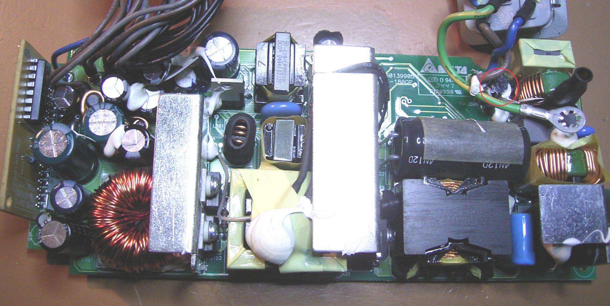

    My hope was it may just be a blown fuse - but this does not look so; the part I think it is the fuse (red circle on pic "top.jpg" - it reads "T 4A") is allright.

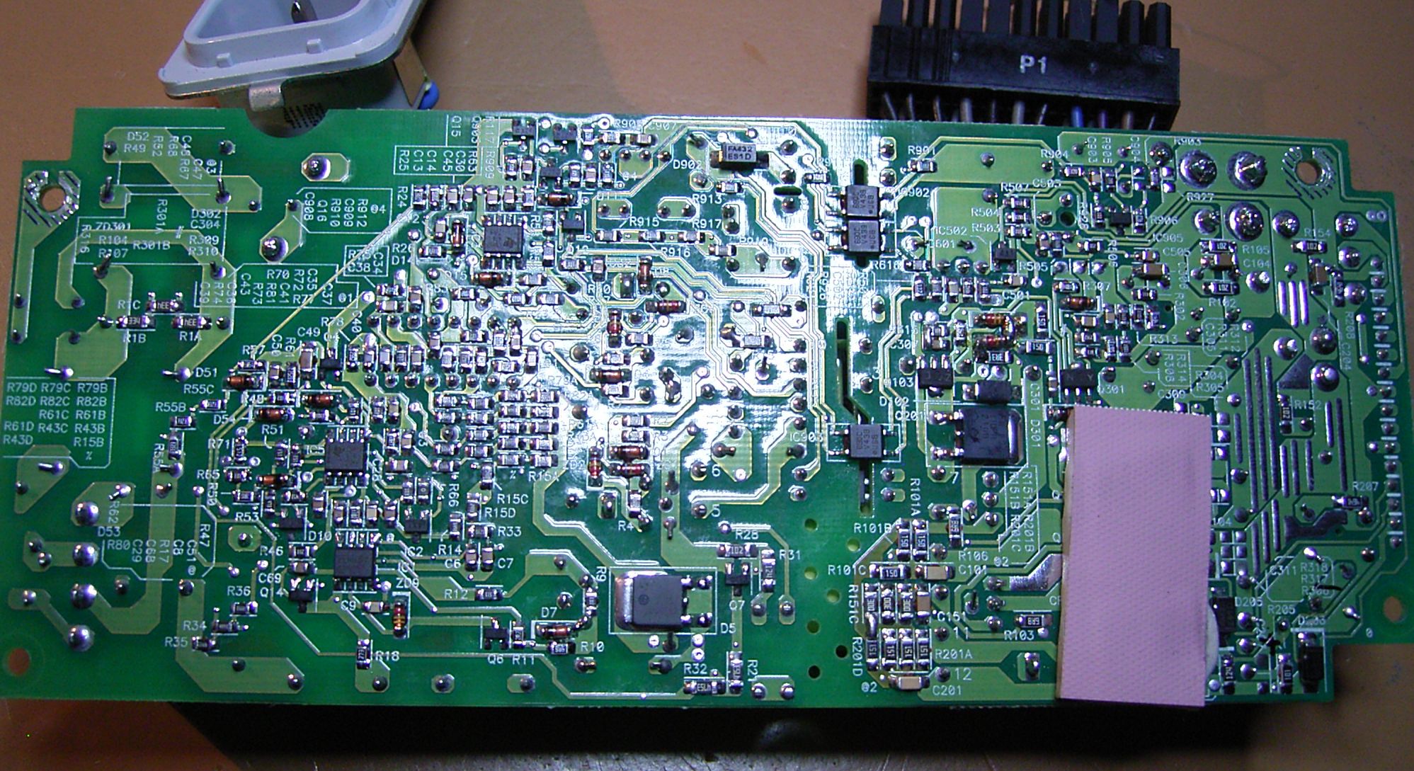

            A picture from the wire bundle side with it pulled back to show components and some of that white goop removed. Where on the bottom picture does the purple wire connect?
            The death of the 5vsb affects the ability of the PSU to start.
            On the bottom pic - Anything to the LEFT of the optoisolators, cuts in the board, and transformers is considered the HOT side with respect to the MAINS. Shock hazard.
            To the right is COLD and lower voltages.
            Of interest and measurement on the bottom are IC502 & IC905. There is the TO-220 package, 3-legged, tabbed device (top photo) to the left of the outboard transformer and below the blue sleeved cap. Appears to be a dual-diode.
            Look for any burn marks or bubbles on the SMD resistors in that area also.
            Toast

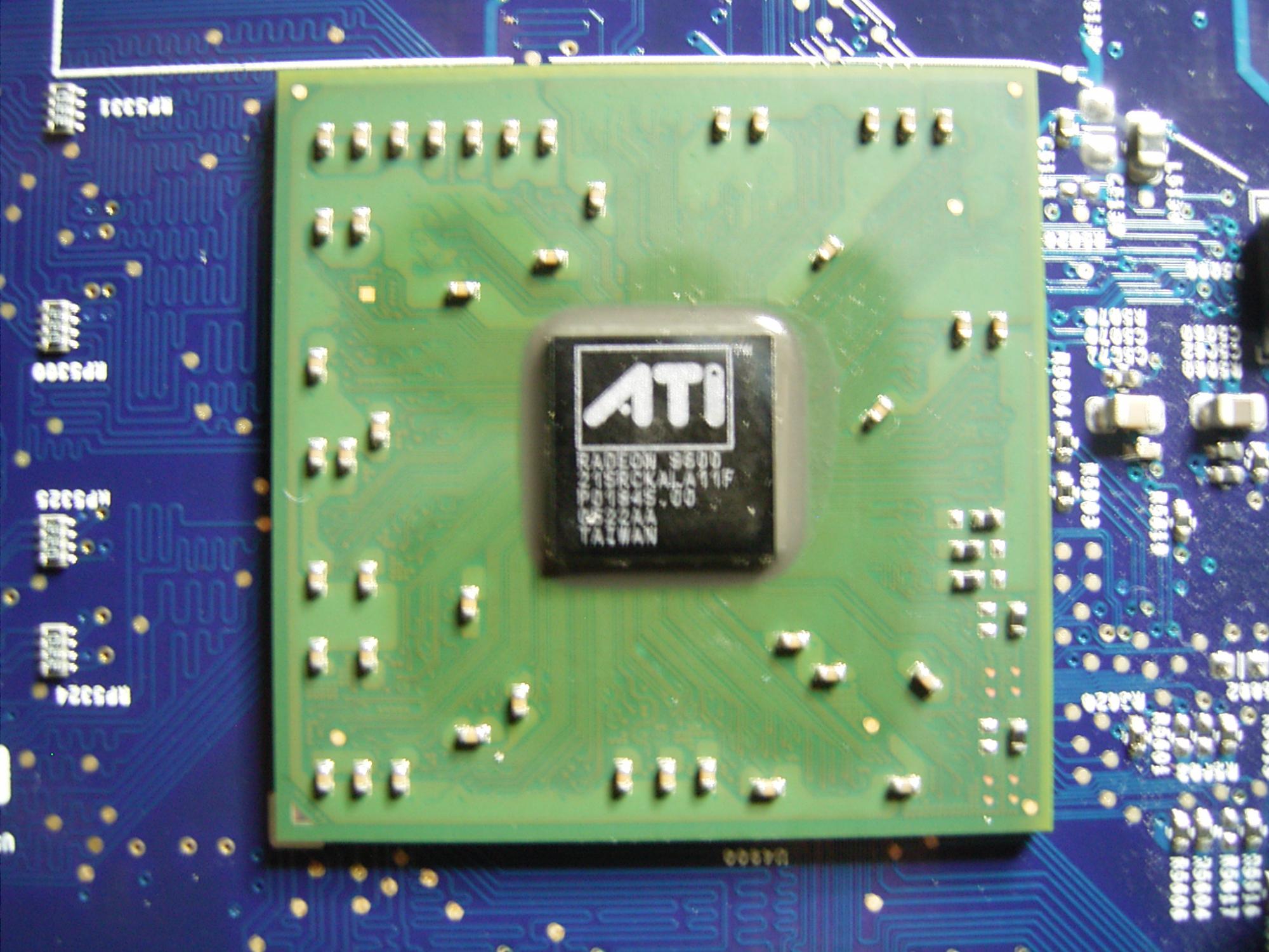

                    This is what the beast looks like…

                      Could work, as well as other similar methods. I would use a lead free solder as an temperature indicator, as it melts at a slightly higher temp.
                      Get the surrounding components well protected with foil and be generous with a LIQUID flux such as Kester's 951 under the GPU. Wash under the GPU with an isopropyl alcohol based solvent/flux remover first. Then apply the flux with the board on a slight incline so that the flux runs out the other side. Roll it around a bit to make sure it's everywhere under the chip.
                      Take the batteries out of the smoke alarms or do this procedure outside.
                      Toast
                      veritas odium parit

                        Re: PSU imac G5 shot when testing
                        Hi everybody,
                        sorry for the long time not to answer - life tends to be complicated these days.
                        I was given a little butane gas torch, which makes a nice little (0.5cm long) blue gas flame. I thought about using that one for the reflow job - as it gives the heat very concentrated. - Or - does it focus too much?
                        Yours, Wolf
                        • Toasty
                          • Jul 2007
                          • 4171
                          Too concentrated.
                            Dunnit!
                            Wow - it was quite easy. Apart from setting apart the machine just something like 5 mins. I used Kolophonium as a flux - now I know why I did some music centuries ago.
                            It has been working for 10 hrs now - so I'm a bit optimistic.
                            Thank you very much for your support.
