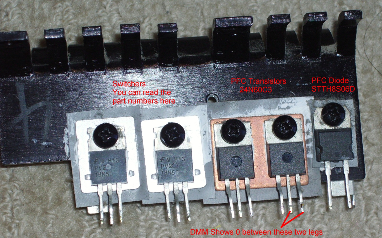

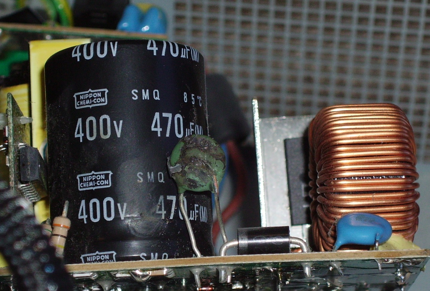

    OK, so I scored this dead Trio 650W PSU from work. It has no 5vsb and the fuse is blown. After removing the primary heat sink and probing the transistors with the DMM, it looks like one of the PFC transistors is shorted. They are infineon SPW24N60C3s. The NTC thermistor also looks like it has seen better days. Would Infineon SPW47N60C3s (http://australia.rs-online.com/web/s...duct&R=4623455) work as replacments?
    Also, does anyone know what value the NTC would be?

    Seeing as everyone was so willing to help (not), I decided to go ahead and replace the PFC transistors with the SPW47N60C3s and remove a thermistor from dead Liteon PSU. It powers up OK now. I haen't load tested it, but it works OK on a cheap tester.
