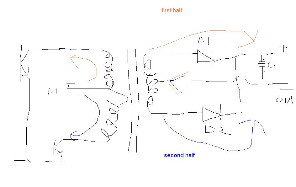

                    • Behemot
                      • 4845
                      • CZ
                      #50
                      Re: The PSU FAQ
                      So when one half of the wiring gets high pulse, the other one gets the same low, but with reversed polarity, so basically both get the same (two minus give plus)?

                        #51
                        Re: The PSU FAQ
                        in my attachment you can see how the two halfs are prossesed
                        excuse my crude drawing done it in paint
                        also i made a error in the pic d1 and d2 are the same part.

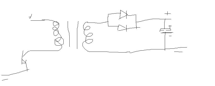

                          #52
                          Re: The PSU FAQ
                          this is another way it is done you double the diodes current capacity but only one output pulse per cycle and the winding on the transformer carry's twice the current if was run at the same frequency.

                            #53
                            Re: The PSU FAQ
                            So there is also common wire on the primary, I see. It clears a lot of things now
                            EDIT: and theres also famous push-pull.
