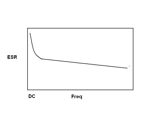

                Re: Question on ESR and Capacitor Selection.
                This might help.
                Mann-Made Global Warming.
                - Dr Seuss
                  Z² = ESR² + (XL - XC)²
                  There is a point where XL = XC.
                  At that point Z = ESR.
                  It's roughly around 100kHz for most caps we talk about here.
