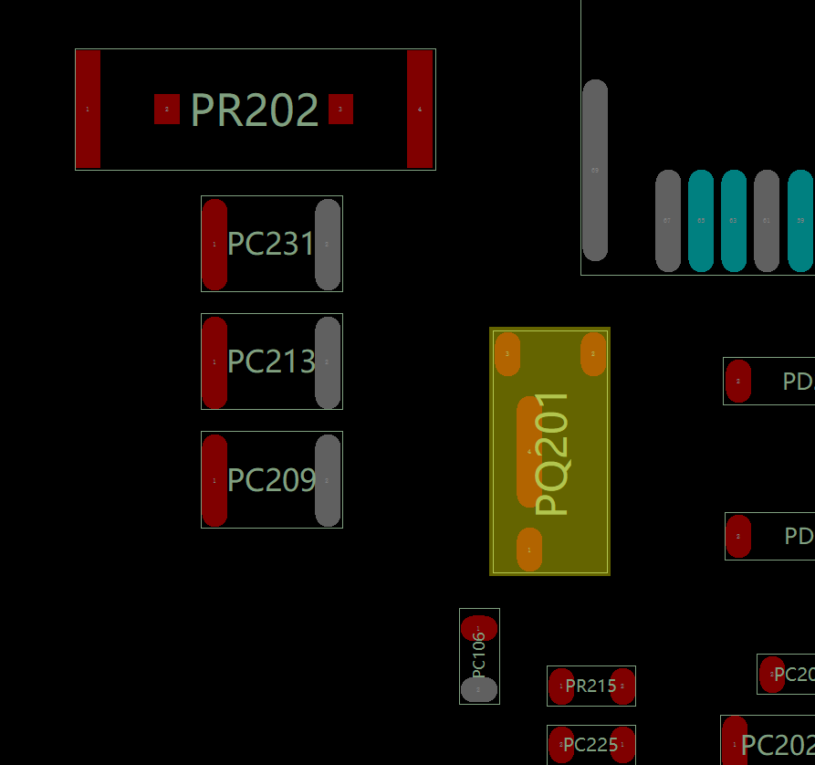

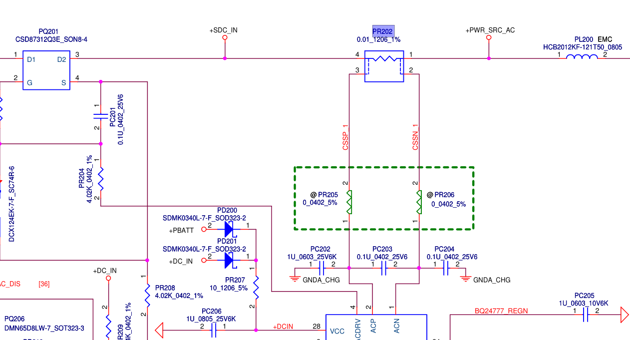

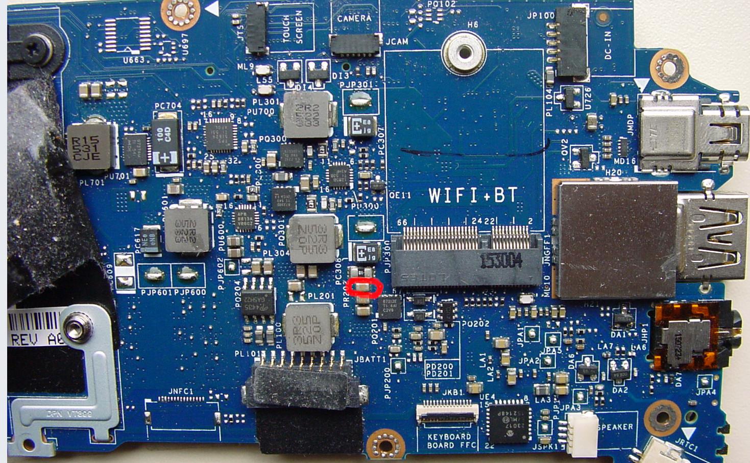

    I am trying to repair a Dell XPS 9343 motherboard and I think I found a faulty Mosfet (PQ201).

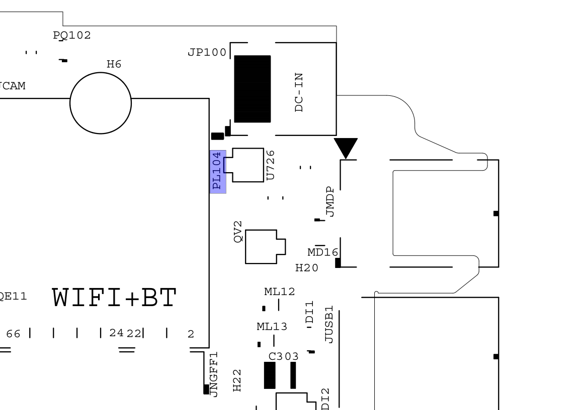

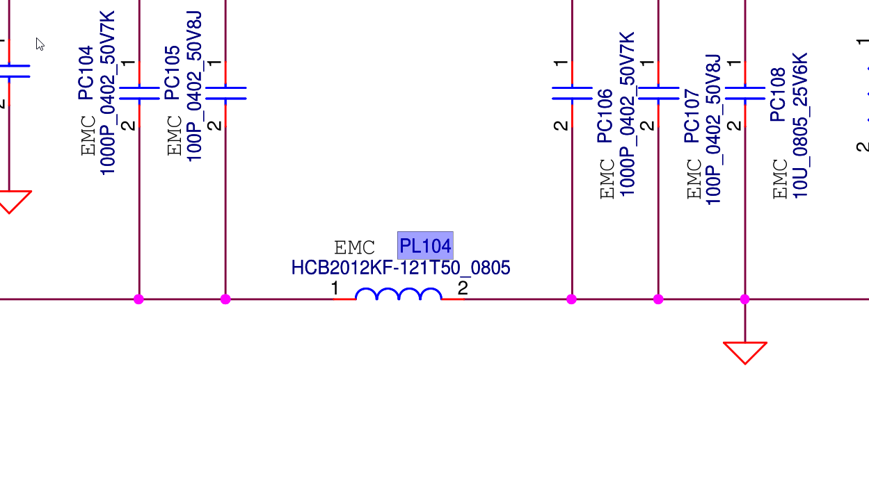

    But I have another problem 2 components are missing (PL104 near DC jack connector and another capacitor near PR202).
    I have only the schematic so I can't figure out what is the value of the capacitor because there is no marking on PCB for this capacitor.
    So I would like to know if someone has the boardview of this card (LA-B441P).
    It's only for my personal use I would like to keep this laptop for me.
    Thank you.
    Eric

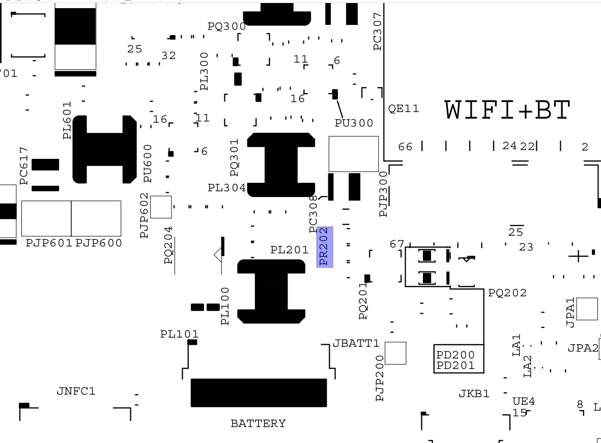

    Re: Dell XPS 13 9343 boardview
    See attached. Post pics with details of what is missing from your logic board if these attachments do not answer your request.

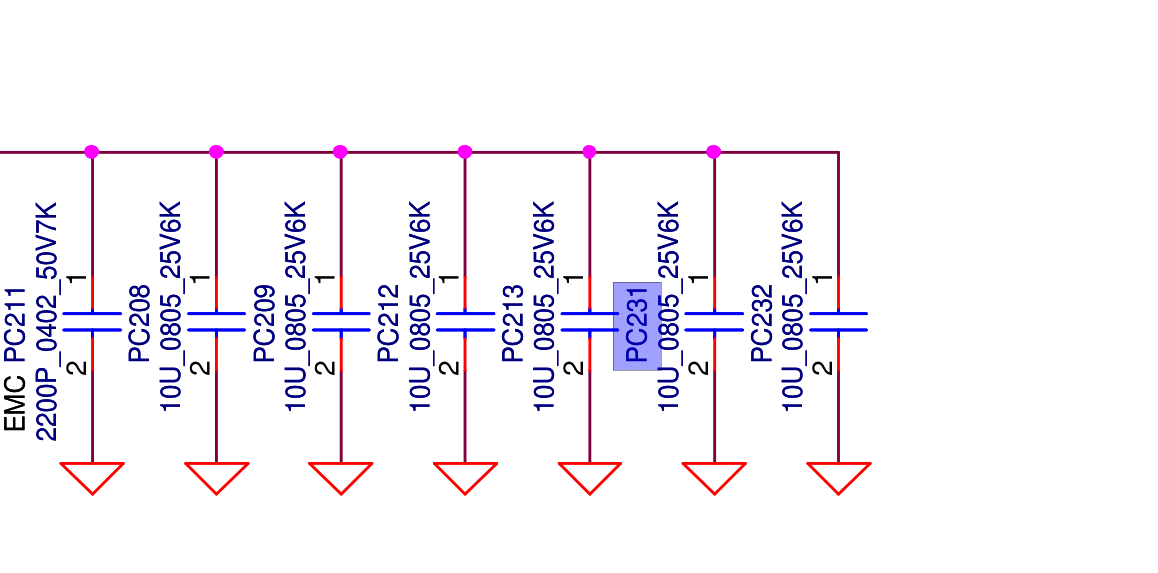

      So can you confirm the capacitor name on this picture.
      In red the capacitor that is missing on mine.
      • mon2
        • Dec 2019
        • 14721
        PC231 - see attached.
        Nothing special but a bulk cap @ 10uf; 0805 smd size; 25v or higher; X7R or X5R (recommended).
        You could even leave this part off the logic board and it will not be missed as there are others on the same rail.
          Yes for testing I will leave like that thank you very much.
