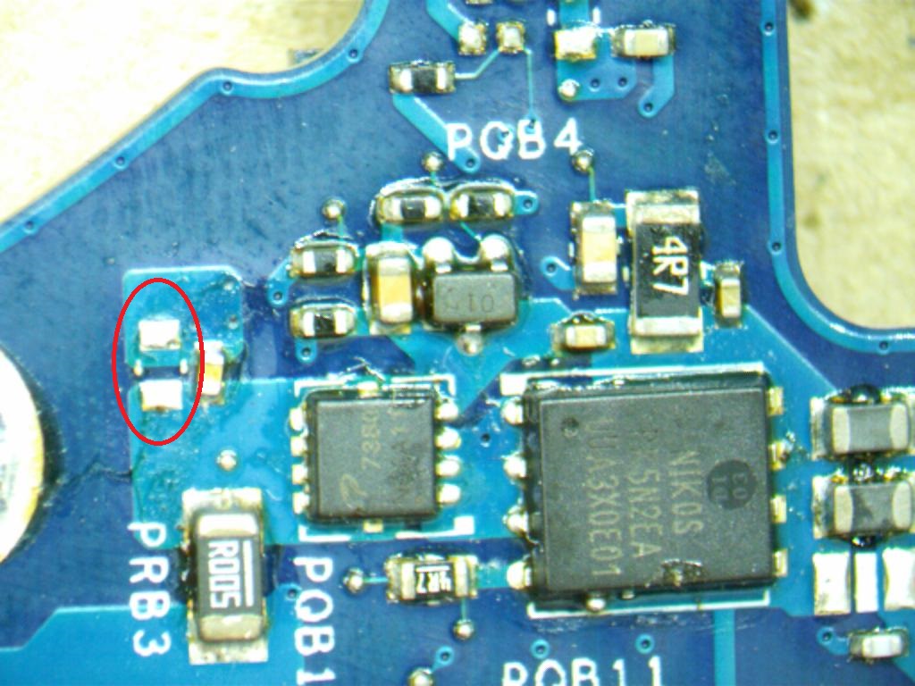

    hi guys, i've got this laptop with shorted board and no power and dont know where to start. i have basic knowledge about repair but treat me like a newbie

      quick update... one capacitor been bad. Board works now without it but I'd like to know what it is and put the new one

        10U_0603_25V6M cant find it on any board i have. any idea what to replace it with?

            found it in acer iconia tab b1
            problem solved

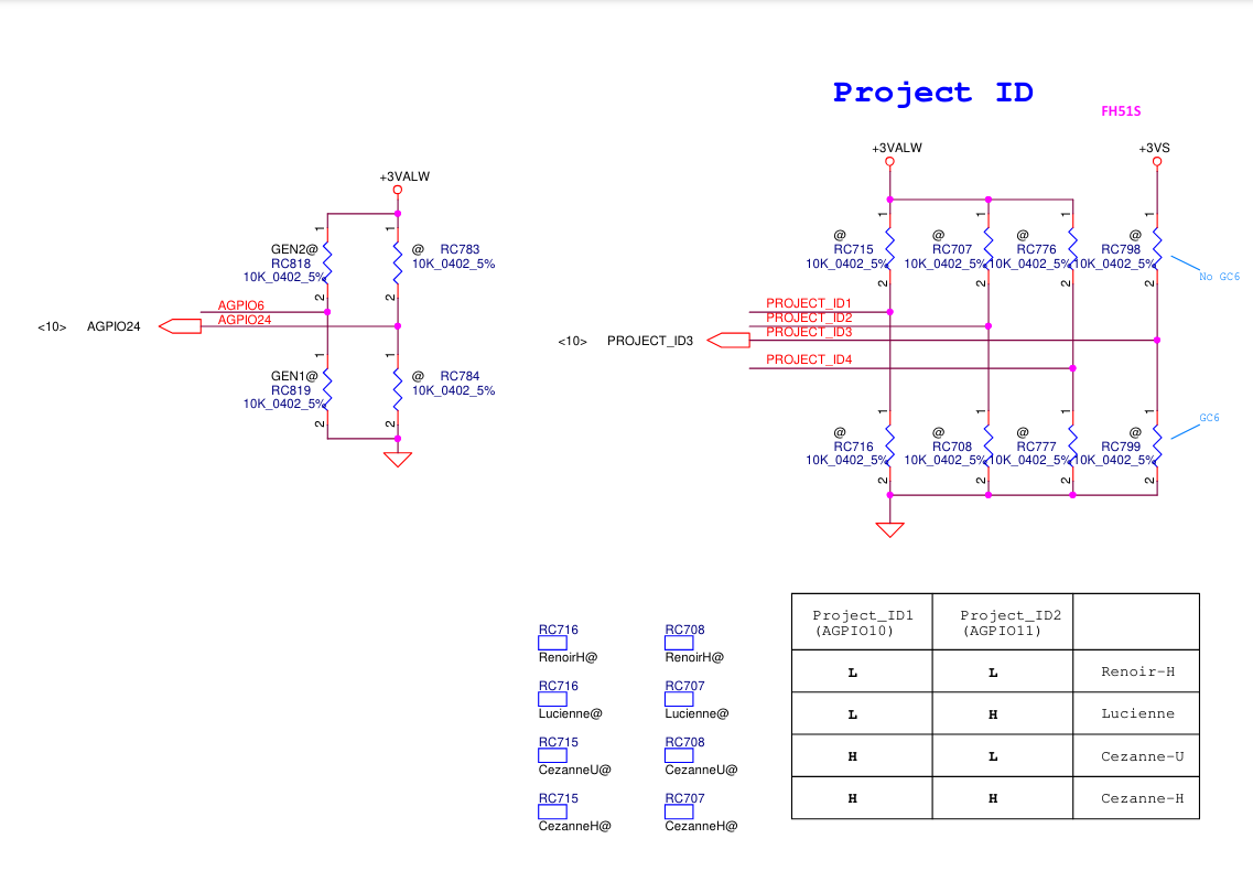

              Does someone here know how to convert this from discrete to UMA? The boardview and schematic is provided in here.
              Project ID
              UK1 not present
              RC715 not present
              RC707 present
              RC776 not present
              RC798 not present
              RC716 present
              RC708 not present
              RC777 not present
              RC799 not present
              • rex98
                • Feb 2023
                • 1289
                • Mandaue CEBU, Philippines
                Project ID
                UK1 not present
                RC715 not present
                RC707 present
                RC776 not present
                RC798 not present
                RC716 present
                RC708 not present
                RC777 not present
                RC799 not present
                any help?
