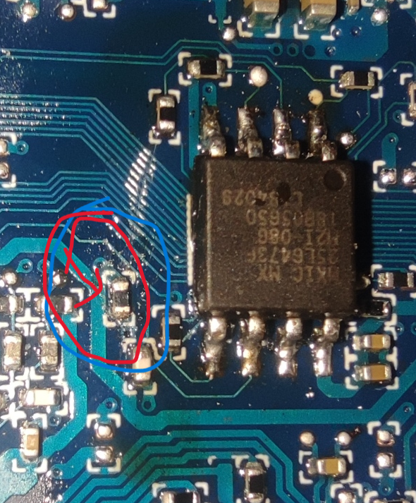

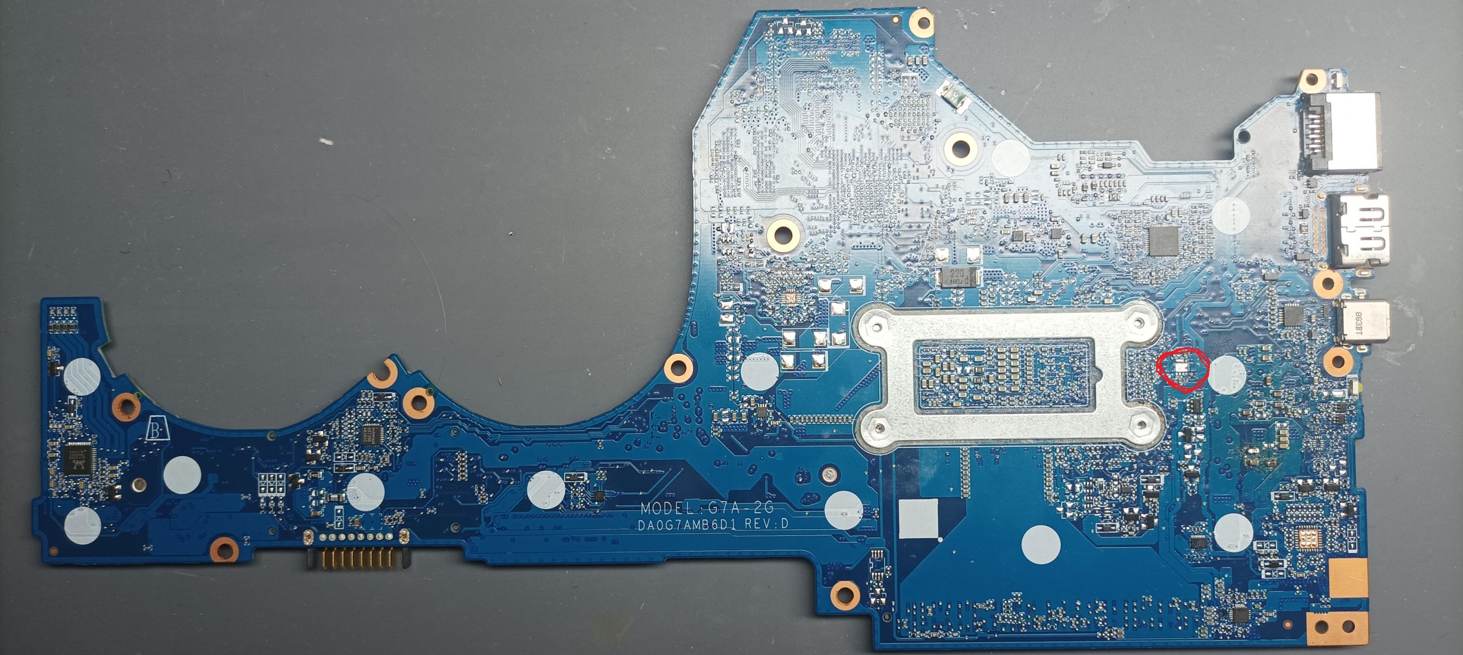

      Re: HP Pavilion 14-ce0035nf G7A-2G DA0G7AMB6D1 REV
      Hello, please help. I have an hp laptop with this motherboard. I bought the notebook as broken, and I will try to fix it. I found that there is a component missing from the board. I marked in the picture. You know what the
      specification. Thanks. Sorry for my english.

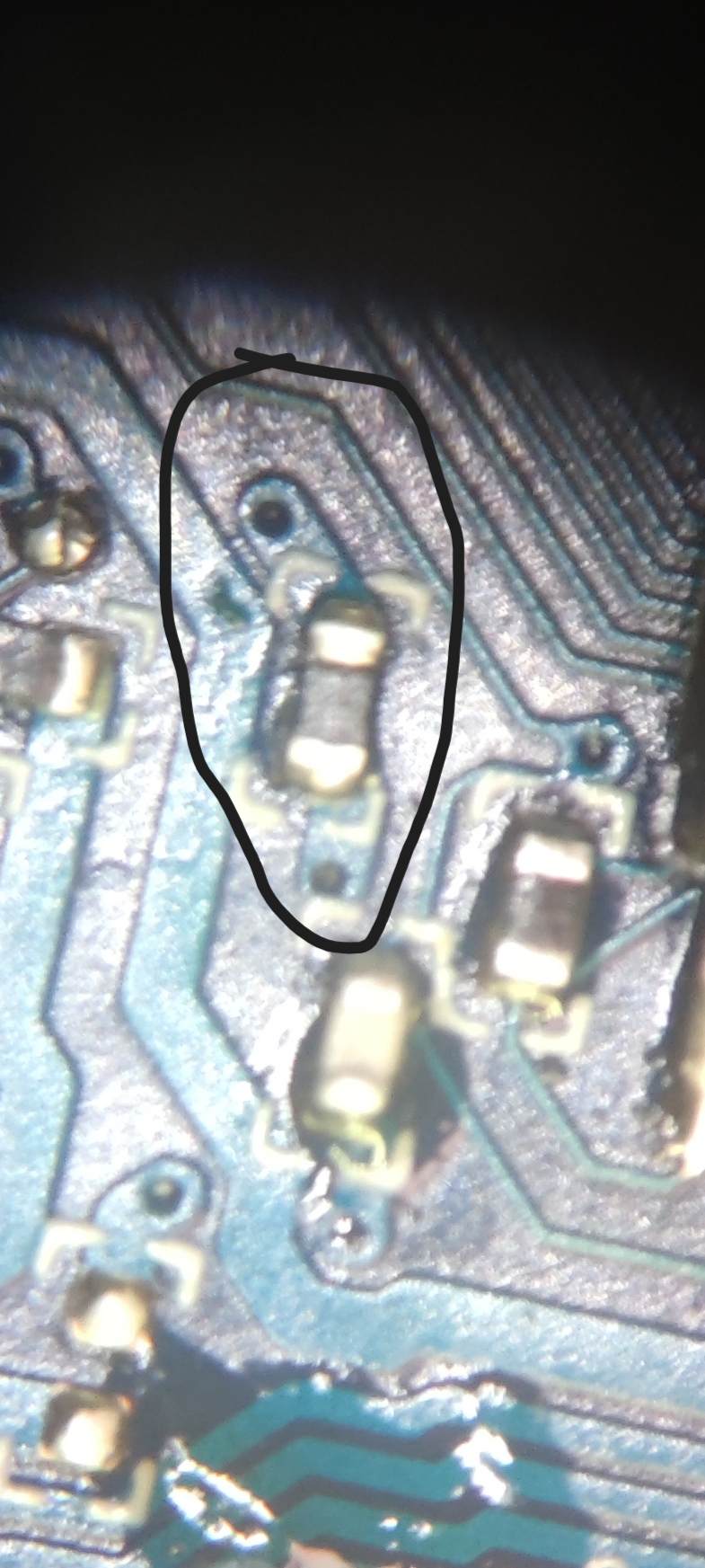

        I need this resistor value. Near bios chip.

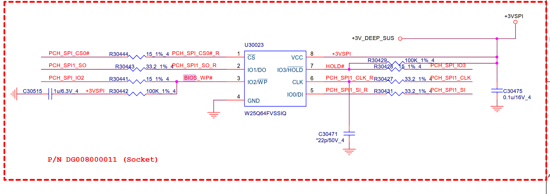

          Click image for larger version  Name:	image.png Views:	3 Size:	106.6 KB ID:	3665273
          pin 6 ?? 33
          on the other hand the tracks above seem to be cut?

          • Lukosiukas
            • Jul 2018
            • 106
            • Lithuania
            No, it actually goes thru vias somewhere...

            • Maxpower3
              Bad Veteran
              • Feb 2018
              • 1356
              • France
              here
              • Lukosiukas
                • Jul 2018
                • 106
                • Lithuania
                it's just a old flux and that mark is from tweezers. Tracks are fine...
