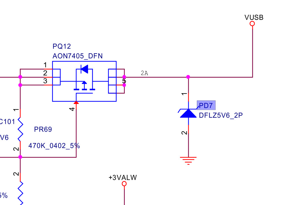

    Looking for a schematic for this machine.
    Board model BYG40 NM-A411
    I have a faulty diode (PD7) and I am trying to figure out what to replace it with.
    Thank you in advance

    Re: Lenovo Yoga 900-13ISK schematic request (BYG40)
    Hi. See attached.
    PD7 = DFLZ5V6 (Diodes Inc.)
    It is a common 5v6 rated volt zener diode. From where do you prefer to source your parts ? There are many replacements to this component in the market.
        I got a motherboard with exactly the same fualt, PD7 is blowen and shorted to the graound!!, when i removed it the short circut was gone but when i connected the power to the motherboard the capacitor next to this diod blowed, Would like to know it there is a supllier for such parts in main England, usully i order from aliexpress but it's a long waiting, i have a lot of motherboards that i can remove parts from theme, but i don't reelly know witch capacitor i need,
        It's basicly a tantalum capacitor, the most capacitors on this circuit are N8 d m, But i can't fint the datasheet for this capacitor or where to buy the capacitor it self,
        Thanks for any help
          Post a picture of the area of the circuit board.
