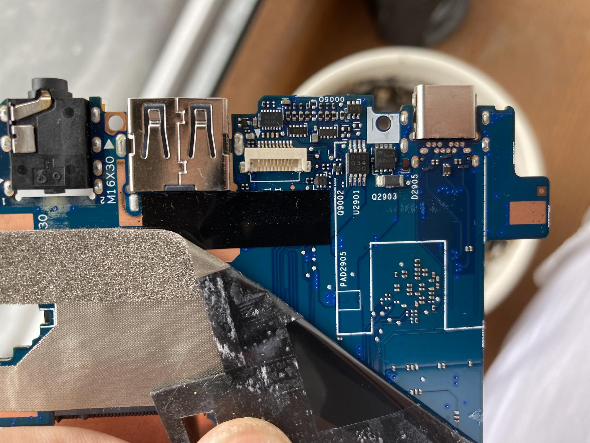

Any chance there's a board that uses similar charging IC? I believe the Pavilion x2 12-b101nf, board: 841771-601 is closely related on the consumer end. I'm also struggling to repair an elite x2 with an issue on the charging IC. I'm able to read 12v on the multimeter at the charging port, so the board is negotiating the voltage, but I'm not seeing any voltage reach the battery. The board will boot with a charged battery, but it will eventually drain down the charged battery.

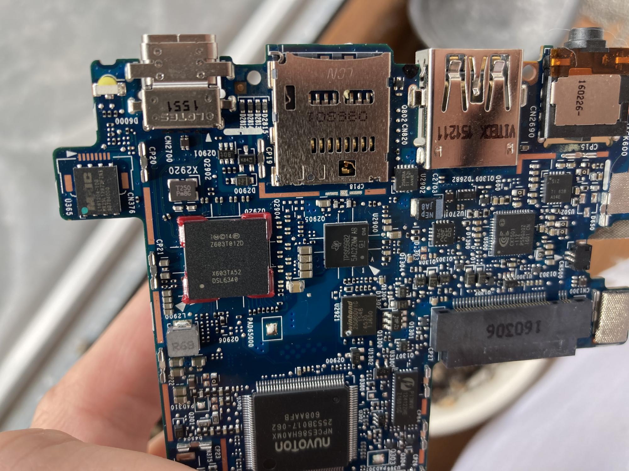

by m1ch43lzmHi, this is my personal laptop, which the original board (lets call it Board A) blew up PU8700 (TPS51486), making a hole on the board, i had left the laptop at my desk one day with the battery fully charged and didn't touch it for a week, but when i tried to turn it on it didn't
Thought the battery was dead, so i plugged in the charger then tried to power on, the power LED blinked once, charged LED still orange, unplugged the charger, plugged in again and I noticed the "magic smoke" smell, so i unplugged the charger, removed the back cover and saw the blown IC (the "magic... -
