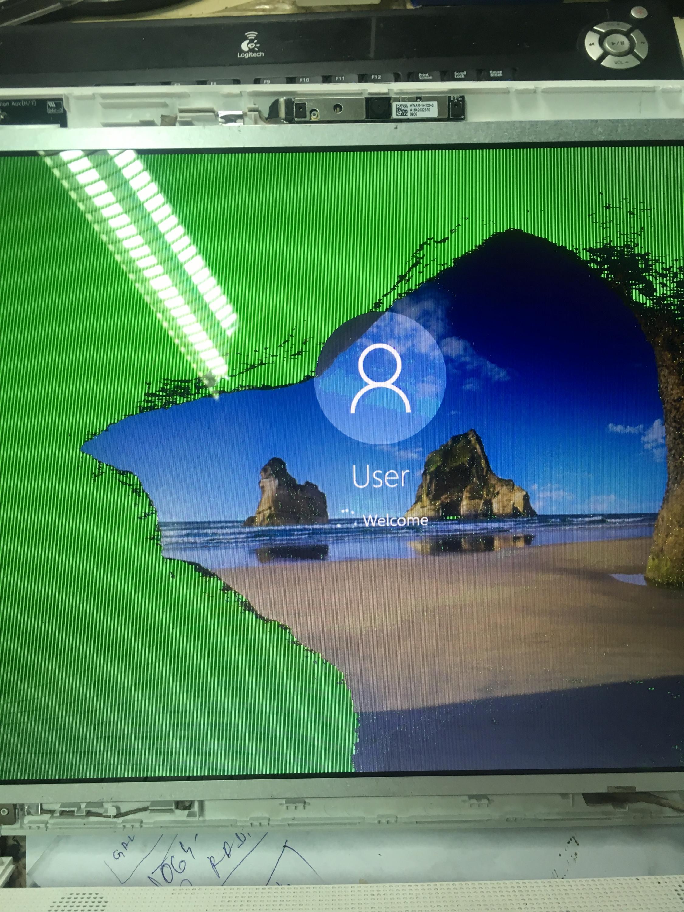

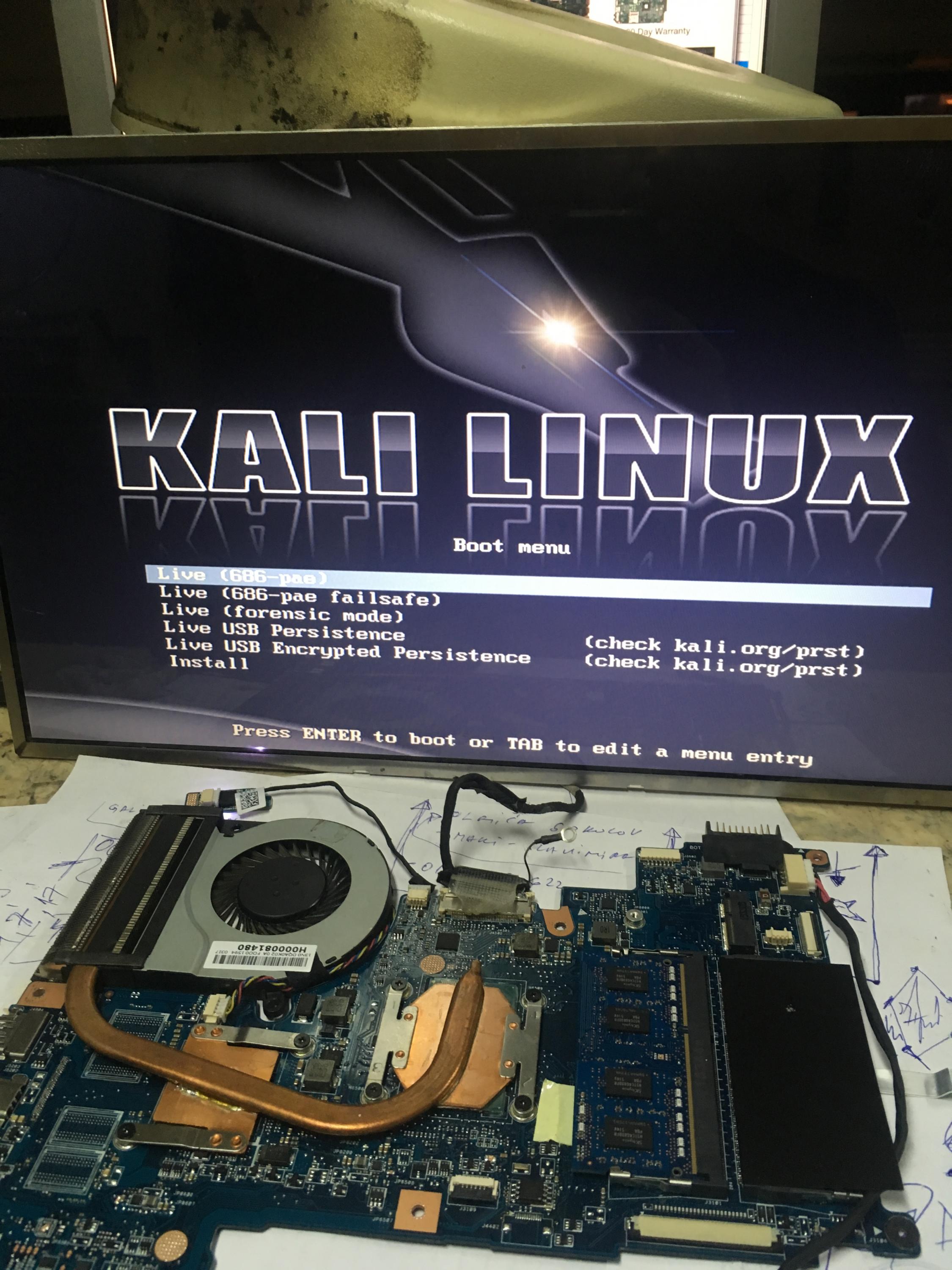

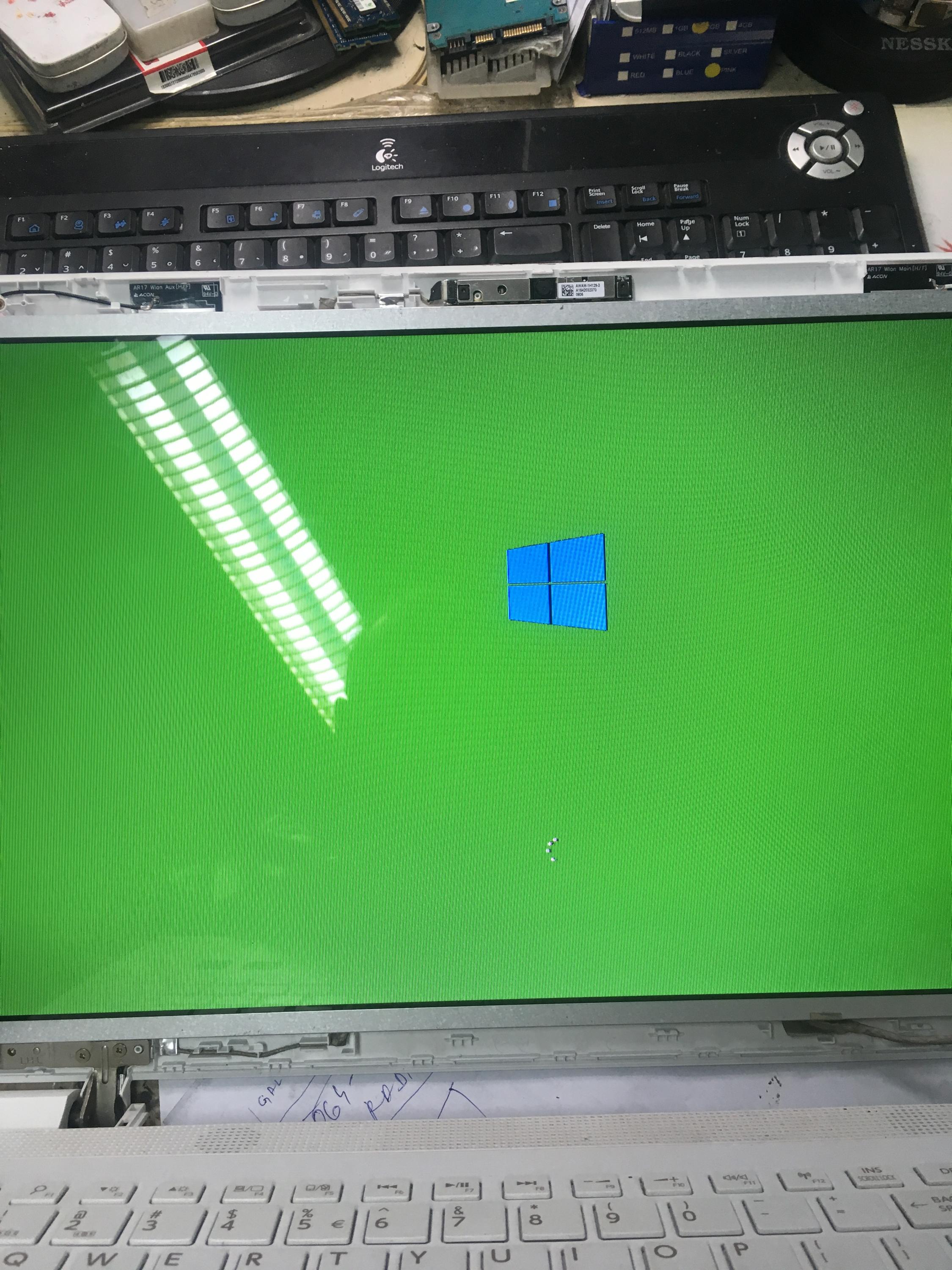

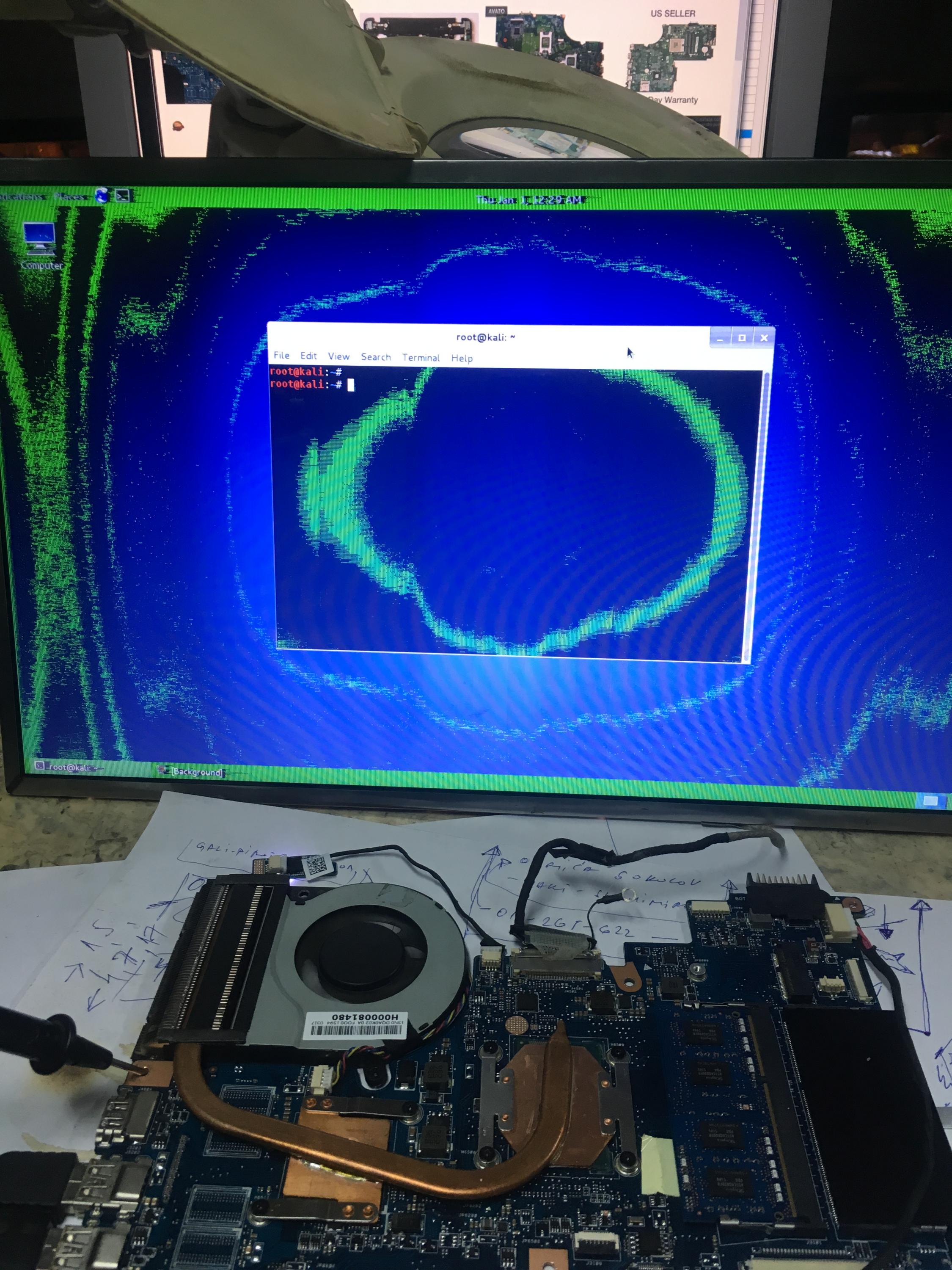

    Help,
    Need a schematic diagram for Toshiba c70-c
    motherboard: AR10sucu r2.1
    The lcd panel is green, (17.3)
    Tested panel 15.6 is OK
    He tried the other 17.3 images of green
    Tried another flet cable, again the same
    Please help!
    thank you

            To me, it seems LVDS cable broken.
              Re: Toshiba C70-C-1G7 AR10SU/CU MB R2.1
              Do you think that LVDS is a wire (wire) interrupted?
              on the motherboard or lcd flet cable?
                Changed rtd2136n (U4502) and still the same ...
                Has anyone ever solved this?
                Looks like it's not ... who's settling this will get the Nobel Prize
                if someone knows I can pay the solution ....
                I'd like to know what's at stake.

                  I have the same issue here with green image on 17.3 screen. Have anyone found the solution ?
                    Kalisko have you tried 17.3 1366x768 screen ?
                    I have 14.1 screens in both 1366x768 and 1600x900 (From Lenovo T430). On 1366x768 screen image is good but when I connect 14.1 1600x900 I got issue with gray lines appearing randomly on the screen (I guess different symptom due to screen differences . I guess the issue is with LVDS data data channel since HD+ screen use dual channel LVDS.
                    It will be much easier if anyone can provide the schematic.
