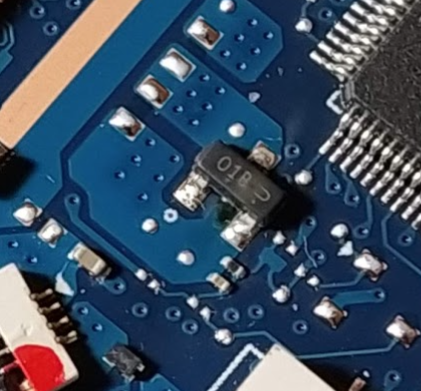

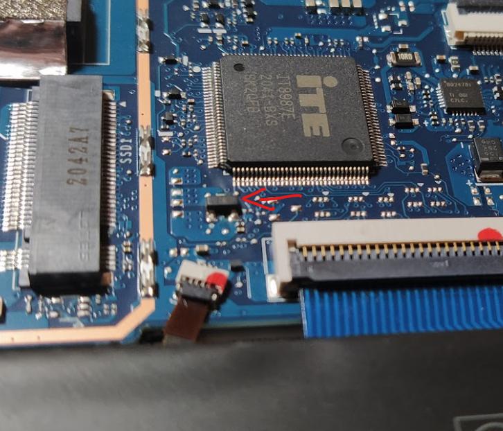

    Hello, i fried a component by touching it with the metal cap and I want to try to replace it.
    I need help to identify it and buy a replacement and if possible the boardview and schematics
    Here's the photo of the component, pci-e nvme hdd is not recognised anymore after the damage (but it works if mounted on an other laptop)
    Thank you

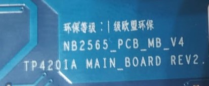

    ASUS TM420 boardview
    I need ASUS VivoBook Flip 14 TP420IA TM420 TM412IA Schematics, please share

      Just for future generations, 01B is a p-mosfet lp2301blt1g

        hmm i think there are other parts that burned (over voltage occured)
          Then it works as a high-side switch, I think.
          Also for future reference: it's compatible to VISHAY# Si2301CDS .
