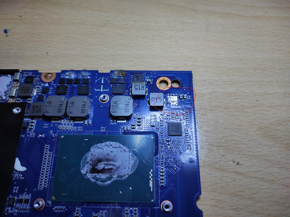

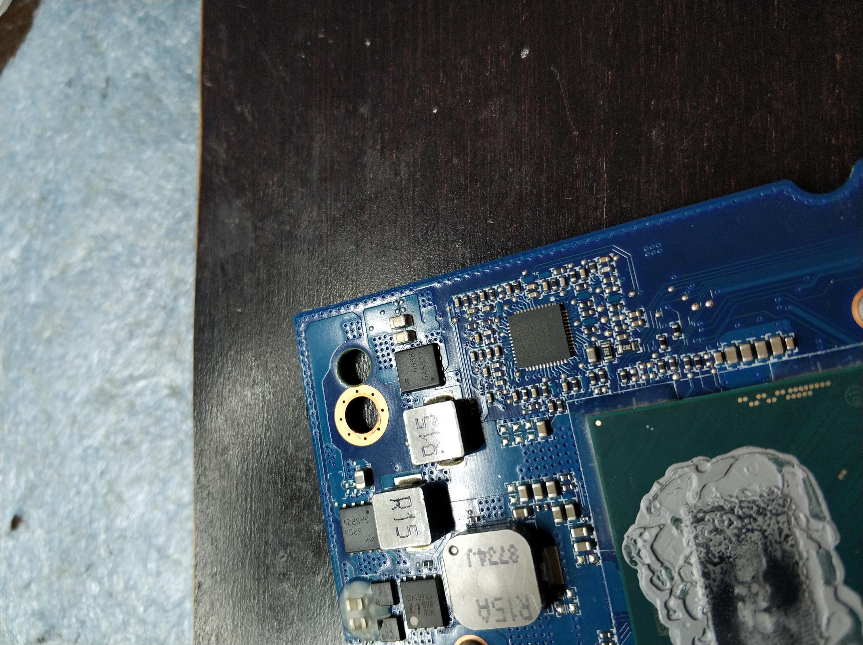

        Hello friends. Im have got a asus fx504gm-en480t with board dabklimbaco rev:c
        I buy it yesterday.The guy said me that dont work. When I open and see the board dont have got two mosfet and chip for charge the battery. Its possible schematics for repair?
        • mon2
          • Dec 2019
          • 14672
          Re: Asus rog fx504gm schematic/boardview
          Unable to find schematics but post clear and zoomed pix of the area that is missing the mosfets / parts.
          Also post clear pix of the charger IC that is missing. That way, can know the # of SMD pads & package on the device.
          Perhaps it will help.
            Its pictures of components.
            DABKLIMBACO REV:C
            I dont know that ic need. Thanks

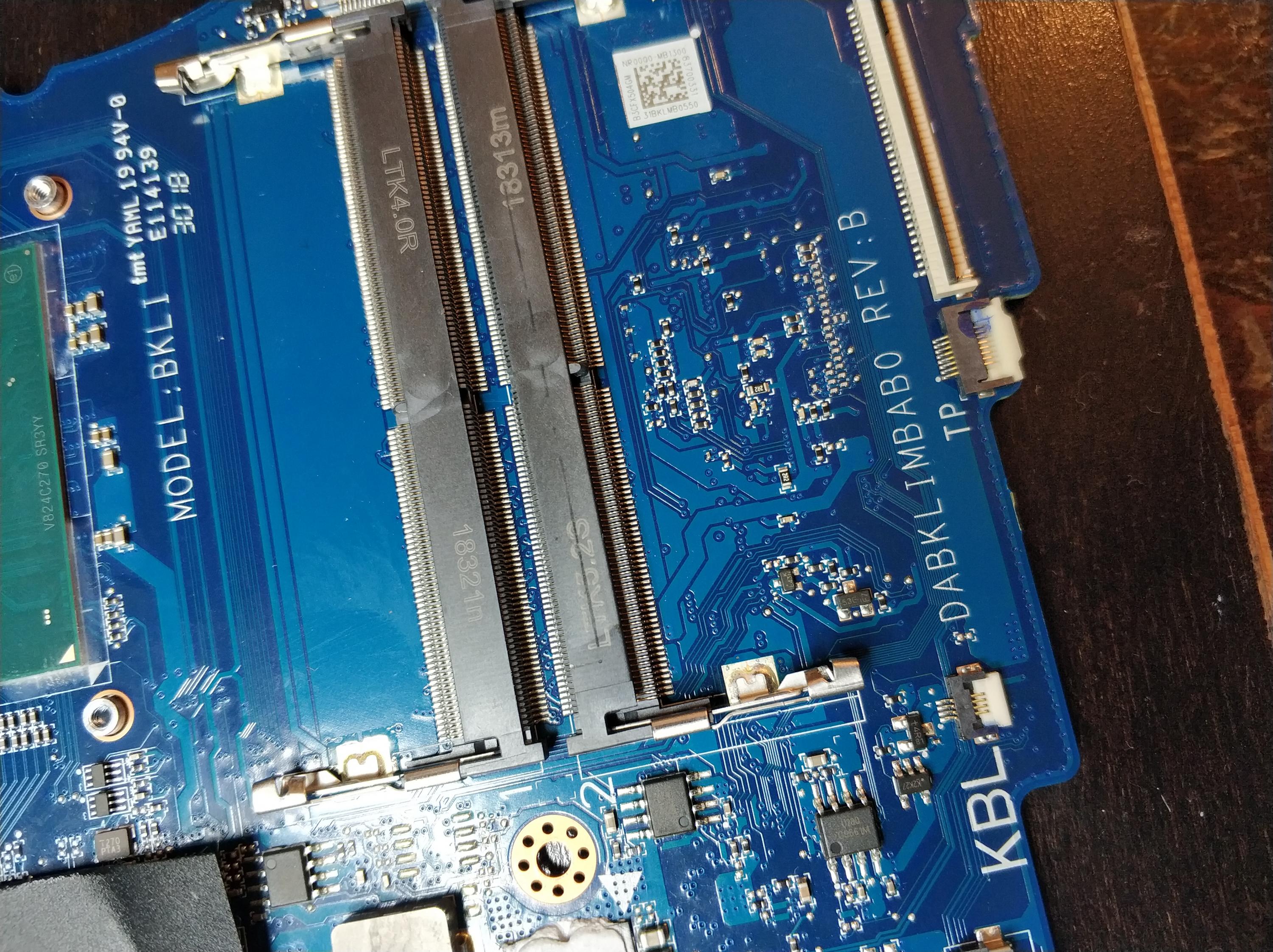

              @codigopin: hi man; if you still need it, here it is; only, be carefull, my mainboard is DABKLIMBABO REV: B, but i think is the same, for the chips you missing.
              Asus FX504GM
              Mosfet near cpu is 6996, dual mosfet.
              Those two near hdd connector are the same, simple mosfet 6414A.
