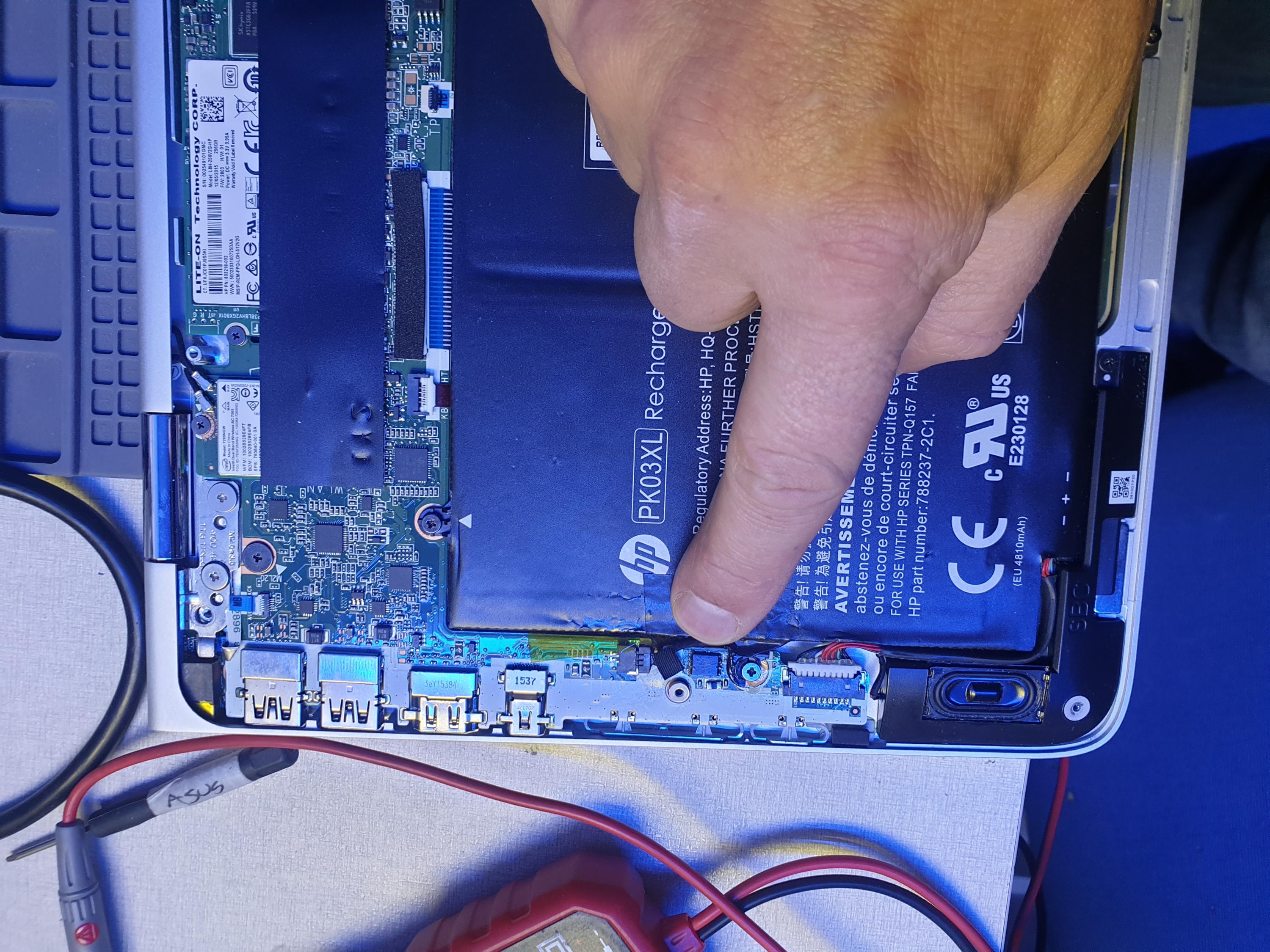

    i have this laptop my shop but another shop replaced a mosfet... (figure of it)
    the mosfet i found soldered on the MB is a 6426 (N channel 30V) but i think this is not the correct one because the laptop after a day of power-off can't charge the battery (is necessary to disconnect and reconnect the battery to have again the charge from power supply) .. yep a strange issue..

    Re: Schematics for HP Spectre x3260 13-4110nl HO Part: 849426-601 (probably DA0Y0DMBA
    https://www.badcaps.net/forum/showth...&highlight=Y0D
      thnak you very much... EMB20P03V
        looking at the board view the component is a mosfet (p channel) .. the EMB20P03V... BUT this is has a form factor of 3x3 mm ... and not the one i have on my board ( 6x5 mm )...
        well .. i can place another P (6x5) .. but now i'm scared about something different on the 2 motherboard.. maybe on the schematics there is a P channel.. and on mine something different... like an N (i found a broken N already soldered from another shop)
