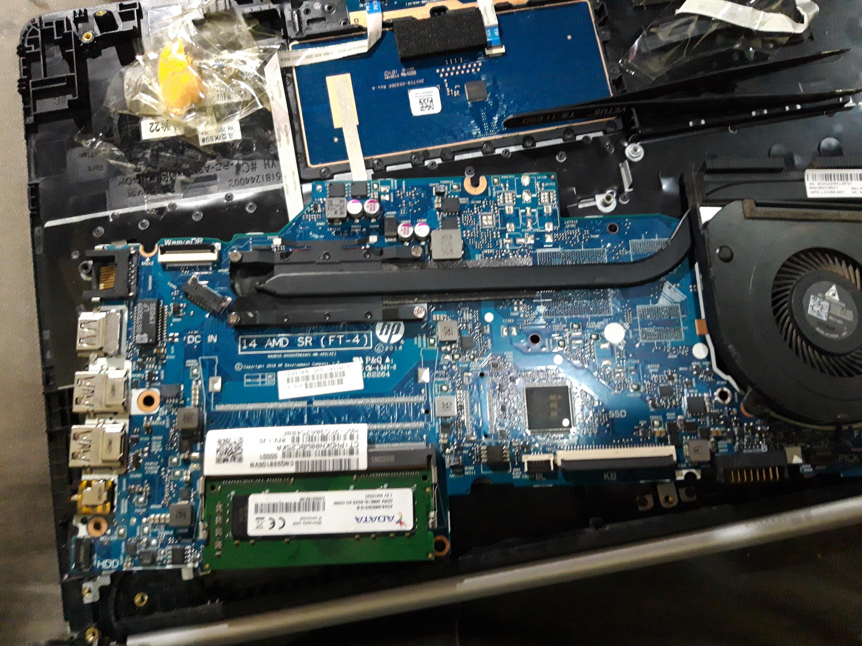

    Hi need schematic or boardview for HAGRID- 6050A2983401-MB-A02

    I think its the Quanta 0P2 https://www.badcaps.net/forum/showthread.php?t=84307

      Re: 14 AMD SR (FT-4) HAGRID- 6050A2983401-MB-A02 Schematic
      Originally posted by SMDFlea
      Thank for replay but it's not same board.
      This its attachment pic:
            I am looking for HP 14 CM HAGRID 6050a2983401 MB A02 (A2) Schematic.. can anyone help me? Thanks in advance

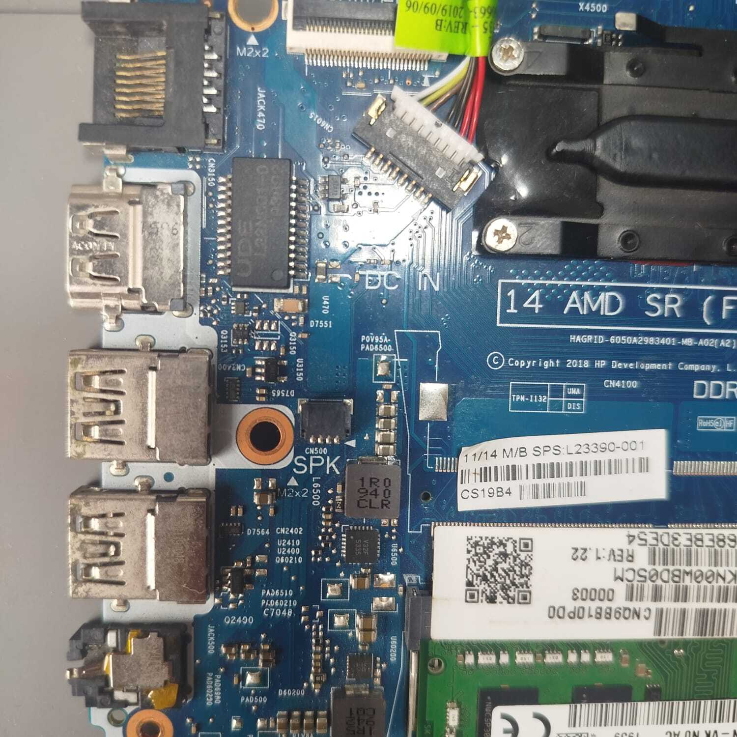

                        Hi, I'm new to repairs, so I hope you can help.
                        I have an HP14 (HAGRID-6050A2983401-MB-A02 (A2) board), which works fine, but two USB connectors (on the side closest to the CPU) don't work. I have 5V but it doesn't read the USB information. I've tried looking for the diagram, but none of the ones I've looked for are for my board (none of the codes shown in the diagram are the ones that appear on my board). Does anyone know what it could be?​

                          Hi ITz_MisaXD! , please post a picture of the back of the board near the USB ports
                          It could be broken filters, or shorted ESD diode
                          Does the USB port on the left, bluetooth and webcam work fine?
                          Couldn't find a better picture, check this area in the back

                          Something like this, from 6050A2983601 board (the Ryzen 2000 version of your laptop), but it's on the back in yours

                          Check continuity across pins 1-4 and 2-3 of the filters (L7552 and L7553), and for shorts to GND on those pins, if shorted D7566 may be the culprit as this component is shared between the 2 usb ports on the right side
