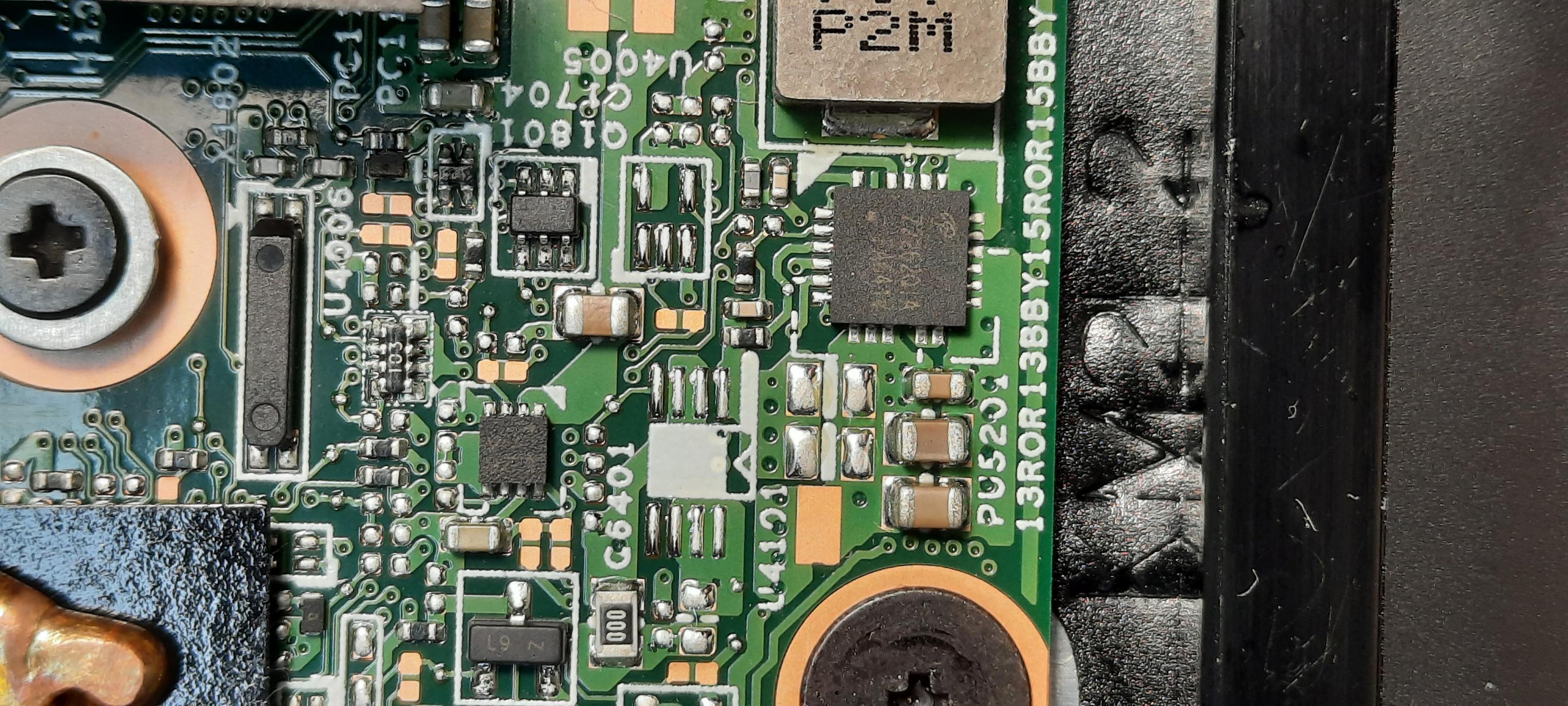

    Hi everyone, please i need Dell Inspiron 15 7569 (Starlord 13_B 15264-1 X41DX$BA) schematic diagram urgently.
    Boardview will also help too.
    The yellow circle in the image attached is where there is a burnt component and it got burnt to the extent i can't identify what was there before. I don't have a clearer image yet.
    Thanks.

    Need a schematic as well, but appears to not be available after some googling.
    Customer broke two resistors off the board at PU4601 which is an NCP81208. The two resistors in question are at pins 31 and 32.
    Anyone happen to have one on hand to measure their values? Need to know what to put back in place.

      Re: Dell Inspiron 15 7569 (Starlord 13_B 15264-1 X41DX$BA) schematic needed urgently
      yes it is but you have to pay for it.

          31 100 om 32 10 om
