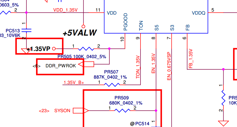

        It's me again, I'm having problems with this board. All always on power rails (+1..0ALW, +1.8ALW, +3VALW, +5ALW, B+) are present when I power this board off bench power supply. With it just plugged in it draws around 30mA. When I press power button, current draw jumps to around 150-170mA for a few seconds, then returns to 30ma. Power LED lights in same pattern(turns on, then off after few seconds). This cycle repeats three times, after that board shuts off.
        When it starts turning on I can measure +3VS and +5VS, from which other rails are generated. Problem is with SUSP(#) signal, because it shows up then turns off, and because of that system power rails turns off and on.
        What controls SUSP and SUSP# signals, and why doesn't it stay on completely? I'm new to board repairs, so I would really appreciate some help with this

              After more measuring I'm missing +1.35V, +1.35VS and +0.675VS, all generated by same IC(PU501 or RT8207MZQW). I've noticed that that there is 0.4V on pin 9 of that IC with label TON when board is just plugged in, but when I turn it on it goes to 0V. That pin is pulled up to B+, which in this case is 19V, via 887K resistor. There is also no output from that IC on pins UGATE and LGATE, which drive two mosfets.
              SYSON behaves just like SUSP, turns on and off
